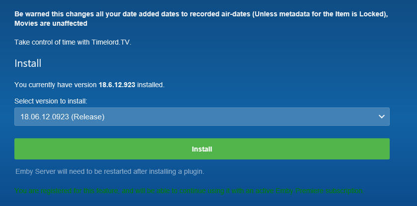

Happy2Play 9814 Posted June 13, 2018 Author Posted June 13, 2018 @@BeppoMonkeyBoy I experienced the same issue with TimeLordTV running on Emby Beta 3.4.1.14 (Synology) that @@Happy2Play reported at the top of the thread. The plugin was just updated to v18.6.12.923. After the update, there is no longer an option to run TimeLordTV in the "Scheduled Tasks" list. The following entry appears in the Emby server log: "Error App: Error creating MediaBrowser.Plugins.TimeLord.ScheduledTasks.TLTVScheduledTask". The following is included in the error description: "SimpleInjector.ActivationException: No registration for type TLTVScheduledTask could be found and an implicit registration could not be made. …" The error still occurs after uninstalling and reinstalling the plugin. I've attached the log. If you go to the plugin catalog and select this plugin, does it say "You are registered for this feature, and will be able to continue using it with an active Emby Premiere subscription."?
DarWun 357 Posted June 13, 2018 Posted June 13, 2018 If you go to the plugin catalog and select this plugin, does it say "You are registered for this feature, and will be able to continue using it with an active Emby Premiere subscription."? @@Happy2Play Yes.

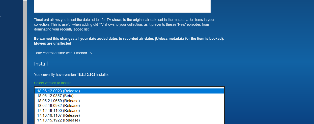

DarWun 357 Posted June 13, 2018 Posted June 13, 2018 (edited) What plugin version was/is installed with this backup. @@Happy2Play When I rolled back to Emby beta 3.4.1.13 this morning I was notified of an update to TimeLordTV at first run. I assumed it was the version that showed up when I got home tonight. I subsequently updated to Emby Beta 3.4.1.14 after reading about other broken plug-in updates having gone live post 3.4.1.14 (i.e. auto-organize and statistics). Unfortunately I deleted the old logs so I can't be entirely sure I had TimeLordTV v18.6.12.923 running under 3.4.1.13. I'll rollback again when I get home later tonight to confirm. Edited June 13, 2018 by DarWun
Happy2Play 9814 Posted June 13, 2018 Author Posted June 13, 2018 (edited) @@Happy2Play When I rolled back to Emby beta 3.4.1.13 this morning I was notified of an update to TimeLordTV at first run. I assumed it was the version that showed up when I got home tonight. I subsequently updated to Emby Beta 3.4.1.14 after reading about other broken plug-in updates that had been updated post 3.4.1.14 (i.e. auto-organize and statistics). Unfortunately I deleted the old logs so I can't be entirely sure I had TimeLordTV v18.6.12.923 running under 3.4.1.13. I'll rollback again when I get home later tonight to confirm. If versioning is done correctly you should not be able to run v18.6.12.923 on 3.4.1.13. I believe you should be running 18.5.21.659 in .13 as that was the version I was running. You can see the versions in the Catalog. Edited June 13, 2018 by Happy2Play
DarWun 357 Posted June 13, 2018 Posted June 13, 2018 (edited) If versioning is done correctly you should not be able to run v18.6.12.923 on 3.4.1.13. I believe you should be running 18.5.21.659 in .13 as that was the version I was running. You can see the versions in the Catalog. @@Happy2Play Rolled back to Emby Beta 3.4.1.13. Available (and installed) version of TimeLordTV plugin still being shown as v18.6.12.923. No item in Scheduled Tasks available for plug-in. Next troubleshooting step will be to nuke the Emby install on my NAS server...would really like to avoid doing that. Edited June 13, 2018 by Happy2Play Removed image do to external ip
Happy2Play 9814 Posted June 13, 2018 Author Posted June 13, 2018 (edited) @@Happy2Play Rolled back to Emby Beta 3.4.1.13. Available (and installed) version of TimeLordTV plugin still being shown as v18.6.12.923. No item in Scheduled Tasks available for plug-in. Next troubleshooting step will be to nuke the Emby install on my NAS server...would really like to avoid doing that. I would reinstall plugin v.0659 for that 13. Only issue will be the update notice for newer version after restart. If this works then we know there is a conflict somewhere in your update process. Edited June 13, 2018 by Happy2Play removed do to ip
DarWun 357 Posted June 13, 2018 Posted June 13, 2018 (edited) I would reinstall plugin v.0659 for that 13. Only issue will be the update notice for newer version after restart. If this works then we know there is a conflict somewhere in your update process. @@Happy2Play Already did that. Plug-in works with v.0659 under Emby Beta13. But the latest update to the plugin is downloaded and installed as soon as the server runs. On the next reboot of the server it goes live, and I haven't been able to figure out a way to stop that from happening short of opting out of the Emby beta program entirely. ***Removed image as it contained externa ip Edited June 13, 2018 by Happy2Play Removed image as it contained externa ip
Happy2Play 9814 Posted June 13, 2018 Author Posted June 13, 2018 (edited) @@DarWun Unfortunately the only way is to kill the Check for plugin updates task. Dashboard-Scheduled Tasks-Click onCheck for plugin updates and delete the triggers. This issues does appear to be OS specific also. Restore default triggers if you decide to delete for now Not exactly sure of custom scheduled task are on your OS, but I know they reside in \Emby-Server\programdata\config\ScheduledTasks on Windows. You can delete these to restore default triggers. Edited June 13, 2018 by Happy2Play
