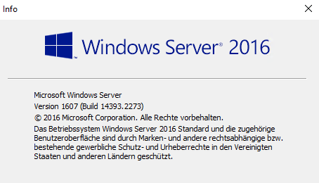

stony79 0 Posted June 6, 2018 Author Posted June 6, 2018 @@stony79 As an initial test - can you install vlc and play a video ok directly on the server - so no emby involvement also this is Server 2016 with the full gui - i.e. not the core version @@PenkethBoy I installed the latest vlc and playback of video is fine, no problem The server 2016 is with gui, it is a Server 2016 Standard
