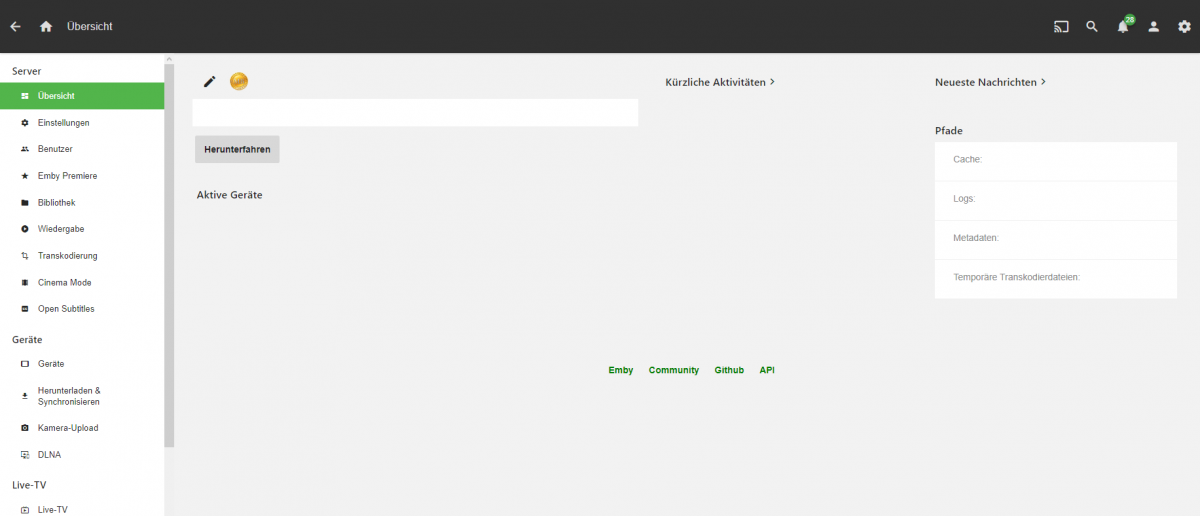

stony79 0 Posted June 6, 2018 Posted June 6, 2018 Hello, everybody, a few weeks ago the update came to 3.4.0.0 and then 3.4.1.0 which crashed my server. Crash is exaggerated, the dashboard and the client hung up. I send a screenshot in the attachment. Thereupon I am back to version 3.3.1.0 and now I finally managed to set up a test server to have a closer look at the problem again. The test server is an Intel Xeon E5-2697 v2 with 12 cores and 64 GB RAM. I have now installed the latest beta version and the problem still exists. You can set everything and use the dashboard, but once a video is played, it hangs up. I have to kill both emby and ffmpeg in the task manager. Maybe someone can help me with the problem. Many thanks embyserver.txt ffmpeg-remux-c81caab4-117d-443a-aafb-d040688c77eb.txt
