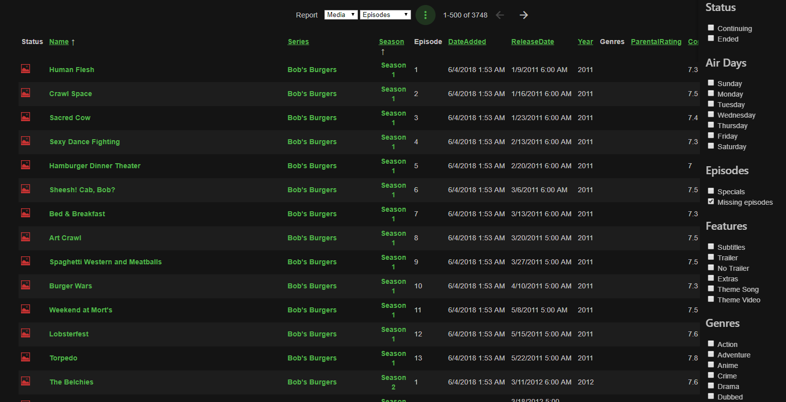

thekingswolf 48 Posted June 4, 2018 Posted June 4, 2018 (edited) lost one of my drives recently and am recovering from the data loss. Am trying to fill the gaps in some random episodes that I lost, and thanks to some suggestions on the forum I found the Reports plug in. When I choose the Media>Episodes report and apply the Missing Episodes filter, the report I get is in no way complete. Mostly it just shows episodes for shows I have in my library that haven't aired yet. It does include a very small number of actual missing episodes, but there are a lot missing that I know for a fact aren't there, that are not in the report. Suggestions? Edited June 4, 2018 by thekingswolf
ebr 16310 Posted June 4, 2018 Posted June 4, 2018 What happens if you refresh one of the series with missing episodes that are missing from the report?
thekingswolf 48 Posted June 4, 2018 Author Posted June 4, 2018 (edited) refreshing metadata seems to have worked, but now the report is showing episodes missing, that aren't missing. I can even click on the episode in the report, and it takes me right to it and I can play it. I refreshed one of the shows where this is happening and it still does it. Refresh Metadata is the only refresh i see, is that what you meant? Edited June 4, 2018 by thekingswolf
ebr 16310 Posted June 4, 2018 Posted June 4, 2018 Yes, that is the refresh I meant. If those series were added before you had turned on the missing episode option, then they will not have any missing episode information and will need to be refreshed to obtain it. As for your other issue, we'd need to see specifics. Thanks.
thekingswolf 48 Posted June 4, 2018 Author Posted June 4, 2018 Shutdown Server then restared server for clean log file. Went to dashboard and ran report for missing episodes. Log file - https://paste.ubuntu.com/p/KPTKyx2J6P/ Example Screen shot. These episodes are all there, and will play successfully if I click them on this screen. I have refreshed metadata for Bob's Burgers.

thekingswolf 48 Posted June 4, 2018 Author Posted June 4, 2018 ok cool thanks a lot. the report is better now, it does show more of the files that are actually missing, but like i said there are a whole bunch in here that aren't missing. It's a long report, and the fact that some of these aren't missing makes me question the validity of the entire report, like maybe there are still some that are missing that aren't listed. i'll poke around the source code, thanks for the link. Data lass sucks lol. had a 4tb crap out on me

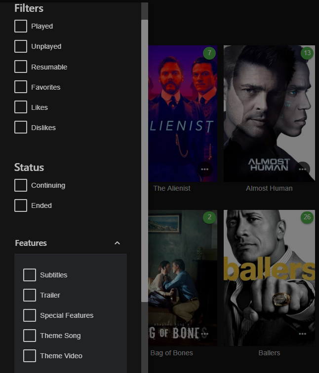

Happy2Play 9802 Posted June 4, 2018 Posted June 4, 2018 (edited) Do you see the same if you went to a library TV-Episodes and filtered by missing episodes? The defect in the plugin as mentioned it Missing episode filter lists all unaired episode that the database has already acquired information for. TV-episodes has 2 filters one for missing and one for unaired Edited June 4, 2018 by Happy2Play
thekingswolf 48 Posted June 4, 2018 Author Posted June 4, 2018 Do you see the same if you went to a library TV-Episodes and filtered by missing episodes? The defect in the plugin as mentioned it Missing episode filter lists all unaired episode that the database has already acquired information for. TV-episodes has 2 filters one for missing and one for unaired I don't have any of the capabilities you mention. If i go into TV shows in my library, "missing episodes" is not a filter that is available to me. Also, you say TV-episodes has 2 filters but mine does not. You can see in my screen shot above that I only have filters for missing and specials. Unaired is nowhere in the list of filters for me. What I see in library:
Happy2Play 9802 Posted June 4, 2018 Posted June 4, 2018 I don't have any of the capabilities you mention. If i go into TV shows in my library, "missing episodes" is not a filter that is available to me. Also, you say TV-episodes has 2 filters but mine does not. You can see in my screen shot above that I only have filters for missing and specials. Unaired is nowhere in the list of filters for me. What I see in library: You have to click the Episode tab not Shows tab. .
thekingswolf 48 Posted June 5, 2018 Author Posted June 5, 2018 ah sweet ty. yes this is the same as the report. You can see here is says season 1 episode 1 is missing, but directly beneath that it shows the same episode. it plays fine when I click it. I should also note that i just reformatted my machine and this is a fresh install of Emby
Happy2Play 9802 Posted June 5, 2018 Posted June 5, 2018 To that sound like miss matched or incomplete metadata. When I see doubles similar to this in Upcoming it requires a library scan or a metadata Refresh. Have you compared what appears on the one showing missing to the one that doesn't?
thekingswolf 48 Posted June 5, 2018 Author Posted June 5, 2018 (edited) I re-scanned my entire library as well as refreshing metadata on the whole library and nothing changes. I'm not sure what you mean by comparing what appears. The one that doesn't show missing has all normal data, filepathm codec, all the normal stuff. The one that is missing only shows what you see in the screen shot. I feel like this isn't a duplicate issue. It's not something that is showing up twice, it's something being misreported as missing right? Edited June 5, 2018 by thekingswolf
Happy2Play 9802 Posted June 5, 2018 Posted June 5, 2018 Do they have the same External ids in their metadata. There has to be something different between the 2 entries to prevent the virtual (missing) episode from joining with the physical episode. You will more then likely have to post a server log for this issue.
