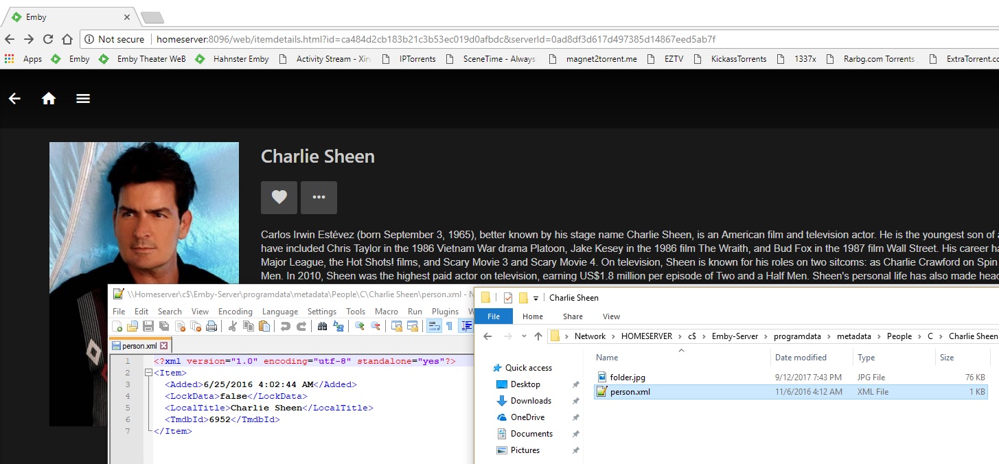

Happy2Play 9802 Posted May 29, 2018 Posted May 29, 2018 I wish person.xml files were still written as this would prevent additional hammering of providers. They are currently ignored if they exist as people metadata is database only these days. 1
Luke 42212 Posted May 29, 2018 Posted May 29, 2018 I wish person.xml files were still written as this would prevent additional hammering of providers. They are currently ignored if they exist as people metadata is database only these days. With the xml plugin they are written, and read.
Happy2Play 9802 Posted May 29, 2018 Posted May 29, 2018 (edited) Sorry people have only gone to DB for quite awhile now, even with existing people.xml files and xml plugin. Edited May 29, 2018 by Happy2Play
Luke 42212 Posted May 29, 2018 Posted May 29, 2018 I definitely added this back for someone, however it could just be a plugin compatibility issue. I have just not been able to allocate much time towards that plugin at this point. 1
Luke 42212 Posted May 29, 2018 Posted May 29, 2018 Sorry, my mistake, you are right. I guess I am remembering wrong: https://github.com/MediaBrowser/XmlMetadata/blob/master/XmlMetadata/Savers/PersonXmlSaver.cs It is all commented out and thus disabled. 1

christian.asd 2 Posted June 15, 2018 Author Posted June 15, 2018 Yes. Thanks! So I tested beta 3.4.1.15 on a fresh install, but unfortunately the behavior is exactly the same as for the stable release -> I don't see any requests to external servers in the debug log when I click on a person inside a tv-show. All metadata providers are turned on, TMDB is on top. The only thing i see in the log is this: 2018-06-15 08:50:20.436 Debug App: Running MovieDbPersonProvider for /var/lib/emby/metadata/People/A/<person> 2018-06-15 08:50:20.436 Debug App: MovieDbPersonProvider returned no metadata for /var/lib/emby/metadata/People/A/<person> So the server is searching for metadata within "/var/lib/emby/metadata/People/". But if I remember correctly I read in another thread that metadata (nfo files) within "/var/lib/emby/metadata/People" are deprecated?! Or at least Emby is not writing people nfo files anymore..
Luke 42212 Posted June 15, 2018 Posted June 15, 2018 Try refreshing the movie or series that the actor belongs to, then go back and click on the actor again. The person needs to have a Tmdb Id in order for us to get metadata. This Id is fetched when the metadata of the media is fetched.
