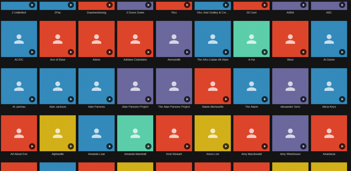

RRo100 10 Posted June 3, 2018 Author Posted June 3, 2018 (edited) Even if you think that I'm wrong here. I reinstalled Emy and created a new library. There is no image shown in over 300 artists Edited June 3, 2018 by RRo100
