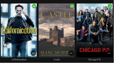

Koml 0 Posted May 22, 2018 Posted May 22, 2018 Hello Running currently emby 3.3.1.0 but want to upgrade but when i run apt-get upgrade emby-server it tells me that ialready have the newest version. Anyone have an ide of where i could start to fix this problem? Also have an series that shows 173 episodes on the image of the series ( see attatchment) but when i click on the series it onsly shows the seson 1, and there should be 8 sesons. Have attached some pictures that shows what im describing. Thanks for all help i can get

Luke 42246 Posted May 25, 2018 Posted May 25, 2018 Can you show us the folder structure for that series?
Luke 42246 Posted May 27, 2018 Posted May 27, 2018 What if you rename the season 1 folder to just "Season 1" and then run a scan?
Koml 0 Posted May 28, 2018 Author Posted May 28, 2018 After i renamed the sesons it went from 173 available episodes to 58. But i still only can see the first seson
