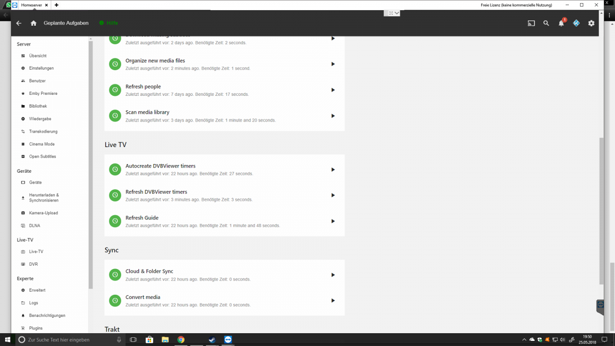

Kodi_Newcomer 27 Posted May 22, 2018 Posted May 22, 2018 Hello Com, hello Team Emby, i have a problem. There are 3 Task from a plugin, that would not be start after the server wakes up from standby. There is a Task Timer in it, every 24h hours and then i create a second one, with 10 am. but when the server wakes up at for example 8pm the task would not be start. log.txt Can you see why not ? I think it should be run every task how was missed after a wakeup ?
Luke 42213 Posted May 22, 2018 Posted May 22, 2018 If you set it to only run at 10am, then it will only run at 10am. The server needs to be awake at that time. I would instead recommend using the interval based timer of every 24 hours.

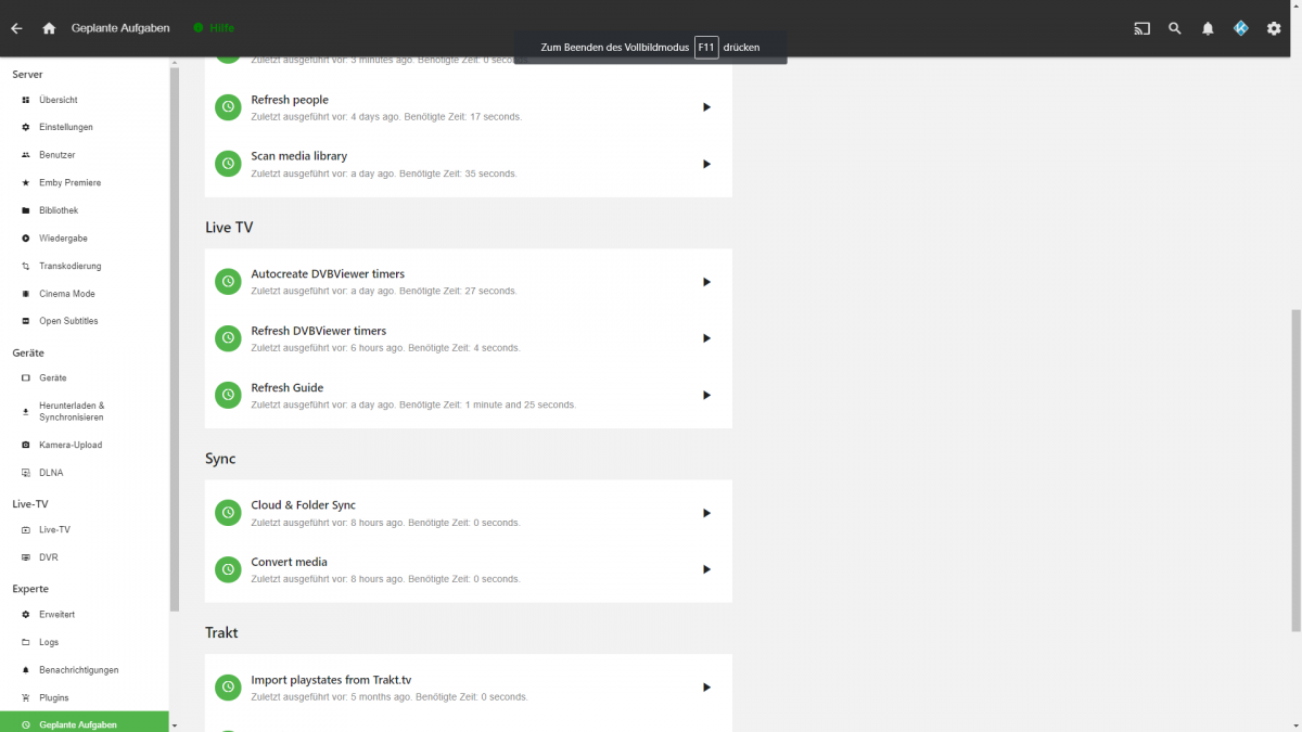

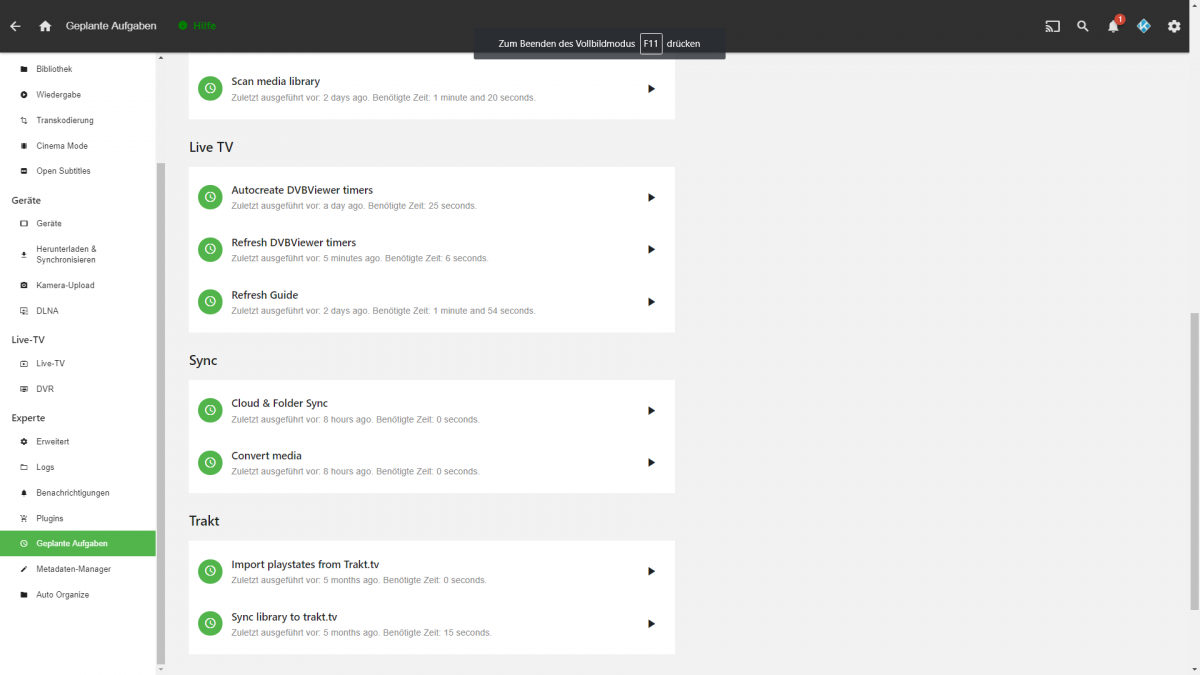

Kodi_Newcomer 27 Posted May 24, 2018 Author Posted May 24, 2018 (edited) So the task's will not run after standby from livetv. Guide Refresh 2 days ago, Autocreate 1 day ago. Edited May 24, 2018 by Kodi_Newcomer
Kodi_Newcomer 27 Posted May 25, 2018 Author Posted May 25, 2018 Server log? Log is incoming again. 2 of 3 task are not start after wakeup. The third one did every day. There it works. I have wake the server up at 19:40 pm some minutes + or -. log.txt

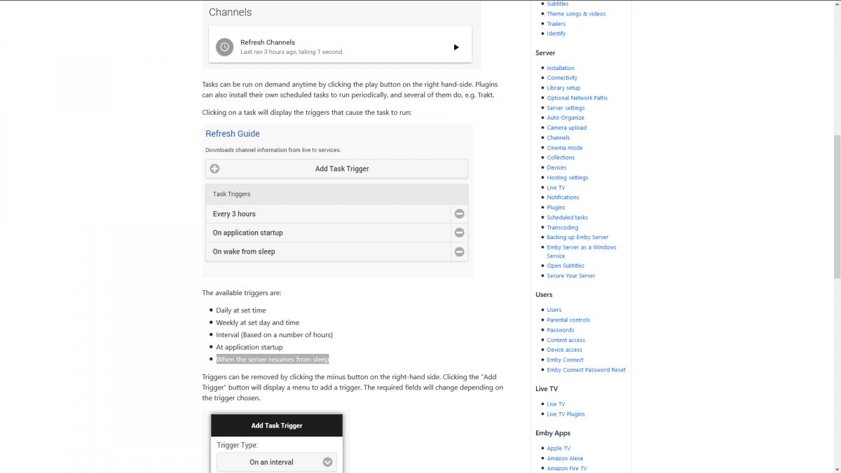

Kodi_Newcomer 27 Posted July 17, 2018 Author Posted July 17, 2018 Please try this again with the next release, thanks. Hello Luke, i have updated to 3.5.0 but i cant see more task options. When i click in help, i can see the option resume from sleep. But for me there is no option like this. (Win 10 64bit) This is what i see on the wiki page. But this option i cant set for my task timers
Luke 42213 Posted July 17, 2018 Posted July 17, 2018 Sorry, that trigger is not available for configuration because it isn't' supported on all platforms.
