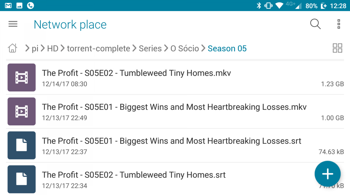

Luke 42244 Posted May 23, 2018 Posted May 23, 2018 Then perhaps your subtitles are not named correctly. Can we see a screenshot of the movie folder on your file system for this movie? Thanks.
Nickneo 0 Posted May 23, 2018 Author Posted May 23, 2018 (edited) Sure, here goes the screenshot. Just saying, testing on VLC and Plex, everything goes fine. Edited May 23, 2018 by Nickneo
Luke 42244 Posted May 23, 2018 Posted May 23, 2018 That should be fine for episode 1. Try running a library scan.
Nickneo 0 Posted May 23, 2018 Author Posted May 23, 2018 (edited) Ok, tried to run the library scan, and looked at logs, saw the ffmpeg missing. As I don't want to transcode anything (I prefer a message error), thought I could just not bother. Just in case, i have installed and properly configured ffmpeg and I'm rerunning a library scan. edit: after ffmpeg and antother scan they appeared just fine in emby mobile for android. thank you very much! any way to get subs without transcoding via DLNA? Waiting for tizen app launch in Brazil. Edited May 23, 2018 by Nickneo
