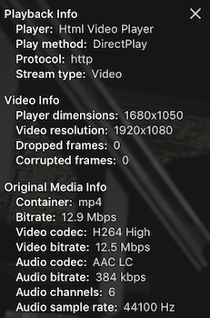

K22R8CT 25 Posted May 21, 2018 Posted May 21, 2018 I created a Sync job with settings: Universal Mobile / 4Mbps. The resulting hour-long file was almost 6GB which seemed off. I checked "stats for nerds" and its video bitrate is 12.9Mbps. As a test, I changed the job to use Custom Quality and specified 4Mbps, deleted the file and re-ran the job – same result, same file size and bitrate. Next I tried the 1.5Mbps quality preset – still the same result, same 6GB file size and 12.9 Mbps bitrate. What's going on? Here are the stats for the source file, in case it's relevant:

Luke 43454 Posted May 22, 2018 Posted May 22, 2018 Your conversion log is at 5 mbps, which yes, is higher than the requested 4 mbps although we do not have sufficient logging to prove that you actually selected 4 mbps. In any event I'll do some testing on the conversion processes to make sure they are honoring the requested bitrates. As far as stats for nerds go, I think it's just showing the original media info of the original file. Thanks.

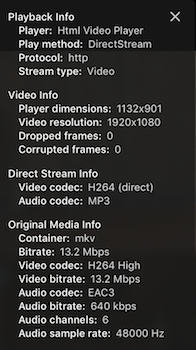

K22R8CT 25 Posted May 22, 2018 Author Posted May 22, 2018 Huh, I don't understand it but the sync file generated from the run I sent you was 2GB, which is about right for a one hour 4Mbps file: 2000 MB * 8 / (60min * 60sec) = 4.4Mbps Weird because all of my earlier tests generated a 6GB file. I also confirmed as you suspected that regardless of which file is played "stats for nerds" shows the bit rate of the original file.

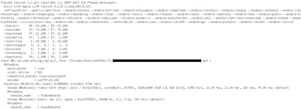

K22R8CT 25 Posted June 5, 2018 Author Posted June 5, 2018 Following up on this – I'm still seeing occasionally inconsistent bitrates. Sync job settings for the attached run were: Universal Mobile / 4Mbps Resulting video stream, according to ffprobe: 6355 kb/s Note: I wasn't sure whether the sync job was transcode* or ffmpeg-remux* so I've attached both. transcode-443b3965-957e-42d0-9352-38f882c05852.txt ffmpeg-remux-3aad9850-3679-4366-8a67-ca261e7b03d2.txt

Luke 43454 Posted June 7, 2018 Posted June 7, 2018 But that's not really your issue. The server did a stream copy of the video which is over 6 mbps, so it's the server that chose to do that.
Solution K22R8CT 25 Posted July 17, 2018 Author Solution Posted July 17, 2018 It looks like this problem is fixed in 3.5.0.0. Just upgraded so I can't say for sure but so far so good. Thanks!
