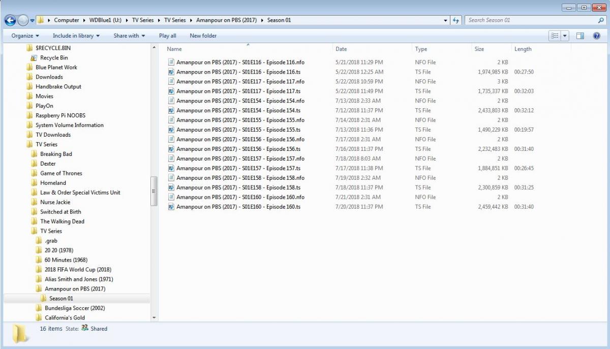

Sammy 791 Posted July 19, 2018 Author Posted July 19, 2018 Additionally, have you compared the folder structure of that series folder to our supported naming conventions for tv series? Here's a couple screen grabs of my Folder Structure:

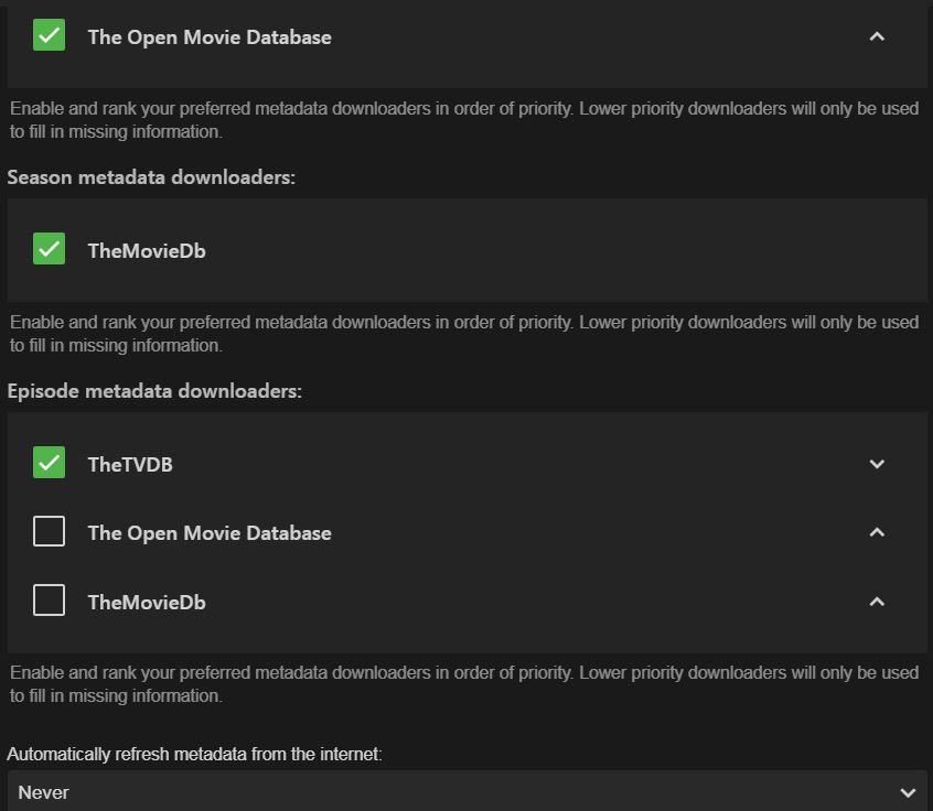

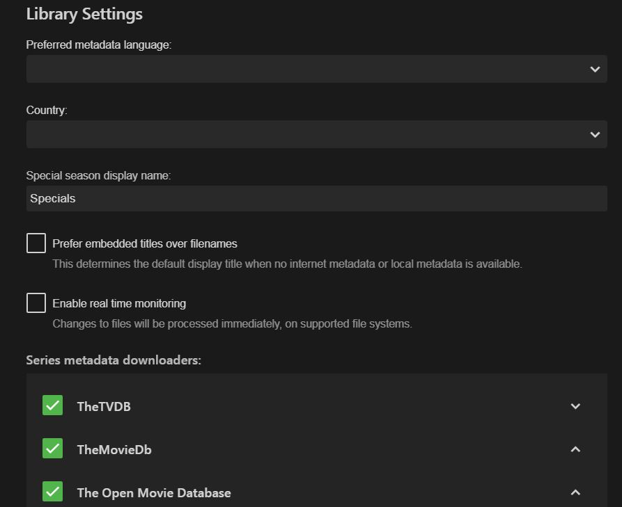

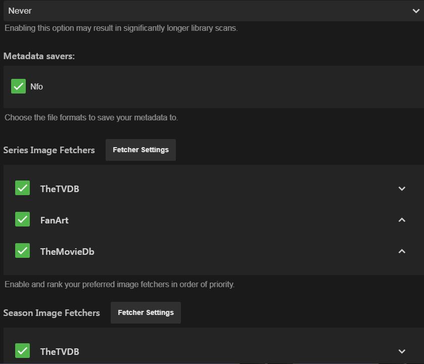

Sammy 791 Posted July 19, 2018 Author Posted July 19, 2018 Is there any metadata in your TV Series folder? How is the library setup? What is the content type for that library? My metadata is as follows:
Sammy 791 Posted July 19, 2018 Author Posted July 19, 2018 I just saw this in the github server change log: Linux & Mac: Ensure all folders beginning with a dot are ignored So this isn't in the Windows Server yet. Is this why Emby will continue to look at the .grab folder within TV Series and create this erroneous Ip Man Series with Plex Recordings? Come on Comskip in Emby!!!
Luke 42212 Posted July 19, 2018 Posted July 19, 2018 Here's a couple screen grabs of my Folder Structure: Library Structure 1.JPG Library Structure 2.JPG This doesn't really show the content inside the series folder that is having the problem.
Sammy 791 Posted July 19, 2018 Author Posted July 19, 2018 This doesn't really show the content inside the series folder that is having the problem. I think that second screen grab is the wrong one but here's the naming convention: Mexico One Plate at a Time With Rick Bayless (2000)\Season 10\Mexico One Plate at a Time With Rick Bayless (2000) - S10E10 - Market Inspirations Local Genius.ts
Sammy 791 Posted July 19, 2018 Author Posted July 19, 2018 Here's another: TV Series\Saturday Night Live\Season 43\Saturday Night Live (1975) - 2018-05-12 22 02 00 - Reese Witherspoon; Florence the Machine.ts

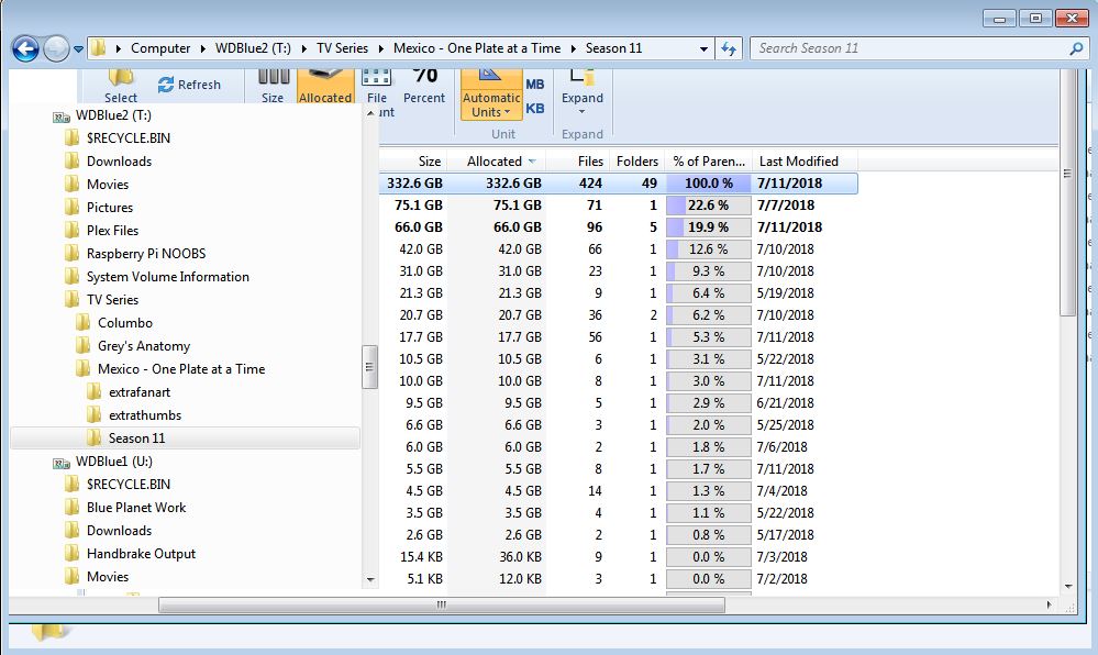

Sammy 791 Posted July 24, 2018 Author Posted July 24, 2018 @@Happy2Play Here are more screen grabs. There's no metadata here unless it is in the nfo file. Plex, like Emby, stores the metadata in a dedicated folder. This library is set up in Emby Server > Libraries as a TV Series Library. This grab also shows the folder structure inside the folder itself. AFAIK, this is the correct convention.
Sammy 791 Posted July 24, 2018 Author Posted July 24, 2018 (edited) BTW, this is set up as a TV Show Content type. Edited July 24, 2018 by Sammy
Happy2Play 9802 Posted July 24, 2018 Posted July 24, 2018 @@Sammy You have 6 TV Series library folders that you would need to check for metadata. Do these 6 TV Series libraries only have series folders in them?
