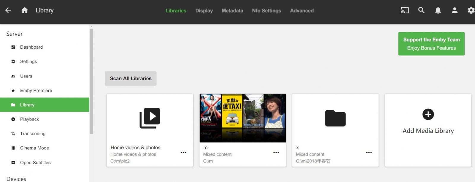

Luke 42210 Posted May 18, 2018 Posted May 18, 2018 can you please show a screenshot of your emby library setup so that i can see all the libraries? thanks.

cnah66 0 Posted May 18, 2018 Author Posted May 18, 2018 (edited) can you please show a screenshot of your emby library setup so that i can see all the libraries? thanks. Thank you. in c:\m\pic2 are all .jpg files im c:\m\2018春节 are both .jpg and .png files Edited May 18, 2018 by cnah66

Solution Happy2Play 9802 Posted May 18, 2018 Solution Posted May 18, 2018 My guess would be there is a issue since you already have a library pointing to a higher level folder "C:\m". 1

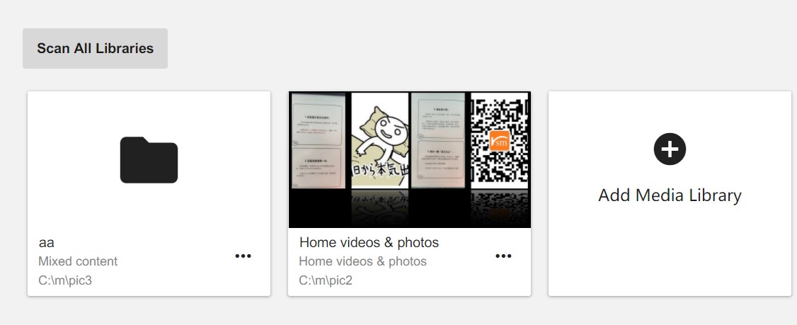

cnah66 0 Posted May 19, 2018 Author Posted May 19, 2018 My guess would be there is a issue since you already have a library pointing to a higher level folder "C:\m". Thank you. you're right. I just remove c:\m\ , then c:\m\pic2 can show, but c:\m\pic3 can't show. I don't know why.
Happy2Play 9802 Posted May 19, 2018 Posted May 19, 2018 (edited) Possibly content type. Dynamic library images usually take at least two library scans to be created also. Edited May 19, 2018 by Happy2Play 1
cnah66 0 Posted May 19, 2018 Author Posted May 19, 2018 Thank you for all kindness friends. I know why. photos should select "Home videos & photos" not "Mixed content".
