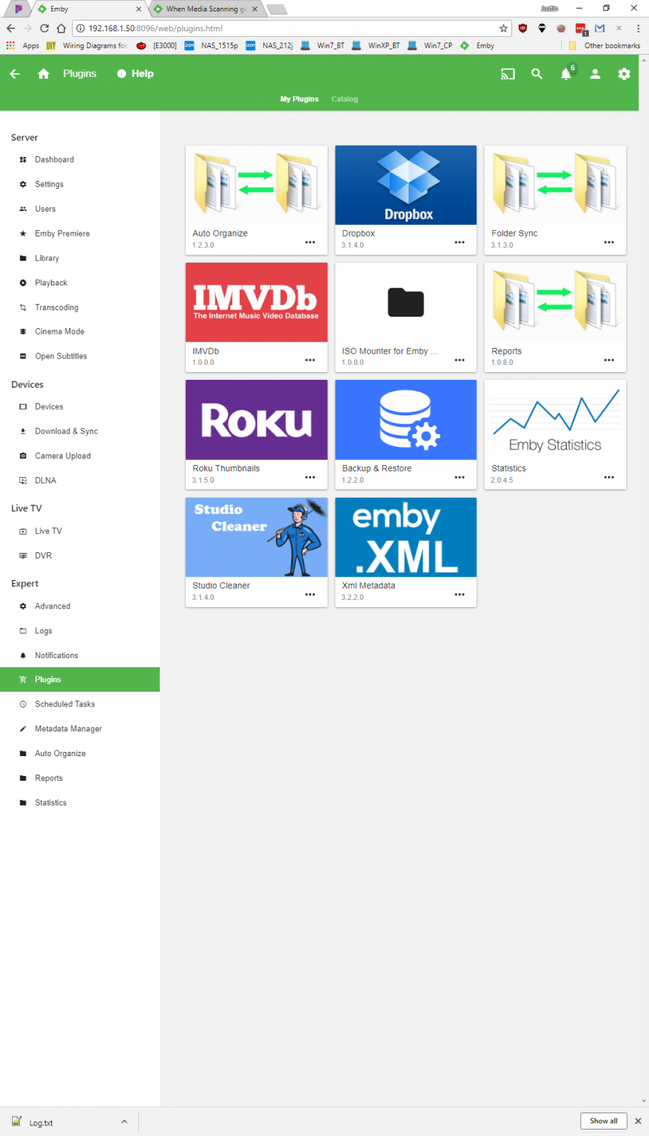

jbscout 1 Posted May 17, 2018 Posted May 17, 2018 I noticed that my log file is getting filled with the same repeating error. I see it for bif, jpg, avi Media scanning always seems to slow to a crawl at about 76% and then eventually finishes. So, it isn't a critical error. I am not sure what GameResovler is as I don't have any game plug-ins or game-media. In fact it seems to be occurring in a pure TV library. Any clue how to resolve it? Thanks 2018-05-16 09:39:29.424 Error App: Error in GameResolver resolving /volume1/NAS_Videos/Videos/Battlefield Britain/banner.jpg *** Error Report *** Version: 3.4.1.0 Command line: /var/packages/EmbyServer/target/server/MediaBrowser.Server.Mono.exe -package synology -programdata /var/packages/EmbyServer/target/var -ffmpeg /var/packages/EmbyServer/target/ffmpeg/bin/ffmpeg -ffprobe /var/packages/EmbyServer/target/ffmpeg/bin/ffprobe -restartpath /var/packages/EmbyServer/scripts/restart Operating system: Unix 3.10.102.0 64-Bit OS: True 64-Bit Process: True User Interactive: False Mono: 5.10.1.47 (tarball Sat Apr 21 15:15:47 CST 2018) Processor count: 4 Program data path: /var/packages/EmbyServer/target/var Application directory: /volume2/@appstore/EmbyServer/releases/v3.4.1.0 System.MissingMethodException: void MediaBrowser.Controller.Entities.BaseItem.set_DisplayMediaType(string) at MediaBrowser.Controller.Resolvers.ItemResolver`1[T].MediaBrowser.Controller.Resolvers.IItemResolver.ResolvePath (MediaBrowser.Controller.Library.ItemResolveArgs args) [0x00000] in <fc962454068442979cf3f56c2de74b42>:0 at Emby.Server.Implementations.Library.LibraryManager.Resolve (MediaBrowser.Controller.Library.ItemResolveArgs args, MediaBrowser.Controller.Resolvers.IItemResolver resolver) [0x00000] in <dda2bb1054094f54b9e8fb63c9feb8f2>:0 System.MissingMethodException at MediaBrowser.Controller.Resolvers.ItemResolver`1[T].MediaBrowser.Controller.Resolvers.IItemResolver.ResolvePath (MediaBrowser.Controller.Library.ItemResolveArgs args) [0x00000] in <fc962454068442979cf3f56c2de74b42>:0 at Emby.Server.Implementations.Library.LibraryManager.Resolve (MediaBrowser.Controller.Library.ItemResolveArgs args, MediaBrowser.Controller.Resolvers.IItemResolver resolver) [0x00000] in <dda2bb1054094f54b9e8fb63c9feb8f2>:0
Luke 42210 Posted May 17, 2018 Posted May 17, 2018 Looks like the gamebrowser plugin needs to be updated for the latest version of the server.
jbscout 1 Posted May 17, 2018 Author Posted May 17, 2018 (edited) But I don't have the GameBrowser plugin Nor any games So, why is it trying to use it? Edited May 17, 2018 by jbscout
Solution ebr 16310 Posted May 17, 2018 Solution Posted May 17, 2018 Look in the /plugins folder under your Emby server folder. Is there a gamebrowser.dll in there? If so, delete it and restart your server.
Luke 42210 Posted May 17, 2018 Posted May 17, 2018 You must have installed it a long time ago and the version you have is so far outdated that it's not even showing up in your installed plugins list anymore. So i would suggest doing what Ebr says. Please let us know if this helps. Thanks.
jbscout 1 Posted May 17, 2018 Author Posted May 17, 2018 Thanks There it was. I am guessing carried from an installation back in 2014-ish or earlier.
