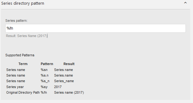

daedalus 434 Posted May 14, 2018 Posted May 14, 2018 (edited) never came across not appending the year, but this should be a normal behavior by design to avoid false sorting of series with the name if you don't want the year included in the series folder name, you can change this by your liking in AutoOrganize -> Tv -> Series Directory Pattern movie section offers the same setting double entries in the list are a long known issue Edited May 14, 2018 by daedalus
Garbonzo17 26 Posted June 8, 2018 Author Posted June 8, 2018 I understand how it could be normal behavior for it to do when same title with different year exists. My issue with Designated Survivor shouldn't apply in that situation. As I said, I think it happened because I didn't allow it to find the folder i had created organically at the next database scan. I instead did 'identify' which will often present multiple 'finds' from different sources (assuming imdb, tvdb, etc) some (usually the one that has the cleaner artwork) will force a date. To be clear, my settings DONT have date in the variable (i.e. I am usin %sn not %fn). If I knew what folders to save and what to not save as far as the file/folders go, I'm happy to do a complete uninstall of the server and then reinstall it and let it scan my directories again as I store the metadata at the media locations. What I would like to not have to do is create the six user accounts I currently have from scratch again... I would like to keep that info and hopefully the watched shows information, but then it should be able to not have the duplicate entries in the auto organize dialog. I know now how to manually create the folder right the first time. Why is it that even if I were to keep the one with the date added, if I go through the auto organize interface to manually add something not understood (click the folder icon, pick series name) it shows 2 identical 'Designated Survivor' entries, and of course #1 creates the folder I've deleted with the (2016) appended and #2 creates it the correct way. This is contrary to whatever I may have fixed in metadata manager. I can manually edit the folder first then going to metadata manager and edit the title and get it exactly how I want it, yet there will still exist 2 entries in the auto organize database apparently. Is it possible to edit a database file somewhere? If no one else is having this problem, probably the simplest thing is for me to start over and have it rescan, I just really don't want to lose the user information, but I suppose I could create the corresponding user accounts and Kodi and have it synchronize prior and then again afterwards, I don't know if that would work or not. Anyway, thank you for any insight. -g Sent from my A0001 using Tapatalk
