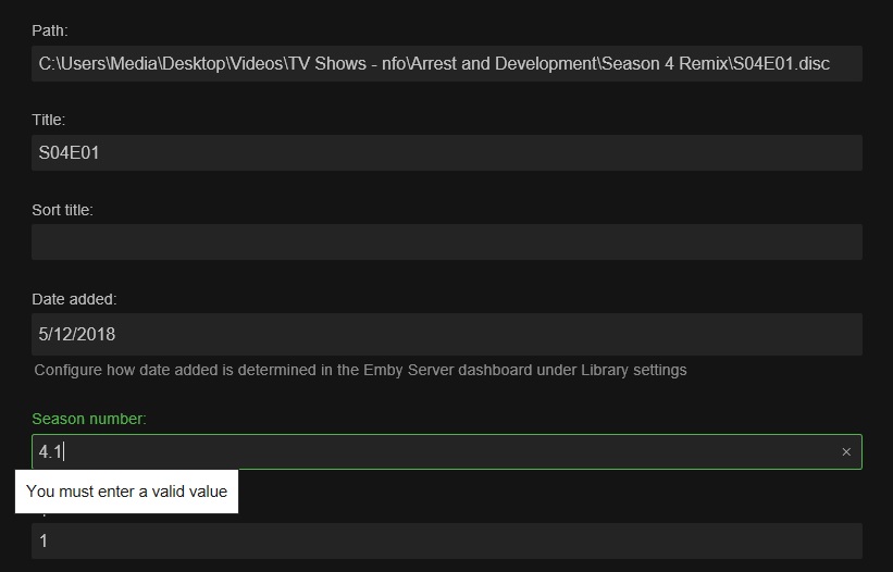

Happy2Play 9802 Posted May 12, 2018 Posted May 12, 2018 can i created a folder called Season 4 Remix? cause when io do that it takes the episodes and puts them in the Season 4 (which is locked) . That would mean the metadata says they are season 4. How are they named? I suspect you will have to manually edit every episodes metadata.
invertedknife 13 Posted May 12, 2018 Author Posted May 12, 2018 That would mean the metadata says they are season 4. How are they named? I suspect you will have to manually edit every episodes metadata. The folder is named Season 4 Remix, and the episode inside are named "E1 - Title", "E2 - Title" and so on
Happy2Play 9802 Posted May 12, 2018 Posted May 12, 2018 @@Luke It would appear there is no way to do this in Emby as Season requires valid values.

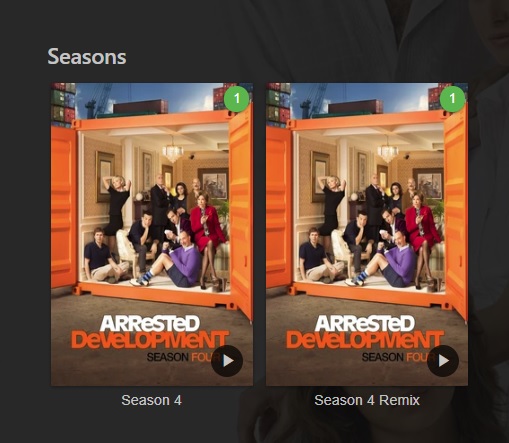

Happy2Play 9802 Posted May 13, 2018 Posted May 13, 2018 (edited) Had to manually edit season.nfo and remove "<seasonnumber>4</seasonnumber>" (on remix folder) then Refresh scan new media and updates. This basically forces Emby to read the Title field. ***Since the seasons get merged via Emby there is no way to make this edit in the ui since only one season is presented. You have to manually edit at folder level. Edited May 13, 2018 by Happy2Play
invertedknife 13 Posted May 13, 2018 Author Posted May 13, 2018 Had to manually edit season.nfo and remove "<seasonnumber>4</seasonnumber>" (on remix folder) then Refresh scan new media and updates. This basically forces Emby to read the Title field. where is the file located? i don't save metadata inside the folder itself
Happy2Play 9802 Posted May 13, 2018 Posted May 13, 2018 That will be the issue, if you don't save metadata with media then it is only saved in the database. You could try this, add this season.nfo to your Remix folder and perform a Refresh metadata "Scan for new and updated files". season.nfo 1
Happy2Play 9802 Posted May 13, 2018 Posted May 13, 2018 (edited) Sorry you will need to edit the art/poster tag as it points to my image. You will have to manually upload a image for the season. Edited May 13, 2018 by Happy2Play 1
invertedknife 13 Posted May 13, 2018 Author Posted May 13, 2018 Sorry you will need to edit the art/poster tag as it points to my image. You will have to manually upload a image for the season. thanks alot man. it works!
porkbone 48 Posted May 13, 2018 Posted May 13, 2018 Thanks! Worked great - you will still needed to edit the metadata for each episode, but separated season 4 from remix 4 perfectly.
