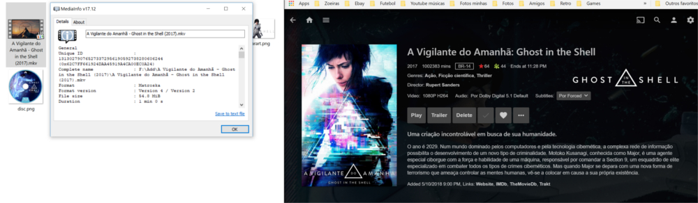

onewaytrigger 1 Posted May 10, 2018 Author Posted May 10, 2018 Ok, just tried to add the same movie that were misidentified earlier, not sure if Emby read it's .nfo or just picked the right ID, any changes made on it's metadata is not stored on it's .nfo file tought. Here's a screenshot just to demonstrate the issue of .nfo files not being created Here's the log from last session when I imported the two movies embyserver-63661498530.txt
Luke 42210 Posted May 10, 2018 Posted May 10, 2018 Ok this is actually an error to save the nfo due to the incredibly long runtime reported, which is much higher than expected. I can fix this for the next server release to stop the error from happening, but is your video file actually that long? 1

onewaytrigger 1 Posted May 11, 2018 Author Posted May 11, 2018 Ok, I just cut another movie with ffmpeg to 1 min length to demonstrate: Here's the same file, in case you want try to reproduce it: https://drive.google.com/file/d/1fQhynrUgVxKwefoGxc0rLNazVF-RVy1L/view?usp=sharing
Luke 42210 Posted May 11, 2018 Posted May 11, 2018 Strange. It is coming up correct as 1 minute for me. What is your system locale set to?
