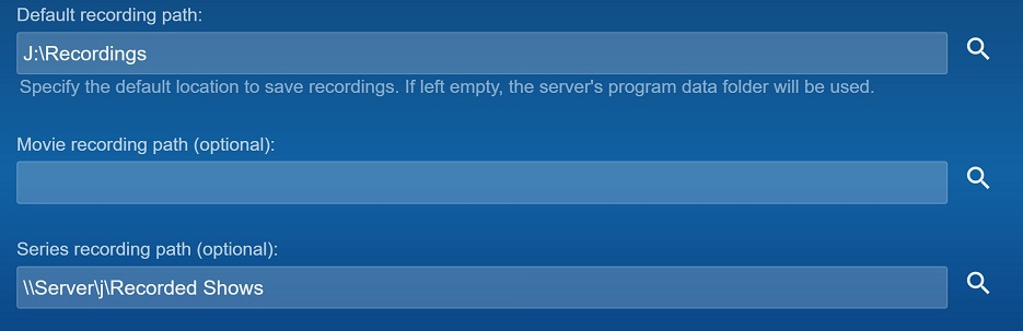

Guest asrequested Posted May 11, 2018 Posted May 11, 2018 Default recording location under DVR settings is set to "M:\Recorded TV". Not sure how the "Series" and "Movies" subfolders are controlled. You can specify their paths

Guest asrequested Posted May 12, 2018 Posted May 12, 2018 Are you setting your tv shows directory inside the default recording directory? If yes, don't do that. Have them not be nested. Create separate folders. If you look at the pic I posted, mine are on the same drive, but separate directories.
revengineer 142 Posted May 12, 2018 Author Posted May 12, 2018 Are you setting your tv shows directory inside the default recording directory? If yes, don't do that. Have them not be nested. Create separate folders. If you look at the pic I posted, mine are on the same drive, but separate directories. I set default, movies, and series recording paths all to "M:\Recorded TV". Are you saying this is no good?
Guest asrequested Posted May 12, 2018 Posted May 12, 2018 I set default, movies, and series recording paths all to "M:\Recorded TV". Are you saying this is no good? If you do that, it's the same as just using the default location. It will create sub folders. Have them be their own folder. M:/Recorded movies M:/Recorded shows M:/Recordings That last one will be default, so sports and other things will be recorded, there.
revengineer 142 Posted May 12, 2018 Author Posted May 12, 2018 If you do that, it's the same as just using the default location. It will create sub folders. Have them be their own folder. M:/Recorded movies M:/Recorded shows M:/Recordings That last one will be default, so sports and other things will be recorded, there. Understood now, thanks. This leaves the recursive metadata downloading as the remaining issue. Waiting for @@Luke to comment.
