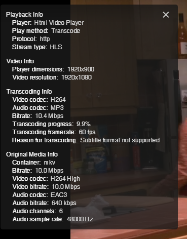

I just found if I use ass subtitle file, transcoding will be implemented because subtitle format is not supported when I play with web app. And one more question, when it's tanscoding, audio becomes mp3. Can I setup audio as pass though to let my device decodes?
No you can't because web browsers don't support eac3. The best thing to do is just press play and enjoy the show. Emby will bring it to you in the best way possible for the device that you're using.
