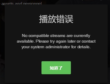

Ausley 1 Posted May 4, 2018 Posted May 4, 2018 I use Emby server 3.4.0.0 windows and ATV app. I have several subtitles problems. 1. When I play video with ass subtitles, the Fontname in style is ignored no matter what fonts I used but all other setups are supported like Fontsize, PrimaryColour.... and fonts in Dialogue are also supported. 2. On server, I can select subtitles before I play but I cannot on app. Subtitles is off or forced in default. On app, I can only change subtitles after I start to play. 3. If I use the file name of subtitles like this xxxxxx.chn.ass, I cannot select it on app. I have to use file name like this only xxxxxx.ass. On server, I will get a wrong message like the picture.

Ausley 1 Posted May 4, 2018 Author Posted May 4, 2018 You cannot see any playback because it crashed when I played with subtitles file name like this xxxxxx.chn.ass. I don't see any playback in that log. Also, please attach the file to the post as described in the topic linked above instead of pasting the contents in. Finally, what app is "ATV"? Apple or Android? Thanks.
