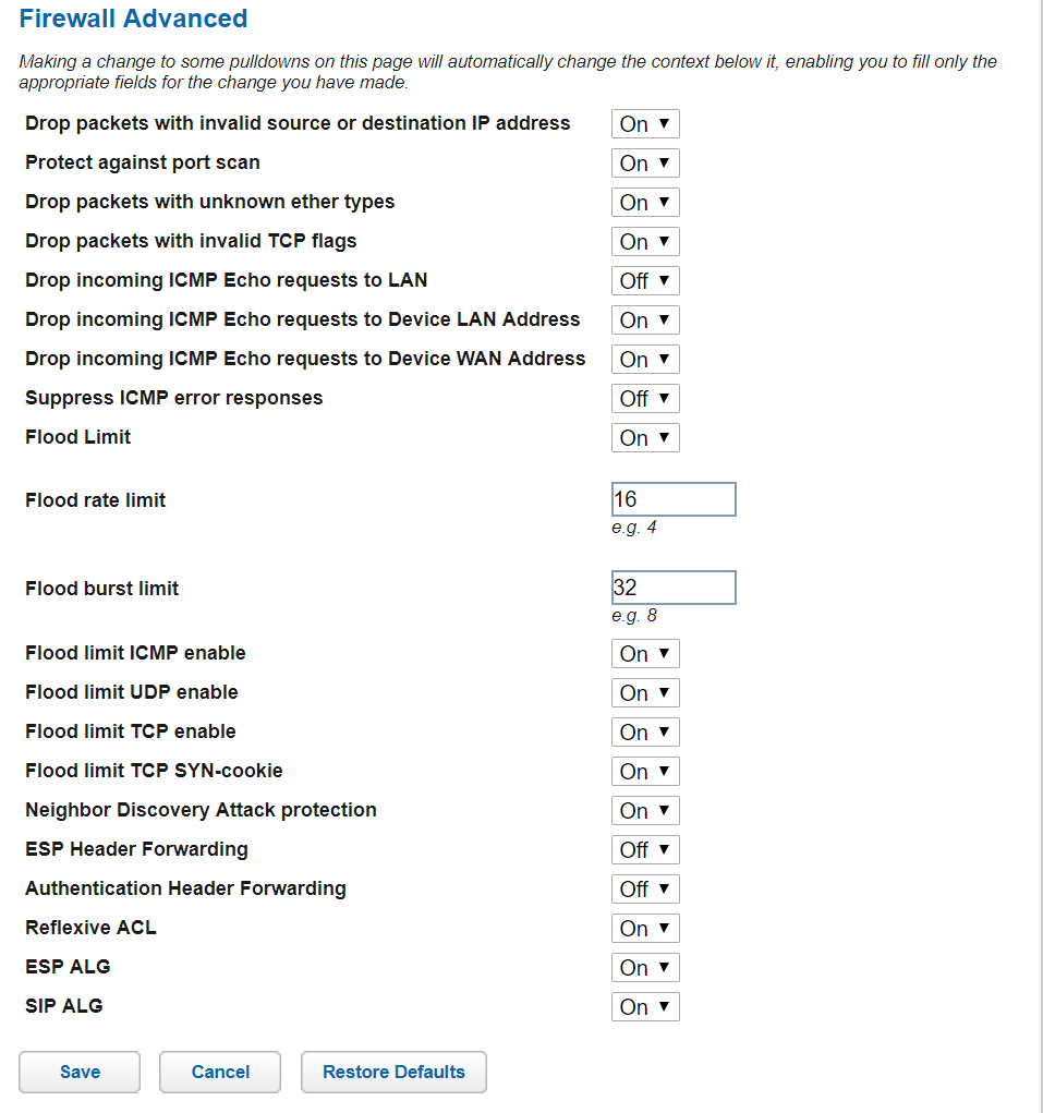

LqHnyBear 23 Posted April 30, 2018 Author Posted April 30, 2018 It's not the port I use. I didn't want to advertise the ip/port in forums to my server. I did some more testing and when I go into my ATT uverse gateway and into the advanced firewall settings and turn everything off. Emby suddenly loads perfectly. Do you see something in there that could be causing the problem?
Luke 42212 Posted April 30, 2018 Posted April 30, 2018 I'm not quite sure, sorry. What brand router is that? I haven't seen that configuration UI before.
LqHnyBear 23 Posted April 30, 2018 Author Posted April 30, 2018 For some reason when I try to connect to my server via ip address and port it never fully loads. I thought those settings were doing something but they aren't. If I use emby connect, it connects fine. The iOS app shows my library etc but as previously stated nothing will play, I just get the spinning ring of death... lol Do you know about when the update for the iOS app will be out?
