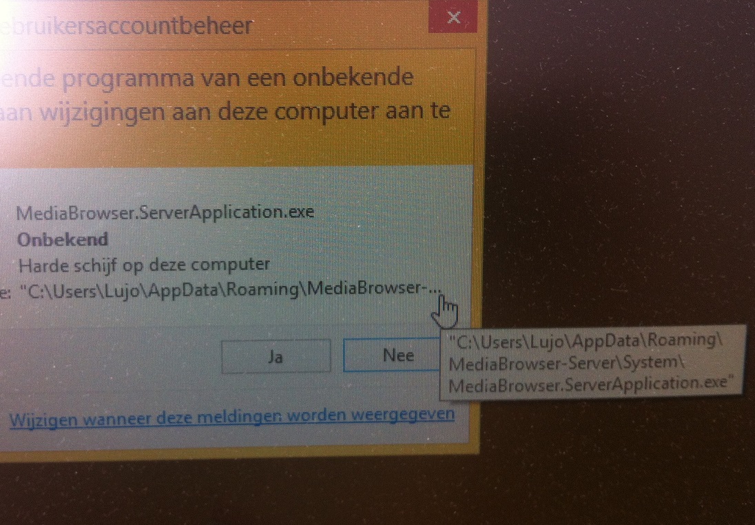

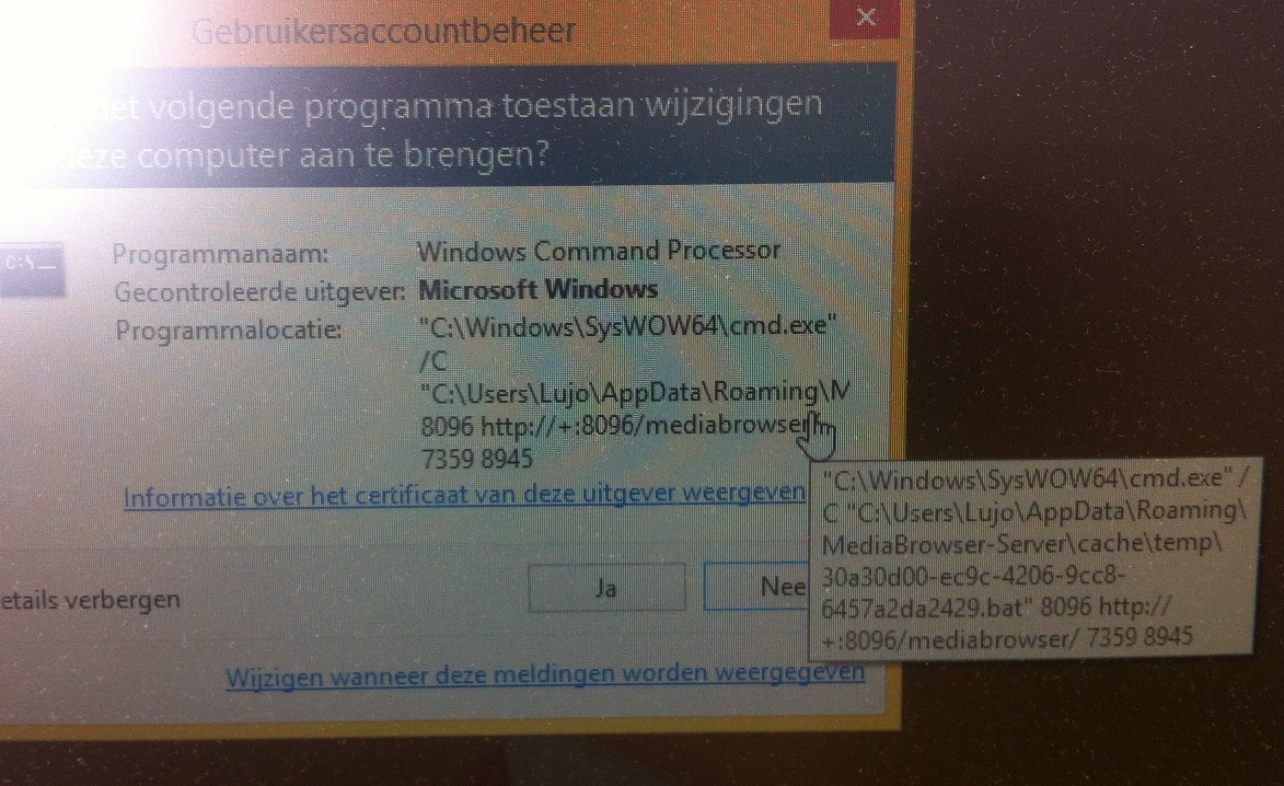

lujo 0 Posted March 24, 2014 Author Posted March 24, 2014 (edited) It is a standard pop-up window that I get when I try to start MB3 or any other application (UserAccountControl). Onbekend = Unknown Harde schijf op deze computer = Hard drive on this computer Programmanaam: Application name Gecontroleerde uitgever: Controlled Publisher Programmalokatie: Application Location Is this helping? Edited March 24, 2014 by lujo

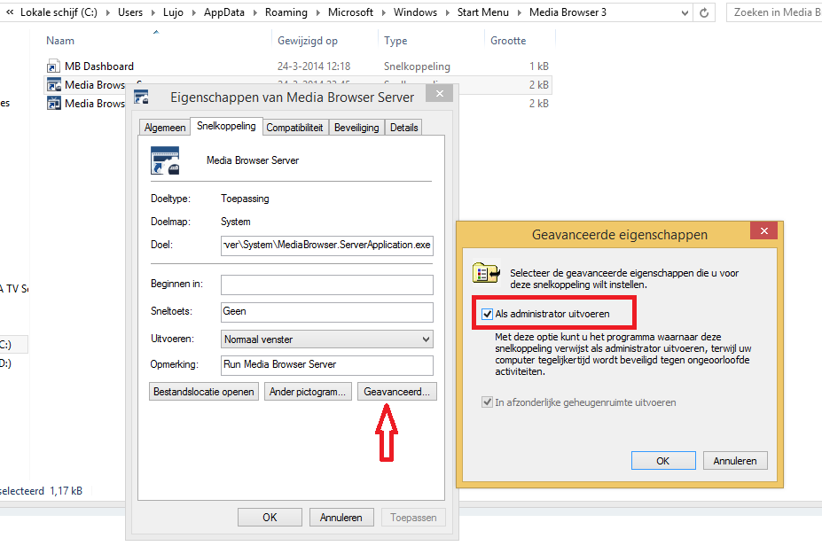

lujo 0 Posted March 25, 2014 Author Posted March 25, 2014 (edited) After turning UAC off server still doesn't work. The only option what was helping in my case was to go to C:\Users\Lujo\AppData\Roaming\Microsoft\Windows\Start Menu\Media Browser 3 select Media Browser Server.exe (right mouse button) and select Run as Administrator. Is it possible to add that Server Always run as a Administrator? So it is not needed that user select this. Edited March 24, 2014 by lujo
ebr 16357 Posted March 25, 2014 Posted March 25, 2014 Looks like your normal user doesn't have authority to start our http server. When you run as admin (or as the service which is tied to the admin account I assume) it doesn't have this problem.
