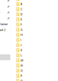

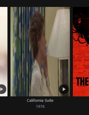

qnvy82 2 Posted April 19, 2018 Author Posted April 19, 2018 Hi there, @@qnvy82, can you please go over an example? What is the movie and what is the filename as well as the parent folder name? Is it in a library using the Movies content type? What version of Emby Server are you running, and on what OS/platform? Thanks ! Hi there, @@qnvy82, can you please go over an example? What is the movie and what is the filename as well as the parent folder name? Is it in a library using the Movies content type? What version of Emby Server are you running, and on what OS/platform? Thanks ! Please see attached. I'm running the latest version of Emby 3.3.1.0 on Windows Server 2016. I have the parent folders separated by letters. If the movie letter begins with "A", it goes in the "A" folder. this has helped with the slow scanning problem that I initially had, but now i'm noticing that a lot of my movie posters are missing. There are too many for me to post here. I have attached some files that show examples of what i'm trying to explain. Thanks.

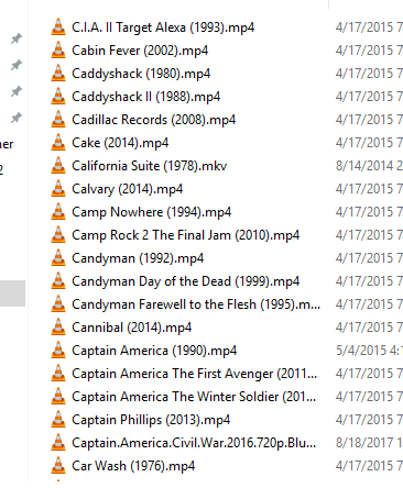

psybertech 33 Posted April 20, 2018 Posted April 20, 2018 (edited) Please see attached. I'm running the latest version of Emby 3.3.1.0 on Windows Server 2016. I have the parent folders separated by letters. If the movie letter begins with "A", it goes in the "A" folder. this has helped with the slow scanning problem that I initially had, but now i'm noticing that a lot of my movie posters are missing. There are too many for me to post here. I have attached some files that show examples of what i'm trying to explain. Thanks. Just curious.. are your movies in folders under the letter? So /c/California Suite (1978)/California Suite 1978.ext or /c/California Suite 1978.ext Big difference if it is the latter.... it won't work properly. You need the former. Edited April 20, 2018 by psybertech
qnvy82 2 Posted April 20, 2018 Author Posted April 20, 2018 Just curious.. are your movies in folders under the letter? So /c/California Suite (1978)/California Suite 1978.ext or /c/California Suite 1978.ext Big difference if it is the latter.... it won't work properly. You need the former. it would be /c/California Suite 1978.ext in my case. So you're saying that each file needs to have a parent folder with the same name minus the .ext in order for the scanning to work properly? if so, a powershell script would be the only way i could fix that in a short period of time on my platform because i have too many files. thanks.

Luke 42210 Posted April 20, 2018 Posted April 20, 2018 No, movie folders are not required but recommended. Can you show the contents of the c folder?
qnvy82 2 Posted April 20, 2018 Author Posted April 20, 2018 No, movie folders are not required but recommended. Can you show the contents of the c folder? please see attached

Luke 42210 Posted May 8, 2018 Posted May 8, 2018 @@qnvy82 have you tried using the Identify feature on one of these titles to make sure it is properly matched with an internet database? That would be a good thing to try on one of them.
Luke 42210 Posted May 8, 2018 Posted May 8, 2018 The only other thing I can think of is that perhaps you disabled internet metadata and/or images and if you did that, then an image would be extracted.
