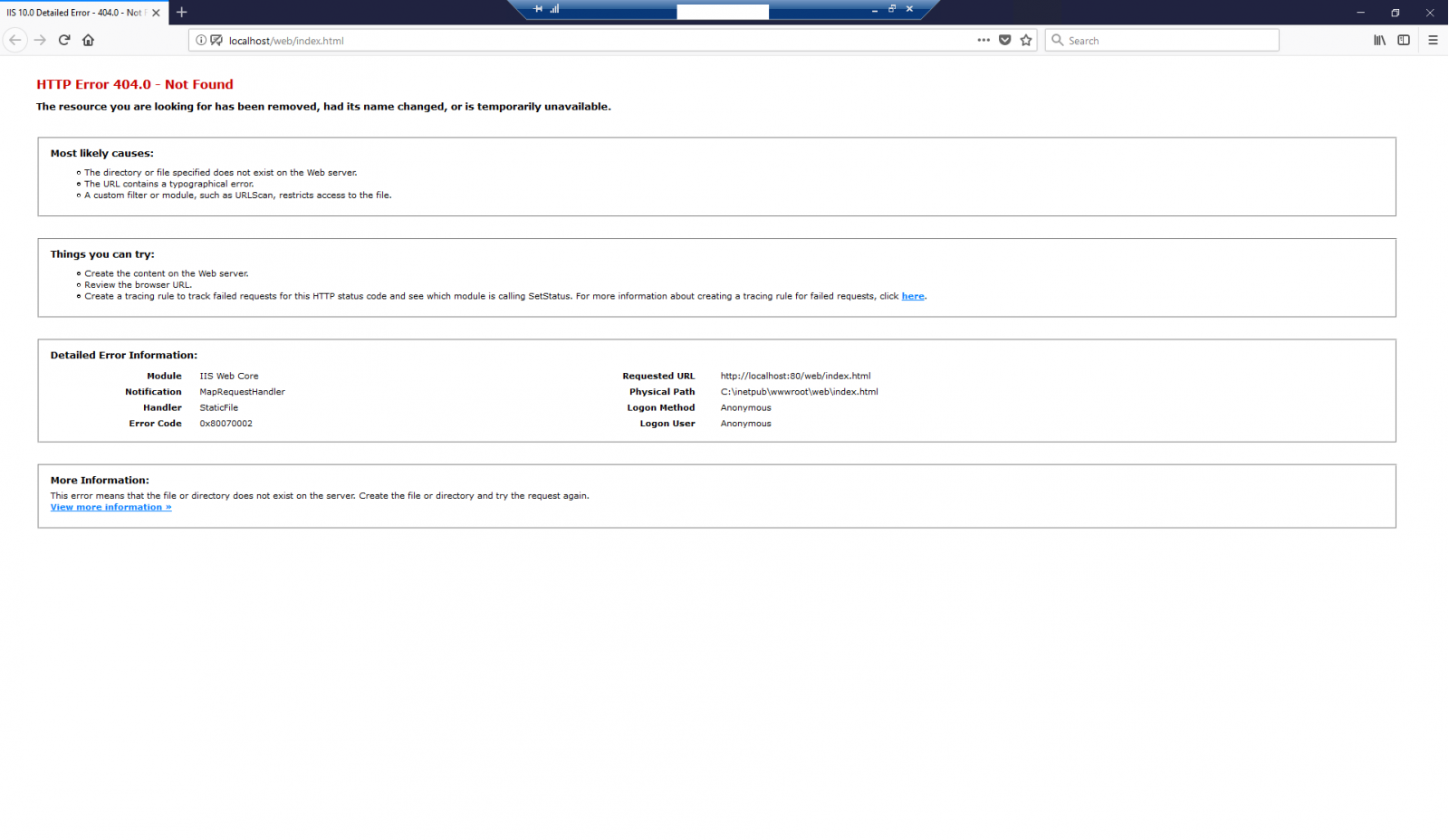

93stisa 1 Posted April 12, 2018 Posted April 12, 2018 Hi, My Emby wont start anymore, its been working without any issue for a long time. And today I could'nt access it, on the server it shows "HTTP Error 404.0 - Not Found". It runs on a Windows 10 x64. I tried to reinstall but same issue, have not yet restarted the server (it runs other stuff aswell.) Error log below: 2018-04-12 11:15:04.692 Info Main: Application path: C:\Users\admin\AppData\Roaming\Emby-Server\system\EmbyServer.dll 2018-04-12 11:15:04.696 Info Main: Emby Command line: C:\Users\admin\AppData\Roaming\Emby-Server\system\EmbyServer.dll Operating system: Microsoft Windows NT 6.2.9200.0 64-Bit OS: True 64-Bit Process: True User Interactive: True Processor count: 4 Program data path: C:\Users\admin\AppData\Roaming\Emby-Server Application directory: C:\Users\admin\AppData\Roaming\Emby-Server\system 2018-04-12 11:15:05.636 Info Main: Tray icon path: C:\Users\admin\AppData\Roaming\Emby-Server\system\electron\embytray 2018-04-12 11:15:05.910 Info App: Application version: 3.3.1.0 2018-04-12 11:15:05.912 Info App: Loading assemblies 2018-04-12 11:15:06.424 Info App: Loading AutoBoxSets, Version=1.1.2.0, Culture=neutral, PublicKeyToken=null 2018-04-12 11:15:06.424 Info App: Loading EmbyReports, Version=1.0.4.0, Culture=neutral, PublicKeyToken=null 2018-04-12 11:15:06.424 Info App: Loading FolderSync, Version=3.1.2.0, Culture=neutral, PublicKeyToken=null 2018-04-12 11:15:06.424 Info App: Loading GenreCleaner, Version=1.0.5.0, Culture=neutral, PublicKeyToken=null 2018-04-12 11:15:06.424 Info App: Loading MBBackup, Version=1.2.1.0, Culture=neutral, PublicKeyToken=null 2018-04-12 11:15:06.424 Info App: Loading Messages, Version=1.0.0.0, Culture=neutral, PublicKeyToken=null 2018-04-12 11:15:06.424 Info App: Loading MediaBrowser.Api, Version=1.0.0.0, Culture=neutral, PublicKeyToken=null 2018-04-12 11:15:06.424 Info App: Loading MediaBrowser.WebDashboard, Version=1.0.0.0, Culture=neutral, PublicKeyToken=null 2018-04-12 11:15:06.424 Info App: Loading MediaBrowser.Model, Version=1.0.0.0, Culture=neutral, PublicKeyToken=null 2018-04-12 11:15:06.424 Info App: Loading MediaBrowser.Common, Version=1.0.0.0, Culture=neutral, PublicKeyToken=null 2018-04-12 11:15:06.424 Info App: Loading MediaBrowser.Controller, Version=1.0.0.0, Culture=neutral, PublicKeyToken=null 2018-04-12 11:15:06.424 Info App: Loading MediaBrowser.Providers, Version=1.0.0.0, Culture=neutral, PublicKeyToken=null 2018-04-12 11:15:06.424 Info App: Loading Emby.Photos, Version=1.0.0.0, Culture=neutral, PublicKeyToken=null 2018-04-12 11:15:06.424 Info App: Loading Emby.Server.Implementations, Version=1.0.0.0, Culture=neutral, PublicKeyToken=null 2018-04-12 11:15:06.424 Info App: Loading Emby.Server.MediaEncoding, Version=1.0.0.0, Culture=neutral, PublicKeyToken=null 2018-04-12 11:15:06.424 Info App: Loading Emby.Dlna, Version=1.0.0.0, Culture=neutral, PublicKeyToken=null 2018-04-12 11:15:06.424 Info App: Loading MediaBrowser.LocalMetadata, Version=1.0.0.0, Culture=neutral, PublicKeyToken=null 2018-04-12 11:15:06.424 Info App: Loading MediaBrowser.XbmcMetadata, Version=1.0.0.0, Culture=neutral, PublicKeyToken=null 2018-04-12 11:15:06.424 Info App: Loading Emby.Server.CinemaMode, Version=1.0.0.0, Culture=neutral, PublicKeyToken=null 2018-04-12 11:15:06.424 Info App: Loading Emby.Server.Connect, Version=1.0.0.0, Culture=neutral, PublicKeyToken=null 2018-04-12 11:15:06.424 Info App: Loading Emby.Server.Sync, Version=1.0.0.0, Culture=neutral, PublicKeyToken=null 2018-04-12 11:15:06.756 Info SqliteUserRepository: Sqlite version: 3.22.0 2018-04-12 11:15:06.756 Info SqliteUserRepository: Sqlite compiler options: COMPILER=msvc-1500,ENABLE_COLUMN_METADATA,ENABLE_DBSTAT_VTAB,ENABLE_FTS3,ENABLE_FTS4,ENABLE_FTS5,ENABLE_JSON1,ENABLE_RTREE,MAX_TRIGGER_DEPTH=100,TEMP_STORE=1,THREADSAFE=1 2018-04-12 11:15:06.785 Info SqliteUserRepository: Default journal_mode for C:\Users\admin\AppData\Roaming\Emby-Server\data\users.db is wal 2018-04-12 11:15:06.788 Info SqliteUserRepository: PRAGMA synchronous=1 2018-04-12 11:15:06.800 Info AuthenticationRepository: Default journal_mode for C:\Users\admin\AppData\Roaming\Emby-Server\data\authentication.db is wal 2018-04-12 11:15:06.800 Info AuthenticationRepository: PRAGMA synchronous=1 2018-04-12 11:15:06.930 Info DeviceManager: Default journal_mode for C:\Users\admin\AppData\Roaming\Emby-Server\data\devices.db is wal 2018-04-12 11:15:06.930 Info DeviceManager: PRAGMA synchronous=1 2018-04-12 11:15:06.952 Info ActivityRepository: Default journal_mode for C:\Users\admin\AppData\Roaming\Emby-Server\data\activitylog.db is wal 2018-04-12 11:15:06.952 Info ActivityRepository: PRAGMA synchronous=1 2018-04-12 11:15:06.956 Info SqliteDisplayPreferencesRepository: Default journal_mode for C:\Users\admin\AppData\Roaming\Emby-Server\data\displaypreferences.db is wal 2018-04-12 11:15:06.956 Info SqliteDisplayPreferencesRepository: PRAGMA synchronous=1 2018-04-12 11:15:06.959 Info SqliteItemRepository: Default journal_mode for C:\Users\admin\AppData\Roaming\Emby-Server\data\library.db is wal 2018-04-12 11:15:06.959 Info SqliteItemRepository: PRAGMA synchronous=1 2018-04-12 11:15:06.980 Info SqliteNotificationsRepository: Default journal_mode for C:\Users\admin\AppData\Roaming\Emby-Server\data\notifications.db is wal 2018-04-12 11:15:06.980 Info SqliteNotificationsRepository: PRAGMA synchronous=1 2018-04-12 11:15:07.308 Info HttpServer: Calling ServiceStack AppHost.Init 2018-04-12 11:15:07.918 Info ServerManager: Loading Http Server 2018-04-12 11:15:07.947 Info HttpServer: Adding HttpListener prefix http://+:80/ 2018-04-12 11:15:07.949 Info HttpServer: Adding HttpListener prefix https://+:443/ 2018-04-12 11:15:08.218 Error ServerManager: Error starting Http Server *** Error Report *** Version: 3.3.1.0 Command line: C:\Users\admin\AppData\Roaming\Emby-Server\system\EmbyServer.dll Operating system: Microsoft Windows NT 6.2.9200.0 64-Bit OS: True 64-Bit Process: True User Interactive: True Processor count: 4 Program data path: C:\Users\admin\AppData\Roaming\Emby-Server Application directory: C:\Users\admin\AppData\Roaming\Emby-Server\system System.AggregateException: One or more errors occurred. (An attempt was made to access a socket in a way forbidden by its access permissions) ---> System.Net.Sockets.SocketException: An attempt was made to access a socket in a way forbidden by its access permissions at System.Net.Sockets.Socket.UpdateStatusAfterSocketErrorAndThrowException(SocketError error, String callerName) at System.Net.Sockets.Socket.DoBind(EndPoint endPointSnapshot, SocketAddress socketAddress) at System.Net.Sockets.Socket.Bind(EndPoint localEP) at SocketHttpListener.Net.EndPointListener.CreateSocket() at SocketHttpListener.Net.EndPointManager.<GetEPListener>d__6.MoveNext() --- End of inner exception stack trace --- at System.Threading.Tasks.Task`1.GetResultCore(Boolean waitCompletionNotification) at SocketHttpListener.Net.EndPointManager.AddPrefixInternal(ILogger logger, String p, HttpListener listener) at SocketHttpListener.Net.EndPointManager.AddListener(ILogger logger, HttpListener listener) at SocketHttpListener.Net.HttpListener.Start() at Emby.Server.Implementations.ServerManager.ServerManager.ReloadHttpServer(String[] urlPrefixes) ---> (Inner Exception #0) System.Net.Sockets.SocketException (0x80004005): An attempt was made to access a socket in a way forbidden by its access permissions at System.Net.Sockets.Socket.UpdateStatusAfterSocketErrorAndThrowException(SocketError error, String callerName) at System.Net.Sockets.Socket.DoBind(EndPoint endPointSnapshot, SocketAddress socketAddress) at System.Net.Sockets.Socket.Bind(EndPoint localEP) at SocketHttpListener.Net.EndPointListener.CreateSocket() at SocketHttpListener.Net.EndPointManager.<GetEPListener>d__6.MoveNext()<--- System.AggregateException at System.Threading.Tasks.Task`1.GetResultCore(Boolean waitCompletionNotification) at SocketHttpListener.Net.EndPointManager.AddPrefixInternal(ILogger logger, String p, HttpListener listener) at SocketHttpListener.Net.EndPointManager.AddListener(ILogger logger, HttpListener listener) at SocketHttpListener.Net.HttpListener.Start() at Emby.Server.Implementations.ServerManager.ServerManager.ReloadHttpServer(String[] urlPrefixes) InnerException: System.Net.Sockets.SocketException System.Net.Sockets.SocketException (0x80004005): An attempt was made to access a socket in a way forbidden by its access permissions at System.Net.Sockets.Socket.UpdateStatusAfterSocketErrorAndThrowException(SocketError error, String callerName) at System.Net.Sockets.Socket.DoBind(EndPoint endPointSnapshot, SocketAddress socketAddress) at System.Net.Sockets.Socket.Bind(EndPoint localEP) at SocketHttpListener.Net.EndPointListener.CreateSocket() at SocketHttpListener.Net.EndPointManager.<GetEPListener>d__6.MoveNext() at System.Net.Sockets.Socket.UpdateStatusAfterSocketErrorAndThrowException(SocketError error, String callerName) at System.Net.Sockets.Socket.DoBind(EndPoint endPointSnapshot, SocketAddress socketAddress) at System.Net.Sockets.Socket.Bind(EndPoint localEP) at SocketHttpListener.Net.EndPointListener.CreateSocket() at SocketHttpListener.Net.EndPointManager.<GetEPListener>d__6.MoveNext() 2018-04-12 11:15:08.225 Error App: Error starting http server *** Error Report *** Version: 3.3.1.0 Command line: C:\Users\admin\AppData\Roaming\Emby-Server\system\EmbyServer.dll Operating system: Microsoft Windows NT 6.2.9200.0 64-Bit OS: True 64-Bit Process: True User Interactive: True Processor count: 4 Program data path: C:\Users\admin\AppData\Roaming\Emby-Server Application directory: C:\Users\admin\AppData\Roaming\Emby-Server\system System.AggregateException: One or more errors occurred. (An attempt was made to access a socket in a way forbidden by its access permissions) ---> System.Net.Sockets.SocketException: An attempt was made to access a socket in a way forbidden by its access permissions at System.Net.Sockets.Socket.UpdateStatusAfterSocketErrorAndThrowException(SocketError error, String callerName) at System.Net.Sockets.Socket.DoBind(EndPoint endPointSnapshot, SocketAddress socketAddress) at System.Net.Sockets.Socket.Bind(EndPoint localEP) at SocketHttpListener.Net.EndPointListener.CreateSocket() at SocketHttpListener.Net.EndPointManager.<GetEPListener>d__6.MoveNext() --- End of inner exception stack trace --- at System.Threading.Tasks.Task`1.GetResultCore(Boolean waitCompletionNotification) at SocketHttpListener.Net.EndPointManager.AddPrefixInternal(ILogger logger, String p, HttpListener listener) at SocketHttpListener.Net.EndPointManager.AddListener(ILogger logger, HttpListener listener) at SocketHttpListener.Net.HttpListener.Start() at Emby.Server.Implementations.ServerManager.ServerManager.ReloadHttpServer(String[] urlPrefixes) at Emby.Server.Implementations.ApplicationHost.StartServer() ---> (Inner Exception #0) System.Net.Sockets.SocketException (0x80004005): An attempt was made to access a socket in a way forbidden by its access permissions at System.Net.Sockets.Socket.UpdateStatusAfterSocketErrorAndThrowException(SocketError error, String callerName) at System.Net.Sockets.Socket.DoBind(EndPoint endPointSnapshot, SocketAddress socketAddress) at System.Net.Sockets.Socket.Bind(EndPoint localEP) at SocketHttpListener.Net.EndPointListener.CreateSocket() at SocketHttpListener.Net.EndPointManager.<GetEPListener>d__6.MoveNext()<--- System.AggregateException at System.Threading.Tasks.Task`1.GetResultCore(Boolean waitCompletionNotification) at SocketHttpListener.Net.EndPointManager.AddPrefixInternal(ILogger logger, String p, HttpListener listener) at SocketHttpListener.Net.EndPointManager.AddListener(ILogger logger, HttpListener listener) at SocketHttpListener.Net.HttpListener.Start() at Emby.Server.Implementations.ServerManager.ServerManager.ReloadHttpServer(String[] urlPrefixes) at Emby.Server.Implementations.ApplicationHost.StartServer() InnerException: System.Net.Sockets.SocketException System.Net.Sockets.SocketException (0x80004005): An attempt was made to access a socket in a way forbidden by its access permissions at System.Net.Sockets.Socket.UpdateStatusAfterSocketErrorAndThrowException(SocketError error, String callerName) at System.Net.Sockets.Socket.DoBind(EndPoint endPointSnapshot, SocketAddress socketAddress) at System.Net.Sockets.Socket.Bind(EndPoint localEP) at SocketHttpListener.Net.EndPointListener.CreateSocket() at SocketHttpListener.Net.EndPointManager.<GetEPListener>d__6.MoveNext() at System.Net.Sockets.Socket.UpdateStatusAfterSocketErrorAndThrowException(SocketError error, String callerName) at System.Net.Sockets.Socket.DoBind(EndPoint endPointSnapshot, SocketAddress socketAddress) at System.Net.Sockets.Socket.Bind(EndPoint localEP) at SocketHttpListener.Net.EndPointListener.CreateSocket() at SocketHttpListener.Net.EndPointManager.<GetEPListener>d__6.MoveNext() 2018-04-12 11:15:08.225 Info ServerManager: Loading Http Server 2018-04-12 11:15:08.225 Info HttpServer: Adding HttpListener prefix http://+:8096/ 2018-04-12 11:15:08.226 Info HttpServer: Adding HttpListener prefix https://+:443/ 2018-04-12 11:15:08.570 Info Skia: SkiaSharp version: 1.58.0.0 2018-04-12 11:15:08.613 Info TaskManager: Daily trigger for Configuration Backup set to fire at 2018-04-13 00:10:00, which is 774.85644694 minutes from now. 2018-04-12 11:15:08.618 Info TaskManager: Daily trigger for Chapter image extraction set to fire at 2018-04-13 02:00:00, which is 884.856354325 minutes from now. 2018-04-12 11:15:08.629 Info TaskManager: Daily trigger for Start new log file set to fire at 2018-04-13 00:00:00, which is 764.85617445 minutes from now. 2018-04-12 11:15:08.672 Info MediaEncoder: FFMpeg: C:\Users\admin\AppData\Roaming\Emby-Server\system\ffmpeg.exe 2018-04-12 11:15:08.672 Info MediaEncoder: FFProbe: C:\Users\admin\AppData\Roaming\Emby-Server\system\ffprobe.exe 2018-04-12 11:15:08.672 Info MediaEncoder: Validating media encoder at C:\Users\admin\AppData\Roaming\Emby-Server\system\ffmpeg.exe 2018-04-12 11:15:08.676 Info MediaEncoder: Running C:\Users\admin\AppData\Roaming\Emby-Server\system\ffmpeg.exe -decoders 2018-04-12 11:15:08.885 Info MediaEncoder: Decoder available: mpeg2video 2018-04-12 11:15:08.885 Info MediaEncoder: Decoder available: h264_qsv 2018-04-12 11:15:08.885 Info MediaEncoder: Decoder available: hevc_qsv 2018-04-12 11:15:08.885 Info MediaEncoder: Decoder available: mpeg2_qsv 2018-04-12 11:15:08.885 Info MediaEncoder: Decoder available: vc1_qsv 2018-04-12 11:15:08.885 Info MediaEncoder: Decoder available: h264_cuvid 2018-04-12 11:15:08.885 Info MediaEncoder: Decoder available: hevc_cuvid 2018-04-12 11:15:08.885 Info MediaEncoder: Decoder available: mpeg2_cuvid 2018-04-12 11:15:08.885 Info MediaEncoder: Decoder available: mpeg4_cuvid 2018-04-12 11:15:08.886 Info MediaEncoder: Decoder available: vc1_cuvid 2018-04-12 11:15:08.886 Info MediaEncoder: Decoder available: vp8_cuvid 2018-04-12 11:15:08.886 Info MediaEncoder: Decoder available: vp9_cuvid 2018-04-12 11:15:08.888 Info MediaEncoder: Decoder available: ac3 2018-04-12 11:15:08.888 Info MediaEncoder: Decoder available: aac 2018-04-12 11:15:08.889 Info MediaEncoder: Decoder available: mp3 2018-04-12 11:15:08.889 Info MediaEncoder: Decoder available: h264 2018-04-12 11:15:08.889 Info MediaEncoder: Decoder available: hevc 2018-04-12 11:15:08.891 Info MediaEncoder: Running C:\Users\admin\AppData\Roaming\Emby-Server\system\ffmpeg.exe -encoders 2018-04-12 11:15:09.136 Info MediaEncoder: Encoder available: libx264 2018-04-12 11:15:09.136 Info MediaEncoder: Encoder available: libx265 2018-04-12 11:15:09.136 Info MediaEncoder: Encoder available: mpeg4 2018-04-12 11:15:09.136 Info MediaEncoder: Encoder available: msmpeg4 2018-04-12 11:15:09.136 Info MediaEncoder: Encoder available: libvpx 2018-04-12 11:15:09.136 Info MediaEncoder: Encoder available: libvpx-vp9 2018-04-12 11:15:09.136 Info MediaEncoder: Encoder available: aac 2018-04-12 11:15:09.136 Info MediaEncoder: Encoder available: libmp3lame 2018-04-12 11:15:09.136 Info MediaEncoder: Encoder available: libopus 2018-04-12 11:15:09.136 Info MediaEncoder: Encoder available: libvorbis 2018-04-12 11:15:09.136 Info MediaEncoder: Encoder available: srt 2018-04-12 11:15:09.136 Info MediaEncoder: Encoder available: h264_nvenc 2018-04-12 11:15:09.137 Info MediaEncoder: Encoder available: hevc_nvenc 2018-04-12 11:15:09.137 Info MediaEncoder: Encoder available: h264_qsv 2018-04-12 11:15:09.137 Info MediaEncoder: Encoder available: hevc_qsv 2018-04-12 11:15:09.137 Info MediaEncoder: Encoder available: libwebp 2018-04-12 11:15:09.137 Info MediaEncoder: Encoder available: ac3 2018-04-12 11:15:09.137 Info MediaEncoder: Encoder validation complete 2018-04-12 11:15:09.143 Info App: ServerId: 5e418ede87224d73ae7c7abd1b7ad613 2018-04-12 11:15:09.143 Info App: Core startup complete 2018-04-12 11:15:09.143 Info App: Post-init migrations complete 2018-04-12 11:15:09.208 Info App: Starting entry point AutoBoxSets.ServerEntryPoint 2018-04-12 11:15:09.222 Info App: Entry point completed: AutoBoxSets.ServerEntryPoint. Duration: 0.0143054 seconds 2018-04-12 11:15:09.222 Info App: Starting entry point Emby.Security.PluginSecurityManager 2018-04-12 11:15:09.222 Info App: Entry point completed: Emby.Security.PluginSecurityManager. Duration: 4.78E-05 seconds 2018-04-12 11:15:09.222 Info App: Starting entry point Emby.Security.PluginSecurityManager 2018-04-12 11:15:09.222 Info App: Entry point completed: Emby.Security.PluginSecurityManager. Duration: 3.93E-05 seconds 2018-04-12 11:15:09.222 Info App: Starting entry point MBBackup.ServerEntryPoint 2018-04-12 11:15:09.222 Info App: Entry point completed: MBBackup.ServerEntryPoint. Duration: 3.13E-05 seconds 2018-04-12 11:15:09.222 Info App: Starting entry point Messages.ServerEntryPoint 2018-04-12 11:15:09.222 Info App: Entry point completed: Messages.ServerEntryPoint. Duration: 5.68E-05 seconds 2018-04-12 11:15:09.222 Info App: Starting entry point MediaBrowser.Api.ApiEntryPoint 2018-04-12 11:15:09.222 Info App: Entry point completed: MediaBrowser.Api.ApiEntryPoint. Duration: 3.19E-05 seconds 2018-04-12 11:15:09.222 Info App: Starting entry point MediaBrowser.WebDashboard.ServerEntryPoint 2018-04-12 11:15:09.223 Info App: Entry point completed: MediaBrowser.WebDashboard.ServerEntryPoint. Duration: 0.0008443 seconds 2018-04-12 11:15:09.223 Info App: Starting entry point Emby.Server.Implementations.Notifications.Notifications 2018-04-12 11:15:09.229 Info App: Entry point completed: Emby.Server.Implementations.Notifications.Notifications. Duration: 0.0059773 seconds 2018-04-12 11:15:09.229 Info App: Starting entry point Emby.Server.Implementations.Notifications.WebSocketNotifier 2018-04-12 11:15:09.230 Info App: Entry point completed: Emby.Server.Implementations.Notifications.WebSocketNotifier. Duration: 0.0011395 seconds 2018-04-12 11:15:09.230 Info App: Starting entry point Emby.Server.Implementations.News.NewsEntryPoint 2018-04-12 11:15:09.231 Info App: Entry point completed: Emby.Server.Implementations.News.NewsEntryPoint. Duration: 0.000318 seconds 2018-04-12 11:15:09.231 Info App: Starting entry point Emby.Server.Implementations.LiveTv.EmbyTV.EntryPoint 2018-04-12 11:15:09.234 Info App: Loading live tv data from C:\Users\admin\AppData\Roaming\Emby-Server\data\livetv\timers 2018-04-12 11:15:09.454 Info App: Entry point completed: Emby.Server.Implementations.LiveTv.EmbyTV.EntryPoint. Duration: 0.2232543 seconds 2018-04-12 11:15:09.454 Info App: Starting entry point Emby.Server.Implementations.IO.LibraryMonitorStartup 2018-04-12 11:15:09.487 Info LibraryMonitor: Skipping realtime monitor for W:\Emby\Media\Live\Konserter because the path does not exist 2018-04-12 11:15:09.487 Info LibraryMonitor: Skipping realtime monitor for W:\Emby\Media\Live\Standup because the path does not exist 2018-04-12 11:15:09.487 Info LibraryMonitor: Skipping realtime monitor for W:\Emby\Media\Serier because the path does not exist 2018-04-12 11:15:09.487 Info App: Entry point completed: Emby.Server.Implementations.IO.LibraryMonitorStartup. Duration: 0.0332811 seconds 2018-04-12 11:15:09.487 Info App: Starting entry point Emby.Server.Implementations.EntryPoints.AutomaticRestartEntryPoint 2018-04-12 11:15:09.488 Info App: Entry point completed: Emby.Server.Implementations.EntryPoints.AutomaticRestartEntryPoint. Duration: 0.0004329 seconds 2018-04-12 11:15:09.488 Info App: Starting entry point Emby.Server.Implementations.EntryPoints.ExternalPortForwarding 2018-04-12 11:15:09.488 Info App: Entry point completed: Emby.Server.Implementations.EntryPoints.ExternalPortForwarding. Duration: 0.0005951 seconds 2018-04-12 11:15:09.488 Info App: Starting entry point Emby.Server.Implementations.EntryPoints.KeepServerAwake 2018-04-12 11:15:09.489 Info App: Entry point completed: Emby.Server.Implementations.EntryPoints.KeepServerAwake. Duration: 0.0002515 seconds 2018-04-12 11:15:09.489 Info App: Starting entry point Emby.Server.Implementations.EntryPoints.LibraryChangedNotifier 2018-04-12 11:15:09.491 Info App: Entry point completed: Emby.Server.Implementations.EntryPoints.LibraryChangedNotifier. Duration: 0.0020281 seconds 2018-04-12 11:15:09.491 Info App: Starting entry point Emby.Server.Implementations.EntryPoints.RecordingNotifier 2018-04-12 11:15:09.492 Info App: Entry point completed: Emby.Server.Implementations.EntryPoints.RecordingNotifier. Duration: 0.0016407 seconds 2018-04-12 11:15:09.492 Info App: Starting entry point Emby.Server.Implementations.EntryPoints.ServerEventNotifier 2018-04-12 11:15:09.495 Info App: Entry point completed: Emby.Server.Implementations.EntryPoints.ServerEventNotifier. Duration: 0.0030908 seconds 2018-04-12 11:15:09.495 Info App: Starting entry point Emby.Server.Implementations.EntryPoints.StartupWizard 2018-04-12 11:15:09.496 Info App: Entry point completed: Emby.Server.Implementations.EntryPoints.StartupWizard. Duration: 0.0007202 seconds 2018-04-12 11:15:09.496 Info App: Starting entry point Emby.Server.Implementations.EntryPoints.SystemEvents 2018-04-12 11:15:09.497 Info App: Entry point completed: Emby.Server.Implementations.EntryPoints.SystemEvents. Duration: 0.0004488 seconds 2018-04-12 11:15:09.497 Info App: Starting entry point Emby.Server.Implementations.EntryPoints.UdpServerEntryPoint 2018-04-12 11:15:09.500 Info App: Entry point completed: Emby.Server.Implementations.EntryPoints.UdpServerEntryPoint. Duration: 0.00346 seconds 2018-04-12 11:15:09.500 Info App: Starting entry point Emby.Server.Implementations.EntryPoints.UsageEntryPoint 2018-04-12 11:15:09.503 Info App: Entry point completed: Emby.Server.Implementations.EntryPoints.UsageEntryPoint. Duration: 0.0027637 seconds 2018-04-12 11:15:09.503 Info App: Starting entry point Emby.Server.Implementations.EntryPoints.UserDataChangeNotifier 2018-04-12 11:15:09.504 Info App: Entry point completed: Emby.Server.Implementations.EntryPoints.UserDataChangeNotifier. Duration: 0.0005866 seconds 2018-04-12 11:15:09.504 Info App: Starting entry point Emby.Server.Implementations.Activity.ActivityLogEntryPoint 2018-04-12 11:15:09.506 Info App: Entry point completed: Emby.Server.Implementations.Activity.ActivityLogEntryPoint. Duration: 0.0020901 seconds 2018-04-12 11:15:09.506 Info App: Starting entry point Emby.Server.MediaEncoding.Api.ApiEntryPoint 2018-04-12 11:15:09.507 Info App: Entry point completed: Emby.Server.MediaEncoding.Api.ApiEntryPoint. Duration: 0.0009746 seconds 2018-04-12 11:15:09.507 Info App: Starting entry point Emby.Dlna.DlnaProfileEntryPoint 2018-04-12 11:15:09.507 Info App: Entry point completed: Emby.Dlna.DlnaProfileEntryPoint. Duration: 3.75E-05 seconds 2018-04-12 11:15:09.507 Info App: Starting entry point Emby.Dlna.Main.DlnaEntryPoint 2018-04-12 11:15:09.684 Info App: Entry point completed: Emby.Dlna.Main.DlnaEntryPoint. Duration: 0.1768909 seconds 2018-04-12 11:15:09.684 Info App: Starting entry point MediaBrowser.XbmcMetadata.EntryPoint 2018-04-12 11:15:09.684 Info App: Entry point completed: MediaBrowser.XbmcMetadata.EntryPoint. Duration: 0.0002059 seconds 2018-04-12 11:15:09.684 Info App: Starting entry point Emby.Security.PluginSecurityManager 2018-04-12 11:15:09.684 Info App: Entry point completed: Emby.Security.PluginSecurityManager. Duration: 3.76E-05 seconds 2018-04-12 11:15:09.684 Info App: Starting entry point Emby.Server.CinemaMode.IntrosEntryPoint 2018-04-12 11:15:09.684 Info App: Entry point completed: Emby.Server.CinemaMode.IntrosEntryPoint. Duration: 0.0001667 seconds 2018-04-12 11:15:09.684 Info App: Starting entry point Emby.Server.Connect.ConnectEntryPoint 2018-04-12 11:15:09.685 Info App: Loading data from C:\Users\admin\AppData\Roaming\Emby-Server\data\connect.txt 2018-04-12 11:15:09.693 Info App: Loading data from C:\Users\admin\AppData\Roaming\Emby-Server\data\wan.dat 2018-04-12 11:15:09.763 Info HttpClient: GET https://emby.media/community/index.php?/blog/rss/1-media-browser-developers-blog 2018-04-12 11:15:09.794 Info App: Entry point completed: Emby.Server.Connect.ConnectEntryPoint. Duration: 0.1099486 seconds 2018-04-12 11:15:09.794 Info App: Starting entry point Emby.Security.PluginSecurityManager 2018-04-12 11:15:09.794 Info App: Entry point completed: Emby.Security.PluginSecurityManager. Duration: 4.84E-05 seconds 2018-04-12 11:15:09.794 Info App: Starting entry point Emby.Server.Sync.SyncManagerEntryPoint 2018-04-12 11:15:09.801 Info App: Sqlite version: 3.22.0 2018-04-12 11:15:09.801 Info App: Sqlite compiler options: COMPILER=msvc-1500,ENABLE_COLUMN_METADATA,ENABLE_DBSTAT_VTAB,ENABLE_FTS3,ENABLE_FTS4,ENABLE_FTS5,ENABLE_JSON1,ENABLE_RTREE,MAX_TRIGGER_DEPTH=100,TEMP_STORE=1,THREADSAFE=1 2018-04-12 11:15:09.803 Info App: Default journal_mode for C:\Users\admin\AppData\Roaming\Emby-Server\data\sync14.db is wal 2018-04-12 11:15:09.805 Info App: PRAGMA synchronous=1 2018-04-12 11:15:09.808 Info App: Entry point completed: Emby.Server.Sync.SyncManagerEntryPoint. Duration: 0.0138456 seconds 2018-04-12 11:15:09.808 Info App: Starting entry point Emby.Server.Sync.SyncNotificationEntryPoint 2018-04-12 11:15:09.809 Info App: Entry point completed: Emby.Server.Sync.SyncNotificationEntryPoint. Duration: 0.0007908 seconds 2018-04-12 11:15:09.809 Info App: All entry points have started 2018-04-12 11:15:11.617 Info TaskManager: StartupTrigger fired for task: Check for application updates 2018-04-12 11:15:11.617 Info TaskManager: StartupTrigger fired for task: Check for plugin updates 2018-04-12 11:15:11.619 Info TaskManager: Queueing task PluginUpdateTask 2018-04-12 11:15:11.619 Info TaskManager: Queueing task SystemUpdateTask 2018-04-12 11:15:11.625 Info TaskManager: Executing Check for application updates 2018-04-12 11:15:11.625 Info TaskManager: Executing Check for plugin updates 2018-04-12 11:15:11.678 Info TaskManager: Check for application updates Completed after 0 minute(s) and 0 seconds 2018-04-12 11:15:11.706 Info TaskManager: ExecuteQueuedTasks 2018-04-12 11:15:11.726 Info TaskManager: Check for plugin updates Completed after 0 minute(s) and 0 seconds 2018-04-12 11:15:11.730 Info TaskManager: ExecuteQueuedTasks
Solution Luke 43454 Posted April 12, 2018 Solution Posted April 12, 2018 Try localhost:8096 You configured port 80, the server was unable to get permission for that on your machine and therefore it reverted back to the default 8096 1
93stisa 1 Posted April 12, 2018 Author Posted April 12, 2018 Try localhost:8096 You configured port 80, the server was unable to get permission for that on your machine and therefore it reverted back to the default 8096 But why, and how do I make it use 443 again?
Luke 43454 Posted April 12, 2018 Posted April 12, 2018 I can't tell you why Windows is denying it, all I can tell you is what happened. It could be due to Windows settings, Windows user permissions, security software, etc.
93stisa 1 Posted April 12, 2018 Author Posted April 12, 2018 I can't tell you why Windows is denying it, all I can tell you is what happened. It could be due to Windows settings, Windows user permissions, security software, etc. Okey, just one more question. I see that IIS is enabled, is Emby using IIS on windows or smth else?
Luke 43454 Posted April 12, 2018 Posted April 12, 2018 No, Emby is not using IIS, so it wasn't enabled by Emby.
93stisa 1 Posted April 12, 2018 Author Posted April 12, 2018 No, Emby is not using IIS, so it wasn't enabled by Emby. Ok, thx. Seems like and IIS took the ports when Emby was restarted.
