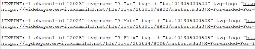

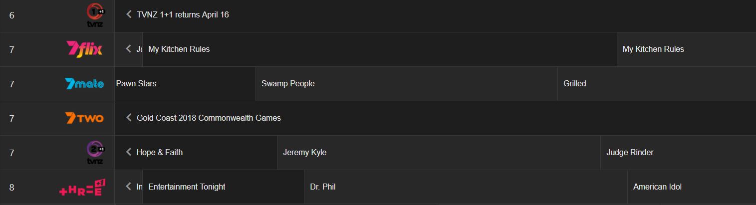

arrbee99 1836 Posted April 11, 2018 Posted April 11, 2018 Sounds the same as wot I'm getting. Have been adding and removing channels recently and changing channel numbers and while most are fine a few just won't cooperate... Downloaded a m3u list and added channel-id and changed the contents of the tvg-name for about 40 channels but for the above 3 channels (and 3 others) I get these extra 3 '7' channels that should be down in the 2000's - 2023 etc as number above Hopefully there's something really obvious somewhere...
