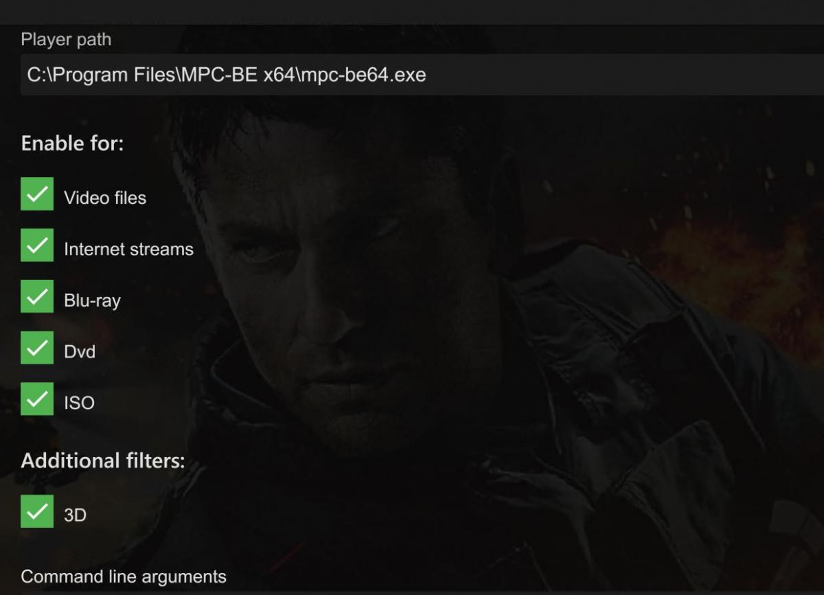

GhostRider 49 Posted April 9, 2018 Posted April 9, 2018 (edited) In the external player settings is enable for "Video Files" still checked? Edited April 9, 2018 by GhostRider
ausvette 2 Posted April 9, 2018 Author Posted April 9, 2018 Yes In fact I checked every setting there!

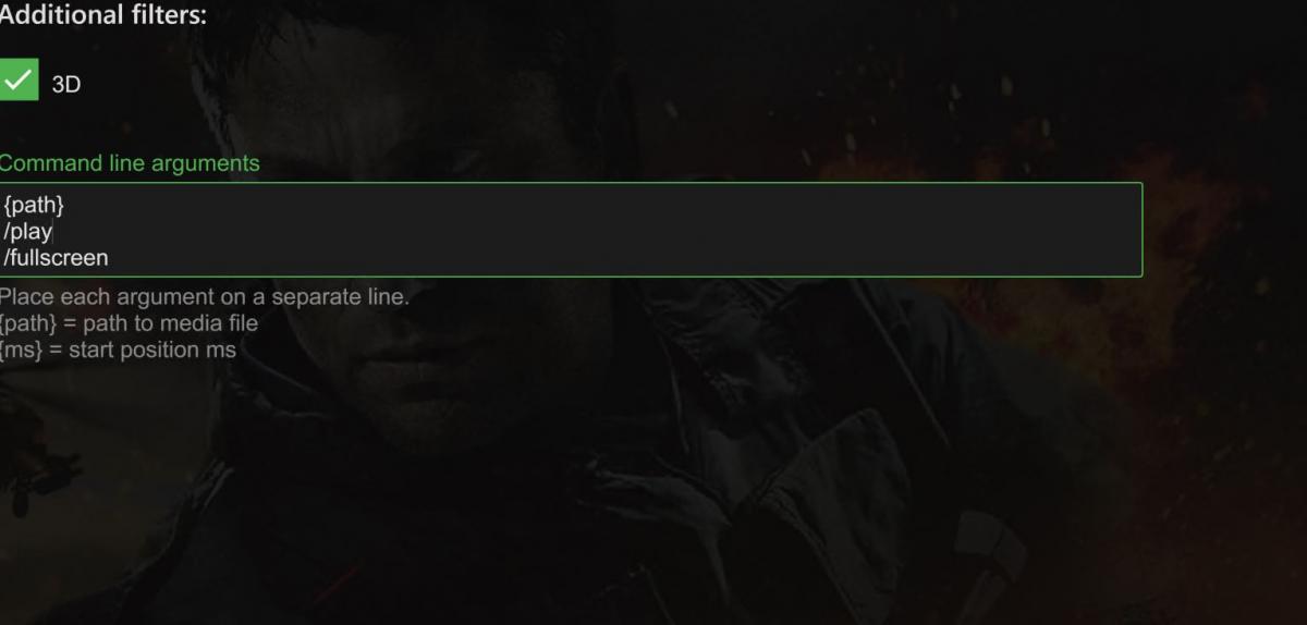

Luke 42243 Posted April 10, 2018 Posted April 10, 2018 Yes In fact I checked every setting there! Can you show a screenshot? thanks.
ausvette 2 Posted April 11, 2018 Author Posted April 11, 2018 Try unchecking 3D. Unchecking 3D results in mpc-be launching and plays. But on exit emby theater locks up just like it used with older versions of emby theater. I'm using mpc-be with madvr and lav filters. I thought this conflict problem between external player with madvr and lav filters with emby-theater was supposed to be fixed with 3.0.0?
