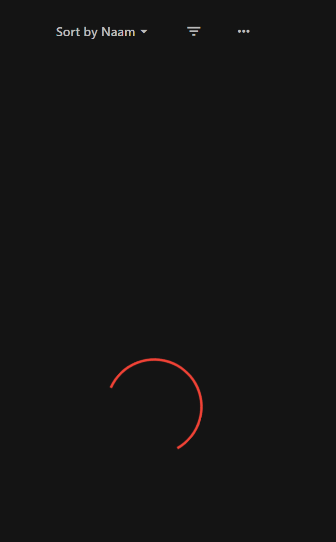

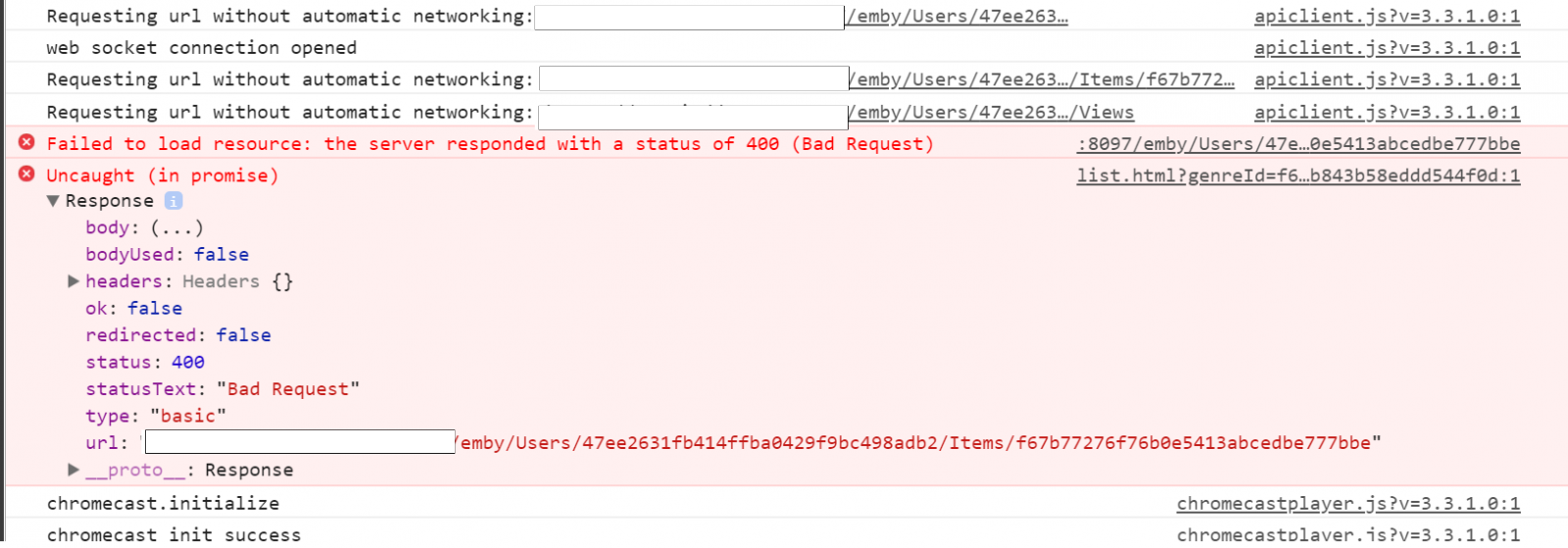

So I have a movie "Beauty and the Beast", he has 5 genres and one of them is "Music", when I click on the genre at the movie detail page I get a loading page (see screenshots), in the console I get a 400 without much information.
The 400 call that is going wrong is https://xxxxxxxxxxxxxx/emby/Users/47ee2631fb414ffba0429f9bc498adb2/Items/f67b77276f76b0e5413abcedbe777bbe get following response
Value cannot be null.
Parameter name: item
When I query the API for the movie I get 5 genres back and one of them has id f67b77276f76b0e5413abcedbe777bbe.

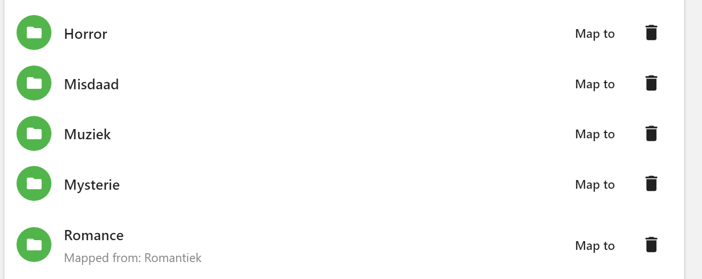

I also have the GenreCleaner plugin installed. And in the movie genre list there is no Music genre

Have you ran a library scan since that movie was added?
oke very strange. that fixed it!
The strange part is that I have this movie already some weeks in my library so there are already a lot of scans happened between now and then.
Thanks for the tip!
