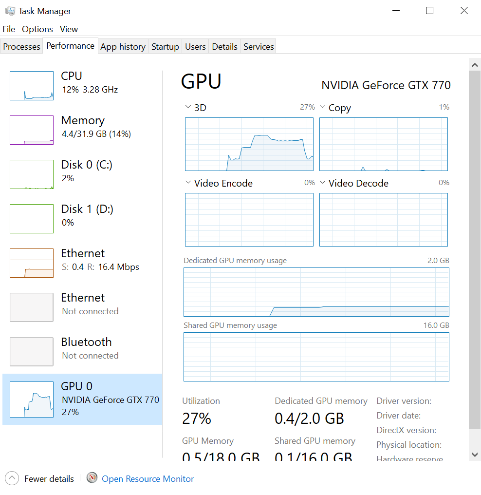

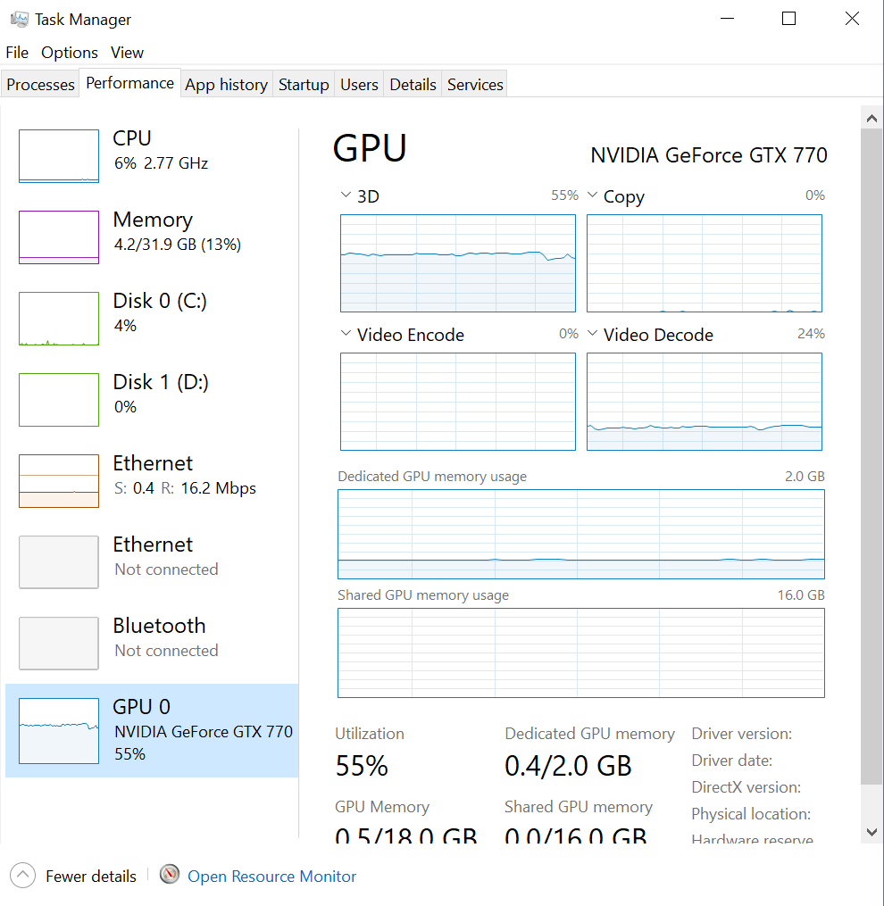

lifespeed 42 Posted May 11, 2018 Author Posted May 11, 2018 Actually, I'd like to see how this works with an Nvidia GPU. Can you try it? vf=d3d11vpp=deint=yes:interlaced-only=yes:mode=adaptive It works great! Smooth on both progressive content and 1080i Live TV. GPU usage is lowest at 22% with CUDA copyback, highest at 60% with AUTO or AUTO copyback. This is with an i7-6800K and GTX-770. Will try the other PC shortly.
Guest asrequested Posted May 11, 2018 Posted May 11, 2018 And it deinterlaced correctly, when set to CUDA? I was expecting that to not work. Although, you used Cuda-copyback, so that may be allowing the use of other filters.
Guest asrequested Posted May 11, 2018 Posted May 11, 2018 And you did remove the other deinterlace config from the mpv.conf?
lifespeed 42 Posted May 11, 2018 Author Posted May 11, 2018 And it deinterlaced correctly, when set to CUDA? I was expecting that to not work. Although, you used Cuda-copyback, so that may be allowing the use of other filters. Yes, it de-interlaced in all configurations. CUDA, CUDA copyback, AUTO, AUTO copyback. And you did remove the other deinterlace config from the mpv.conf? This is my mpv.conf file: log-file=C:\Users\User1\AppData\Roaming\mpv\Theater mpv log.txt vf=d3d11vpp=deint=yes:interlaced-only=yes:mode=adaptive
