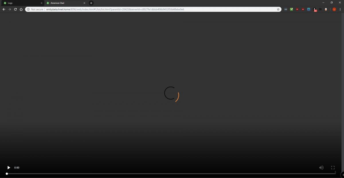

lharris 3 Posted December 12, 2018 Posted December 12, 2018 (edited) I set up a copy of Emby Beta tonight and gave the new ServerWMC plugin a try. Unfortunately it still didn't work, I'll outline everything I did below. Environment and Setup Cloned our current Emby VM to a new VM. Dropped the VM from the domain here at the house, renamed the host name to embybeta, changed IP, and rejoined to the domain Downloaded the beta and installed for Windows Server - Version 3.6.0.76, let all the plugins install and restarted Emby Installed ServerWMC plugin 1.1.9.0, it remembered the settings from the previous installation of the plugin (It's currently uninstalled on current server) and I verified the settings are correct Added A records to internal and external DNS for embybeta and updated the config for the reverse proxy everything runs behind. We use Split DNS in the house so SSL certs work everywhere using one URL. I will include caddy server configs and access/error logs. Changed the External domain in advanced settings to embybeta.hnet.online HTTP Server/URLS is enabled on ServerWMC Tests Test 1I clicked on a recorded show and received the never ending dual spinning circle, one black the other one changed colors. I noticed on the Windows Media Center box that ServerWMC reported it started to remux a stream. I looked through the log and noticed a lot of entries to http://embybeta.hnet.online:8096 which according to my reverse proxy configs is not a valid URL, by design.... I am accessing the server via HTTPS, why are non SSL requests being made to the HTTP port? I specifically set Secure Connection Mode to "Handled by reverse proxy" in Advanced settings. I guess I could make 8906 go through the reverse proxy, but I don't really want the server accessible externally unless it's with SSL.Either way all other functionality seemed to be ok... and I am not entirely sure the dns/8096 stuff is related to the ServerWMC problems as you can still see the nullreference exceptions, so while not entirely it's likely a red herring. Test 2To double check I changed the URL to it's internal host name: http://embybeta.hnet.home:8096 and went direct to the VM and attempted to watch the same recorded show I attempted to watch prior with no luck again. Included a set of logs Test 3I checked the "Enable debug logging" check box in the Logs section of the Admin page and repeated test 2. No change. Logs The individual logs I provided were downloaded from the Admin page right after each test. I'm including a zip of C:\Users\emby\AppData\Roaming\Emby-Server\programdata just in case. I also am including the caddy server reverse proxy config as well as access and error logs from the reverse proxy just in case. I hope this info is useful. I am going to continue messing around and see what I can provide. I will also make an attempt with out the URL Service on ServerWMC. https_Embybeta.hnet.online_Log.txt http_Embybeta.hnet.home_8906_Log_attempt2.txt http_Embybeta.hnet.home_8906_Log_Attempt_3_Debug_Logging_Enabled.txt Caddy Server Config.txt embybeta_access.log embybeta_error.log lharris_logs.zip Edited December 12, 2018 by lharris
lharris 3 Posted December 12, 2018 Posted December 12, 2018 (edited) OK, so I said screw it and updated the reverse proxy to allow 8096 just for Embybeta to see what happens. Here is a fresh set of logs as I shut down the server and removed/backed up the current set of logs to another location so that everything would be fresh. ServerWMC still doesn't work, and references in the log to the public HTTP port aren't showing 7000+ millisecond response times, but quick ones. I know its off topic, but I really would like to know why Emby hammers its HTTP port when you are accessing the server via HTTPS and if it really matters at all. Attached are a fresh set of logs where I started the server and immediately attempted to stream a recording from WMC, plus the updated Caddy config and Caddy logs, just in case you want to have a look see.... Next Step, I will turn off the URL service in ServerWMC and see if I can get it to work via some sort of direct access. The recordings on the WMC box are allowed read access anonymously via SMB...so perhaps it will work. embyserver.txt hardware_detection-63680174012.txt Updated Caddy Config.txt embybeta_http_access.log Edited December 12, 2018 by lharris
lharris 3 Posted December 12, 2018 Posted December 12, 2018 (edited) One last update for the night, sorry for the spam but I am attaching a new set of fresh logs each time. I unchecked "Use URLs instead of SMB/UNC paths for Recorded TV Playback" on ServerWMC and I verified anonymous access to the UNC path. I cleared the logs, restarted Emby, and attempted to watch a recorded show and received a Playback error, "No compatible streams are currently available. Please try again later or contact your system administrator for details" I checked through the logs and didn't find anything, but there was a lot of ffmpeg probe/spamming each .WTV file so I might have overlooked something useful. ffmpeg exited with 0 in each entry and 0 usually means everything is ok... so I assume ffmpeg can read each wtv file, confirming read access to the UNC path. Surprisingly... streaming live HDTV works just fine... I streamed channel 649, cartoon network from WMC/Ceton CableCARD tuner. See attached files again. I hope all of this is useful... embyserver.txt ffmpeg-transcode-edb08134-870c-43bf-b73a-91bcfcf5d84e_1.txt hardware_detection-63680175013.txt Edited December 12, 2018 by lharris
