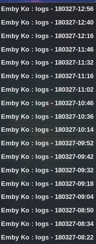

ElDitcho 0 Posted March 27, 2018 Posted March 27, 2018 Hello, My Emby-server keeps crashing every 30mn or so without doing anything. I've set a crontab script who kill process and restart emby if the home page isn't available (return code different from 200) and send me the log : I can't really remember when it started, 4 days i think. I've joined the last log, talking about ssl but my ssl certificate is ok until april 4th. Thx for your help server-63657751502.txt
