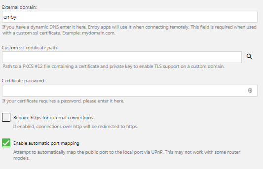

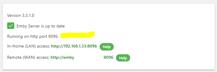

ubelong2matt 3 Posted March 15, 2018 Posted March 15, 2018 Greetings, First, I want to preface this by saying I've searched these forums and Google for the answer to this. I fear this is a Windows 10 issue but I refuse to believe that I'd be the only one having the problem so I'm not exactly sure what's going on. I've been running Emby Server on Windows 7 Ultimate, 64-bit for years now. It's my gaming rig and I wanted to get it on it's own dedicated computer so I fired up an older, decent desktop machine and installed Windows 10 Pro, 1709 64-bit on it. I thought that would be the hardest part, honestly. I run the backup plugin and read through the migration process so I figured this would be cake. I'd restore the most recent backup, switch the ports in my router to the IP of the new machine, and let my user base (friends/family) know they could use the service again after a library refresh. However, things did not seem to go as expected. I am running 3.3.1.0 on both machines. I have attached pictures for what I'm referring to but basically HTTPS isn't even an option for the Windows 10 machine. <== Windows 7, the current Emby server. <== Windows 10, the new one. I can see in each server startup log that my custom port, 8097, is in there. I can run netstat -abn and see that 8097 is listening. However, no matter what I do it doesn't offer HTTPS as even an option. Here's what I've tried: Tried to restart the machine because that's usually the place to start (been working in IT professionally for around 15-years now). Tried uninstalling and removing all evidence of Emby from the machine, reinstalling it, and skipping the backup restoration. I've checked the troubleshooting site for external connections and confirmed that externally, 8097 works (not my issue). I've tried shutting down the original Emby server (obviously given I was trying to migrate it) to see if it was a permissions thing. I'm at a loss for what to do next. Everything I find on these forums and online mentions "don't use self-signed certs." That's great and all but I can't even get to that point. I can't get Emby to even acknowledge it can do HTTPS. Is this some sort of security thing with duplicate premium keys or IPs? I don't plan on using both servers and fully intend to completely remove Emby from my Windows 7 machine once I have confirmed it is 100% operational on the Windows 10 machine. The only similar thing I've found online pertained to something unrelated to my issue. If you have any information, please share it. I'd really like to proceed with my migration but after hours of working on this I am at a loss. Thanks for your time, Matt
Solution Luke 42208 Posted March 15, 2018 Solution Posted March 15, 2018 Hi there, you need to go into the Advanced section and configure an SSL cert. Once you've set that up and restarted the server, then it should change. Please let us know if this helps. Thanks. 1
