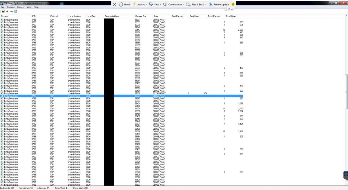

zirus 0 Posted March 19, 2018 Posted March 19, 2018 Hi, I've also been experiencing this for about a month now, https seems to fall over, but i'm still able to access it via http I seem to be able to kill the https connections if i leave emby paused for a while. What I have noticed is there seems to be a lot of ports that stuck in a state of "CLOSE_WAIT" eg There were about 3 pages that i saw before i restarted emby to get it working again. Here is also my log emby.txt
