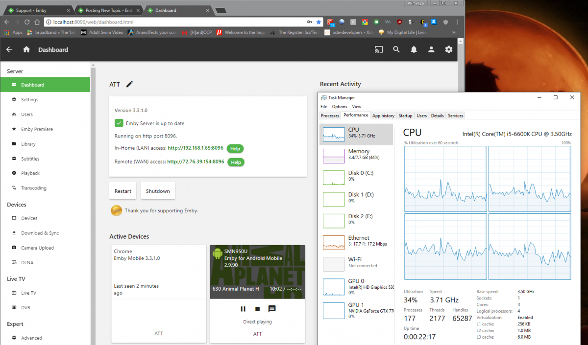

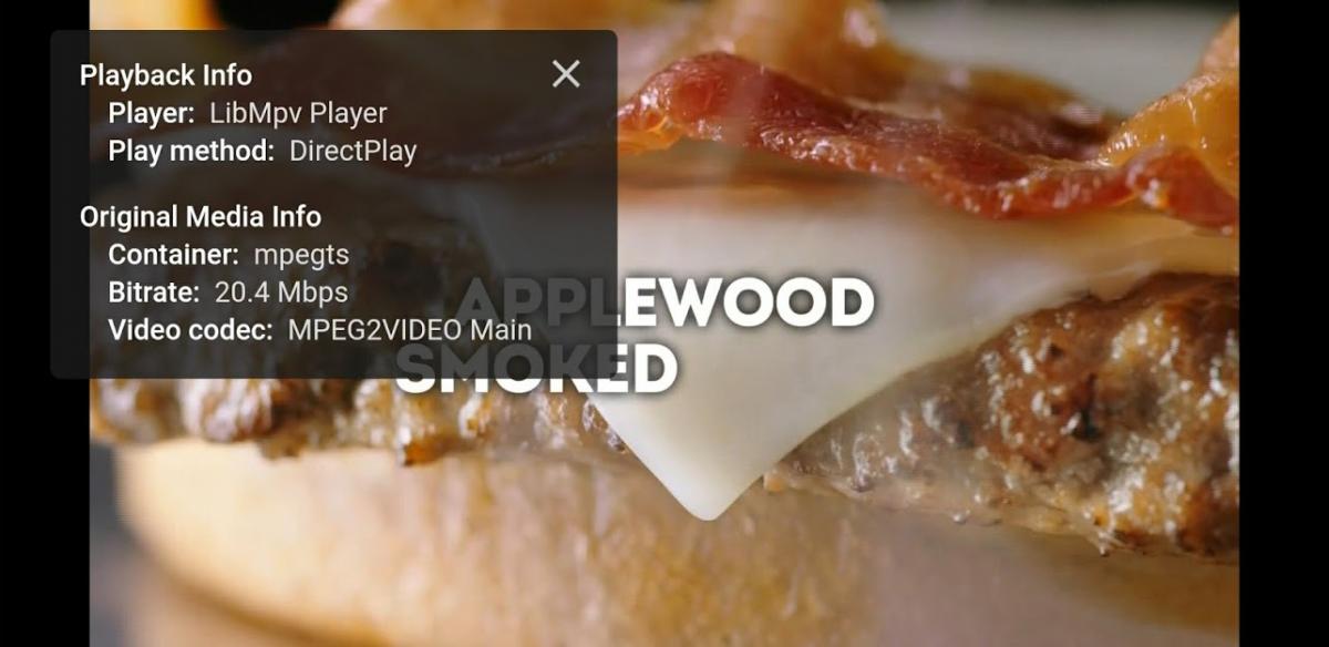

testing with just 1 device/stream its using 19% to 35% cpu to direct play on note 8 or mi box  streams are 1080i
"emby Server" process  19%-35% cpu and note 8 doing all the hard work  decoding  and playback

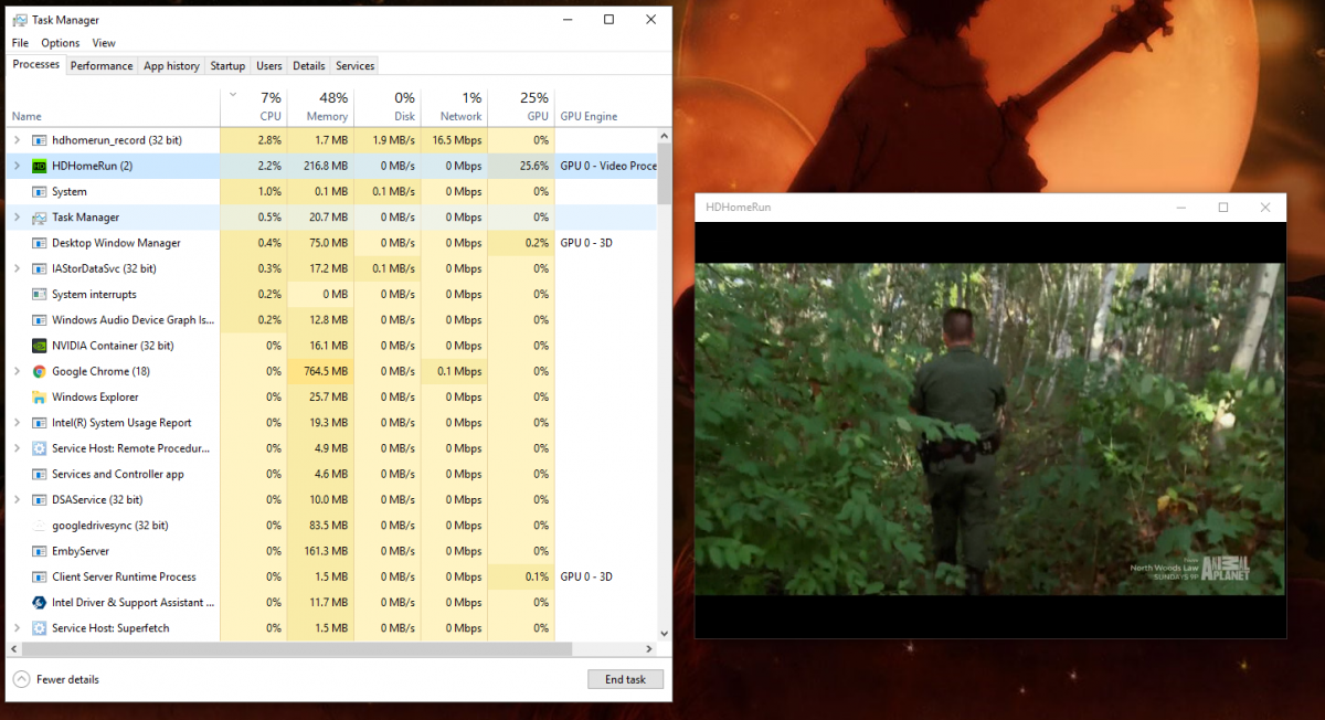

why does streaming it from direct from HDhomerun only consume under 3% cpu  while GPU takes care of decode and playback on PC and no hiccup with hdhomerun android app either
was hoping to hit 10% or lower  cpu per stream after all its doing forwarding video stream while leaving the PC usable to do other duties

attach log different channel same cpu usage
embyLog.txt

Hi, the guide refresh scheduled task is running in the background during this log. Try stopping that and see if that improves it.

updated log but according to  Scheduled Tasks it stop 20 min ago
and when i stop video it goes to 0% cpu usage
emby log2.txt
