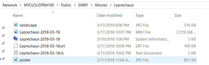

nyplayer 90 Posted March 19, 2018 Posted March 19, 2018 (edited) We already have this for movies, if the guide data has the release year. I have yet to see a movie named with the Year even though the Schedules Direct has the Year (date) on it. Maybe you need to get the year from Schedules Direct. <programme start="20180324140000 -0700" stop="20180324160000 -0700" channel="I3.10424.schedulesdirect.org"> <title lang="en">Leprechaun</title> <desc lang="en">An Irish fairy (Warwick Davis) escapes from a crate and goes on a gory quest for his 100 stolen gold coins.</desc> <credits> <director>Mark Jones</director> <actor>Warwick Davis</actor> <actor>Jennifer Aniston</actor> <actor>Ken Olandt</actor> <actor>Mark Holton</actor> <actor>John Sanderford</actor> <actor>Shay Duffin</actor> <actor>Pamela Mant</actor> <actor>Robert Gorman</actor> <actor>John Voldstad</actor> <actor>William Newman</actor> <actor>David Permenter</actor> <writer>Mark Jones</writer> <producer>Mark Amin</producer> <producer>Jeffrey B. Mallian</producer> </credits> <date>1993</date> <category lang="en">Comedy</category> <category lang="en">Horror</category> <category lang="en">Movie</category> <length units="minutes">92</length> <episode-num system="dd_progid">MV00036217.0000</episode-num> <subtitles type="teletext" /> <rating system="MPAA"> <value>R</value> </rating> <rating system="advisory"> <value>Adult Situations</value> </rating> <rating system="advisory"> <value>Language</value> </rating> <rating system="advisory"> <value>Graphic Violence</value> </rating> <star-rating> <value>2/4</value> </star-rating> </programme> Edited March 19, 2018 by nyplayer

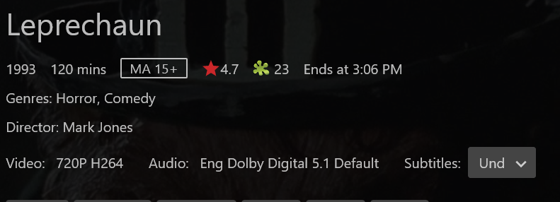

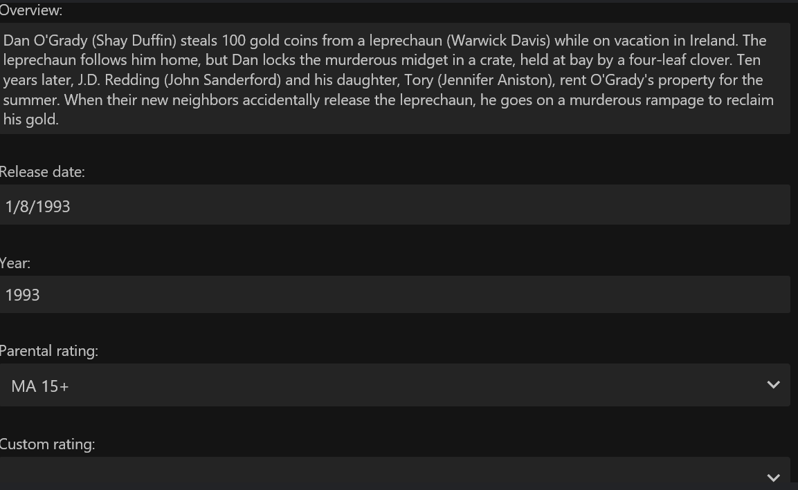

Luke 42208 Posted March 19, 2018 Posted March 19, 2018 It probably got the year afterwards with an internet metadata refresh. Before it records, check the program detail screen and see if there is a year on it.
nyplayer 90 Posted March 19, 2018 Posted March 19, 2018 (edited) It probably got the year afterwards with an internet metadata refresh. Before it records, check the program detail screen and see if there is a year on it. That xml was taken directly from schedules direct ... none of my movies have the year on the folder. Edited March 19, 2018 by nyplayer

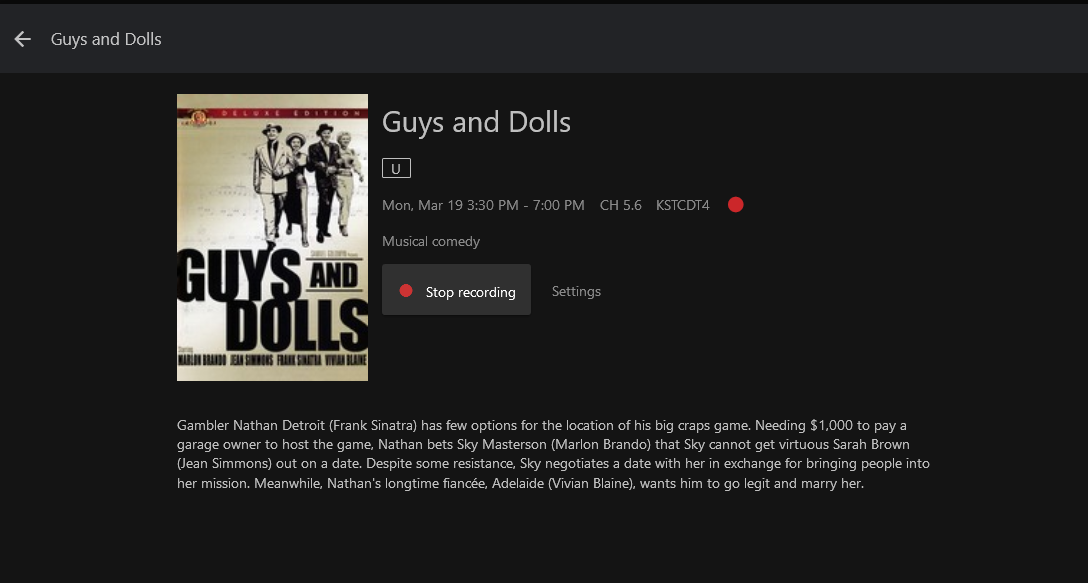

cybergrimes 93 Posted March 19, 2018 Author Posted March 19, 2018 (edited) I have yet to see a movie named with the Year even though the Schedules Direct has the Year (date) on it. Maybe you need to get the year from Schedules Direct. Are you having an issue with it matching movies for metadata, if not, what's the concern with having in the folder/file name since the front end is Emby anyway? @@Luke, I'd be more interested in seeing the EPG presented release year in the UI when I'm browsing for movies to watch/record For example this movie airing right now, Schedules Direct gives the year of 1955 in the data but not visible in guide/info screen: <program id='MV000003050000'> <title>Guys and Dolls</title> <mpaaRating>NR</mpaaRating> <starRating>***</starRating> <runTime>PT02H30M</runTime> <year>1955</year> <description>A Broadway gambler (Frank Sinatra) bets that a Runyonesque high roller (Marlon Brando) cannot take a sidewalk soul-saver (Jean Simmons) on a date to Havana.</description> </program> Edited March 19, 2018 by cybergrimes

nyplayer 90 Posted March 19, 2018 Posted March 19, 2018 (edited) We do show it, when we have the data. Never mind it has the data it is just not working ... if it is in the guide data then you have it before you even start recording. You are just not parsing it. That is a problem when movies are resurrected for Ex. The Day The Earth Stood still. I will use MCEBUDDY to rename them with the year. Edited March 19, 2018 by nyplayer 1
cybergrimes 93 Posted March 19, 2018 Author Posted March 19, 2018 (edited) Never mind it has the data it is just not working ... if it is in the guide data then you have it before you even start recording. You are just not parsing it. That is a problem when movies are resurrected for Ex. The Day The Earth Stood still. I will use MCEBUDDY to rename them with the year. Oh ok same problem as TV series had prior to this thread, makes sense. Luke did you see my screenshot with example right out of my Schedules Direct data feed where the year is present? Directory created without year upon recording and no year is visible when viewing live TV guide screens Edited March 19, 2018 by cybergrimes
