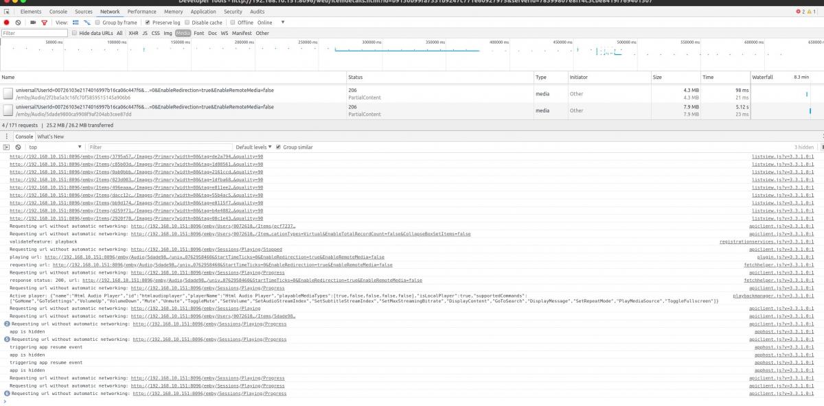

wedgekc 12 Posted March 11, 2018 Posted March 11, 2018 I have the same issue (console screenshot included). Recently, I noticed playlists in Chrome are not moving to the next song and I have to click the forward button to play the next song in the playlist. Firefox works fine though. I also run in docker bridge mode.
Luke 42212 Posted March 11, 2018 Posted March 11, 2018 Thanks for the report. I have been testing this every step of the way but haven't been able to reproduce thus far.
wedgekc 12 Posted March 12, 2018 Posted March 12, 2018 Updated to the latest version of Chrome (Version 65.0.3325.146) and so far so good. I'll report back if I run into the issue again.
wedgekc 12 Posted March 14, 2018 Posted March 14, 2018 Unfortunately, Started having the issue again yesterday.
