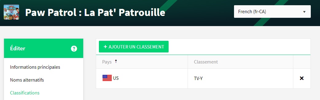

Happy2Play 9802 Posted March 3, 2018 Posted March 3, 2018 (edited) Most of these issue will probably come down to the shows not having parental codes for specific localization. TMDB example of only one rating (community driven) Edited March 3, 2018 by Happy2Play
