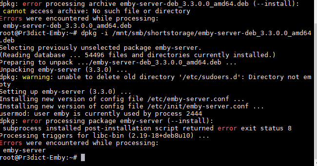

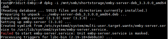

pr3dict 33 Posted March 3, 2018 Author Posted March 3, 2018 so i killed the process that was using emby but now its saying the procss is masked. Whats that all about...
