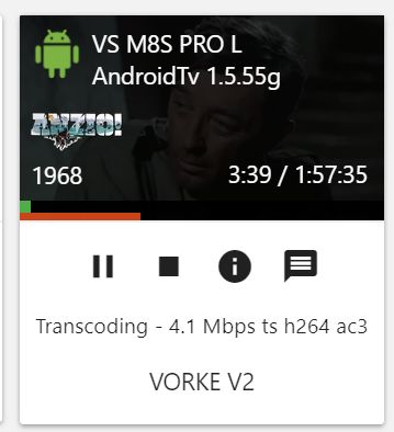

clarkss12 304 Posted March 1, 2018 Posted March 1, 2018 (edited) Been testing my client to see why some videos are transcoding. As I recall, they all used to Direct Play, not some of them are transcoding. I am going to use the video "Anzio" for my example. I am using my Mecool M8S Pro L (Amlogic S912) for my client and Vorke V2 (Windows 10) as my server. The message says it is transcoding because it is interlaced video, I don't believe it. Attached is the codec info for this video file. Anzio codec.txt Anzio server log.txt ffmpeg for Anzio log.txt Edited March 1, 2018 by clarkss12
ebr 16337 Posted March 1, 2018 Posted March 1, 2018 I believe you are on the beta? If so, there are now options in the playback settings for whether or not content should be de-interlaced on the server. From our media info: "DisplayTitle":"480I MPEG2VIDEO","IsInterlaced":true
clarkss12 304 Posted March 1, 2018 Author Posted March 1, 2018 (edited) I believe you are on the beta? If so, there are now options in the playback settings for whether or not content should be de-interlaced on the server. From our media info: "DisplayTitle":"480I MPEG2VIDEO","IsInterlaced":true That solved the problem, UNchecked that option, now it plays with Direct Play. Thanks. Edited March 1, 2018 by clarkss12
