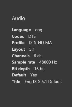

GhostRider 49 Posted March 1, 2018 Author Posted March 1, 2018 This is an example form my collection: At my limit of audio knowledge: what is the difference between a Profile and a Codec? How can I get the Codec intro to pick the "dts-hd ma.mkv" Codec intro
Guest asrequested Posted March 1, 2018 Posted March 1, 2018 I wonder if thats the problem. The profile and codec aren't the same. The server may be going by codec and not the profile. What you see there is what ffprobe is returning. That might be why it isn't working.
GhostRider 49 Posted March 1, 2018 Author Posted March 1, 2018 I am not an expert but I believe DTS-HD MA is a track on top of DTS to add the parts removed and they are combined to create the lossless sound. Maybe somebody can confirm Is Emby able to play the DTS-HD MA audio or just the DTS Core track?
Guest asrequested Posted March 1, 2018 Posted March 1, 2018 Yeah, the core codec is dts, and then there are dts profiles. So it looks like the server is using the core codec to match to, instead of the profile. Using the profile might also allow the ability to distinguish Atmos. But that is metadata, so I'm not sure ffprobe will see that. Emby Theater desktop can play everything, that's what I use as to test.

GhostRider 49 Posted March 1, 2018 Author Posted March 1, 2018 (edited) Not sure Emby Theatre can play DTS-HD MA. This is what I see for a movie with DTS-HD MA as the primary track when I select the audio version drop down: No DTS-HD MA! Looks to me like Emby is only able to play the DTS Core track and not the lossless -HS MA version. @@Luke can you confirm if Emby can play DTS-HD MA please? I get the DTS.mkv Codec Intro not DTS-HS MA intro in both Browser and Emby Theatre. Edited March 1, 2018 by GhostRider
ebr 16310 Posted March 1, 2018 Posted March 1, 2018 Not sure Emby Theatre can play DTS-HD MA. This is what I see for a movie with DTS-HD MA as the primary track when I select the audio version drop down: No DTS-HD MA! Looks to me like Emby is only able to play the DTS Core track and not the lossless -HS MA version. @@Luke can you confirm if Emby can play DTS-HD MA please? I get the DTS.mkv Codec Intro not DTS-HS MA intro in both Browser and Emby Theatre. That is just the display and it is the same reason why the codec intro isn't being found. The app will have to look at both codec and profile and then build an appropriate display string based on the two and also use that when looking for intros. The Android TV and Roku apps should already be doing this. Just needs to be put in Theater (and the server I guess for codec intro matching).
