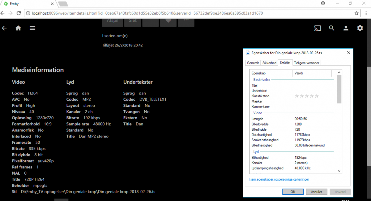

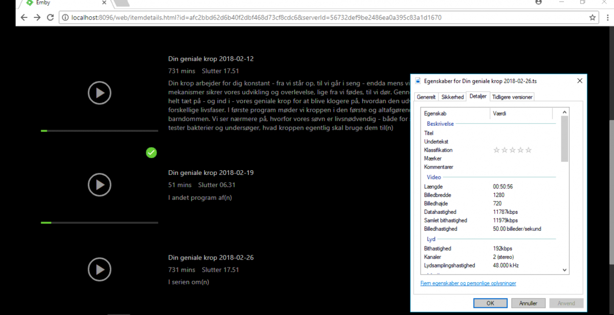

Jennice 19 Posted February 26, 2018 Posted February 26, 2018 Hi all, Can someone please post a screen shot of (working) regional (country) settings in numbers / formats? Some of my recordings get a much too low video bit rate in Emby (the meta data on the TS file itself seems OK, and it plays in Windows TV and other apps). With the bit rate too low, the displayed length of a duration is in excess of 730 minutes, rather than the correct 50 minutes. Also, for playback, the resolution is (force-transcoded?) to really low quality. Is there a way to manually edit the bit rate info (and other recording description, which is also corrupt in Emby) I am thinking that since the TS stream file has correct bit rate data, Emby must get its info from somewhere else (but where?), and probably interpret it incorrectly. This truncates my description of the recording, and gives a wrong stated bit rate (which Emby uses as limit for playback). Maybe regional settings cause mis-match between commas, punctuations, and thousand-seperators.

Jennice 19 Posted February 27, 2018 Author Posted February 27, 2018 I'm running 3.2.60 as 3.2.70 broke the recording of some channels. But if I have a regional setting issue, it's not changing by version. The TS file info says approx. 50 minutes. Emby says 731 minutes. 2 of 3 recordings have messed up Meta data. Notice the bit rate (danish: Datahastighed) is wrong in Emby,
Luke 42206 Posted February 27, 2018 Posted February 27, 2018 It's not regional. We've seen ffprobe occasionally produce incorrect values with .ts recordings.
