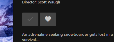

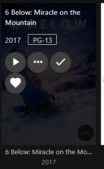

DrCornelius 1 Posted February 26, 2018 Posted February 26, 2018 Hi! I'm developing a channel for my own personal use and before the last update I was able to populate GetChannelItems without adding MediaSources for the item, I was using GetChannelItemMediaInfo because I don't have any information about the media before calling it. Now I need to add MediaSources (GetChannelItems) for it to work and ends up transcoding even after the callback (GetChannelItemMediaInfo) received the info. Also the play button isn't showing inside the item details, only in the listing. Another thing, is it possible to make the video resumable if I send the duration? Thanx

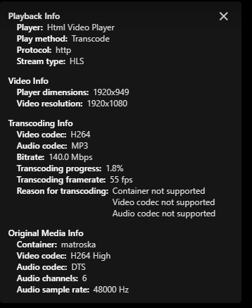

DrCornelius 1 Posted February 27, 2018 Author Posted February 27, 2018 Before the update I would get most videos played directly or at lest direct streamed, but now it's always transcoding. It seems that the info (MediaStreams) from the callback (GetChannelItemMediaInfo) is only being used to show audios tracks and subtitles, and the info (MediaSources) from the listing (GetChannelItems) to create the ffmpeg call. If I stop the video in the middle, it gets marked as finished/seen and I can't resume it (the last version had the same issue).

Luke 42253 Posted February 27, 2018 Posted February 27, 2018 Can you try setting the container to mkv? I thought we were normalizing using matroska that but it's possibly not happening at all levels.
Luke 42253 Posted February 27, 2018 Posted February 27, 2018 By the way if you're using the callback for the purpose of running ffprobe, then i would not do that. What it's intended for is situations where you don't have a media url until the time of playback. Like for example, something that requires a temporary authorization. So yes this means it will transcode but I wouldn't harp on that for now. It you set SupportsProbing = true, then in an upcoming update i'm planning on utilizing that at play time to probe for media info.
DrCornelius 1 Posted February 27, 2018 Author Posted February 27, 2018 (edited) I'm using the callback because I do need an authorization and I can't infer any information about the file/URL before that, I have a server proxying the whole process and redirecting to the final URL, that's why is an internal IP. I'm probing the file to avoid transcoding and to get the actually file size, codecs, container, tracks etc. ffmpeg-transcode-67291619-b1ca-4916-874b-949ae64e9d8e.txt Edited February 27, 2018 by DrCornelius
Luke 42253 Posted February 27, 2018 Posted February 27, 2018 Ok, I would remove the probe and just wait for me to do the work that I've mentioned. Thanks.
