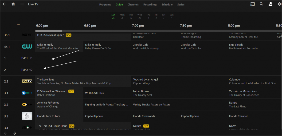

jlam1021 2 Posted February 25, 2018 Posted February 25, 2018 Hello Everyone, Working on setting up my Emby server I have hdhomerun and am using zap2it and xmltv.xml to download the guide - Originally I downloaded all the channels for my area but then switched to just favorites but I cant get the guide to update and remove the old channels. To further complicate the guide I was testing some M3U tuner setup which I have deleted but all of those channels are showing in the guide also - just the channel no program info. I have tried refreshing the guide - updating the channels and nothing is working. I found this in a post on the forum - go to %appdata%\Emby-Server\data\livetv and delete the entire 'epg' folder and then refresh your guide again. but I dont have this folder in appdata. Any help would be much appreciated. Thanks!

jlam1021 2 Posted February 25, 2018 Author Posted February 25, 2018 Hi Luke, I re ran the refresh guide and it completed - same issue. I attached a screenshot of the guide and also the latest log. Thanks log.txt

jlam1021 2 Posted February 25, 2018 Author Posted February 25, 2018 Ok I deleted that and the iptv plugin - restarted and then refreshed the guide - The only tuner I have is the HD Homerun. It is still picking up channels fro what looks like the M3U tuner I had set up and then deleted. Attached the screenshot. Is there a cache that needs to be deleted?
jlam1021 2 Posted February 25, 2018 Author Posted February 25, 2018 Hi I still had the M3U File in a folder on the computer - I delteed that and refreshed the guide and now its gone. Thanks for your help!
