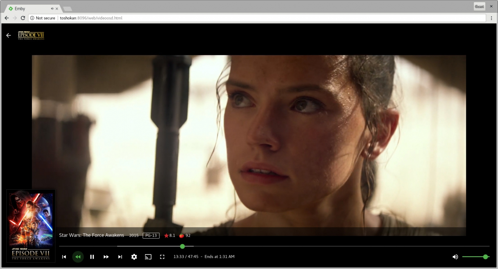

AceBlade258 3 Posted February 25, 2018 Posted February 25, 2018 When playing a video on literally anything, if the title is being transcoded the timestamp is incorrect. It will say the total length of the title is only the amount transcoded; so initially 2+ hour movies show as being ~10-15 seconds long. It grows over time, but rarely gets more than ~10-15 minutes ahead. Another problem is that if playback stops unexpectedly (i.e. pause too long, and the connection times out), you cannot seek back to the same place in the title you were previously in, and cannot resume playback. it really puts a damper on watching a movie. Any help would be appreciated; I'm not seeing any errors in the logs that look like they would be related, and as far as I can tell this should work just fine. Thanks in advanced! PS: I'm running version 3.3.0.0 on CentOS 7 - this issue has been around since installation, so I doubt it's version related.

AceBlade258 3 Posted February 25, 2018 Author Posted February 25, 2018 Here's a shot from first starting playback: A few minutes later: Lastly from a bit further in playback (it is managing to get further than I remembered, in terms of duration):

Luke 42245 Posted February 26, 2018 Posted February 26, 2018 Ok, there's no obvious problem here, but I think I can guess what happened. Your server was installed using our legacy installation package, which requires you to setup your own ffmpeg build. I am guessing you might not have had that in place before importing your library and as a result the server was unable to probe your files for media info. What you can try to do as a test is go back to the detail screen of the video from the log you just posted. Click the 3-dot menu -> refresh metadata. Then give it a couple seconds and refresh the screen, and see if you have more media info displayed (including a runtime). Then try to play again.
AceBlade258 3 Posted February 26, 2018 Author Posted February 26, 2018 That appears to have done the trick! I could have sworn I had refreshed the library metadata since reinstallation, but c'est la vie. I'll try to refresh the whole libraries metadata and report back the results.
