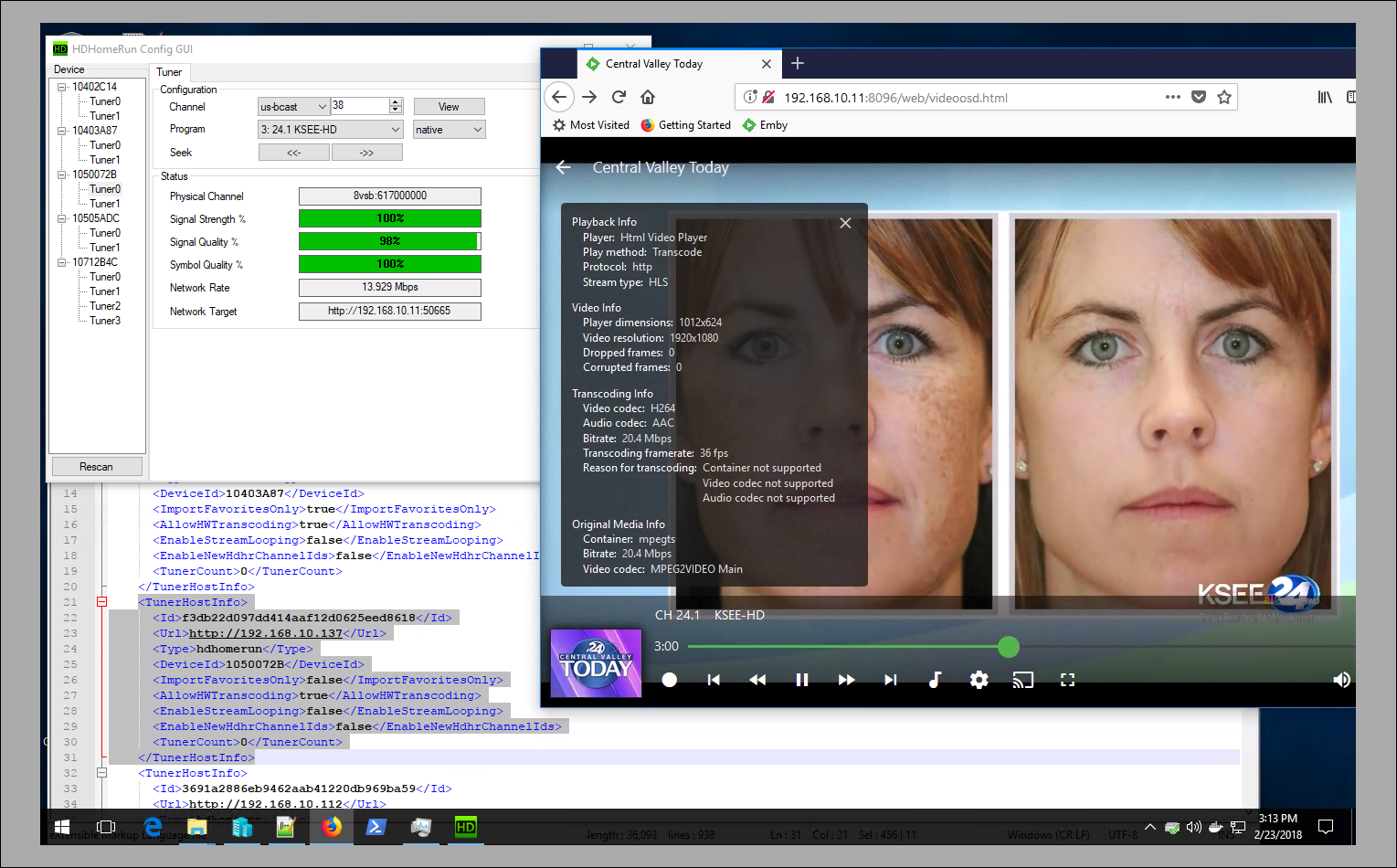

snake98 10 Posted February 23, 2018 Posted February 23, 2018 (edited) I'm having a problem with live tv maxing out a i5-6600k cpu. With only one stream coming from an hdhr4. I've tried hardware decoding and encoding disabled and enabled, but still have problems. I notice and attached a screen shot where incoming mpbs was 20.4 mpegts and transcoding it to 140mbps x264. I"m thinking that may be the problem. I have no other problems trans-coding pauses x264 files or x265 files to roku or firefox. settings Transcoding threads set to auto Enabled throttling checked H264 encoding CRF:23 H264 encoding preset:medium and i've tried auto logs (removed) Edited March 2, 2018 by snake98
Luke 42244 Posted February 23, 2018 Posted February 23, 2018 Hi, it's not transcoding to 140. We are only using that as a Max value

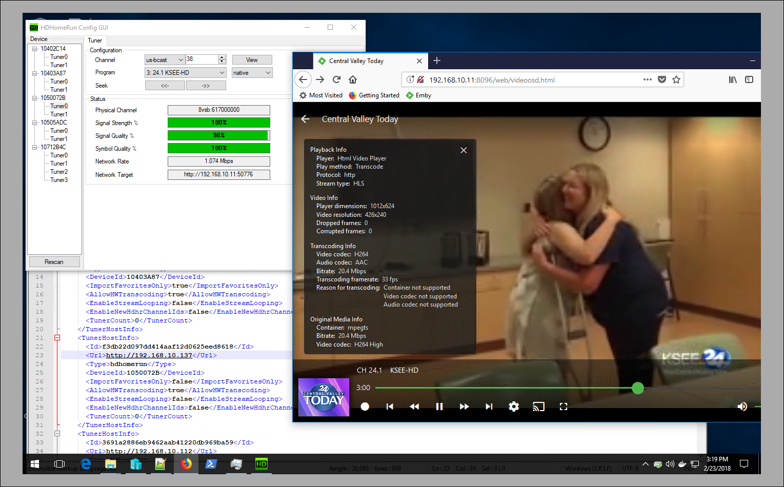

snake98 10 Posted February 23, 2018 Author Posted February 23, 2018 This isn't true. I believe a pictures and logs will disagree with you :-) I changed the "Default Transcode Profile" on the tuner, look at the bit rates and codecs 2018-02-23 15:18:54.993 Application version: 3.2.70.0 http://192.168.10.11:8096/emby/videos/05eaaa362512bb13f93fb02d33f6781c/live.m3u8?DeviceId=b459f6f9b9c43cca1f1fed40ebeb36f0f679ff01&MediaSourceId=624e42c2b77d439ca60b7964cb6f224d_native_d620f4e5b254c1339525e144a731ac1e_fd7c04607a23e01f7347f5045a4e48cd&VideoCodec=h264&AudioCodec=aac&AudioStreamIndex=-1&VideoBitrate=139616000&AudioBitrate=384000&PlaySessionId=64b5fc0ecc3a4e2e86cb04388c4268e9&api_key=5d477ad2c341423fa32da415ced143c2&LiveStreamId=a17c75760a04e99b68cf766e11316e1c_09efa0d56b934a82adec00a87b837fb0_624e42c2b77d439ca60b7964cb6f224d_native_d620f4e5b254c1339525e144a731ac1e_fd7c04607a23e01f7347f5045a4e48cd&CopyTimestamps=false&TranscodingMaxAudioChannels=2&EnableSubtitlesInManifest=false&RequireAvc=true&RequireNonAnamorphic=false&SegmentContainer=ts&MinSegments=1&BreakOnNonKeyFrames=True&TranscodeReasons=ContainerNotSupported,VideoCodecNotSupported,AudioCodecNotSupported&h264-profile=high,main,baseline,constrainedbaseline&h264-level=51&h264-deinterlace=true {"Protocol":"Http","Id":"624e42c2b77d439ca60b7964cb6f224d_native_d620f4e5b254c1339525e144a731ac1e_fd7c04607a23e01f7347f5045a4e48cd","Path":"http://127.0.0.1:8096/LiveTv/LiveStreamFiles/51573ae1732e49baba080c74ff713baf/stream.ts","Type":"Default","Container":"mpegts","IsRemote":false,"ReadAtNativeFramerate":false,"IgnoreDts":true,"IgnoreIndex":false,"GenPtsInput":false,"SupportsTranscoding":true,"SupportsDirectStream":true,"SupportsDirectPlay":false,"IsInfiniteStream":true,"RequiresOpening":true,"RequiresClosing":true,"LiveStreamId":"a17c75760a04e99b68cf766e11316e1c_09efa0d56b934a82adec00a87b837fb0_624e42c2b77d439ca60b7964cb6f224d_native_d620f4e5b254c1339525e144a731ac1e_fd7c04607a23e01f7347f5045a4e48cd","BufferMs":0,"RequiresLooping":false,"SupportsProbing":true,"MediaStreams":[{"Codec":"h264","TimeBase":"1/90000","CodecTimeBase":"1001/60000","DisplayTitle":"H264","NalLengthSize":"0","IsInterlaced":false,"IsAVC":false,"BitDepth":8,"RefFrames":1,"IsDefault":false,"IsForced":false,"Height":240,"Width":352,"AverageFrameRate":29.97003,"RealFrameRate":29.97003,"Profile":"High","Type":"Video","AspectRatio":"16:9","Index":0,"IsExternal":false,"IsTextSubtitleStream":false,"SupportsExternalStream":false,"PixelFormat":"yuv420p","Level":40,"IsAnamorphic":false},{"Codec":"ac3","TimeBase":"1/90000","CodecTimeBase":"1/48000","DisplayTitle":"Dolby Digital 5.1","IsInterlaced":false,"ChannelLayout":"5.1","BitRate":384000,"Channels":6,"SampleRate":48000,"IsDefault":false,"IsForced":false,"Type":"Audio","Index":1,"IsExternal":false,"IsTextSubtitleStream":false,"SupportsExternalStream":false,"Level":0}],"Formats":[],"Bitrate":384000,"RequiredHttpHeaders":{},"AnalyzeDurationMs":3000} User policy for snake98: EnablePlaybackRemuxing: True EnableVideoPlaybackTranscoding: True EnableAudioPlaybackTranscoding: True C:\Users\Snake98\AppData\Roaming\Emby-Server\system\ffmpeg.exe -analyzeduration 3000000 -fflags +igndts -f mpegts -i "http://127.0.0.1:8096/LiveTv/LiveStreamFiles/51573ae1732e49baba080c74ff713baf/stream.ts" -map_metadata -1 -map_chapters -1 -threads 0 -map 0:0 -map 0:1 -map -0:s -codec:v:0 libx264 -pix_fmt yuv420p -preset medium -crf 23 -maxrate 139616000 -bufsize 279232000 -profile:v high -level 4.1 -x264opts:0 subme=0:me_range=4:rc_lookahead=10:me=dia:no_chroma_me:8x8dct=0:partitions=none -force_key_frames "expr:gte(t,n_forced*3)" -flags -global_header -vsync cfr -codec:a:0 aac -strict experimental -ac 2 -ab 384000 -f segment -max_delay 5000000 -avoid_negative_ts disabled -start_at_zero -segment_time 3 -individual_header_trailer 0 -segment_format mpegts -segment_list_entry_prefix "hls/1d69787a0602ce3c13291a7a9debd9d8/" -segment_list_type m3u8 -segment_start_number 0 -segment_list "z:\transcoding-temp\1d69787a0602ce3c13291a7a9debd9d8.m3u8" -y "z:\transcoding-temp\1d69787a0602ce3c13291a7a9debd9d8%d.ts" ffmpeg version git-2017-12-31-2906363 Copyright (c) 2000-2017 the FFmpeg developers built with gcc 7.2.0 (GCC) configuration: --enable-gpl --enable-version3 --enable-sdl2 --enable-bzlib --enable-fontconfig --enable-gnutls --enable-iconv --enable-libass --enable-libbluray --enable-libfreetype --enable-libmp3lame --enable-libopencore-amrnb --enable-libopencore-amrwb --enable-libopenjpeg --enable-libopus --enable-libshine --enable-libsnappy --enable-libsoxr --enable-libtheora --enable-libtwolame --enable-libvpx --enable-libwavpack --enable-libwebp --enable-libx264 --enable-libx265 --enable-libxml2 --enable-libzimg --enable-lzma --enable-zlib --enable-gmp --enable-libvidstab --enable-libvorbis --enable-libvo-amrwbenc --enable-libmysofa --enable-libspeex --enable-amf --enable-cuda --enable-cuvid --enable-d3d11va --enable-nvenc --enable-dxva2 --enable-avisynth --enable-libmfx libavutil 56. 7.100 / 56. 7.100 libavcodec 58. 9.100 / 58. 9.100 libavformat 58. 3.100 / 58. 3.100 libavdevice 58. 0.100 / 58. 0.100 libavfilter 7. 8.100 / 7. 8.100 libswscale 5. 0.101 / 5. 0.101 libswresample 3. 0.101 / 3. 0.101 libpostproc 55. 0.100 / 55. 0.100 Input #0, mpegts, from 'http://127.0.0.1:8096/LiveTv/LiveStreamFiles/51573ae1732e49baba080c74ff713baf/stream.ts': Duration: N/A, start: 41760.234144, bitrate: N/A Program 3 Stream #0:0[0x31]: Video: h264 (High) ([27][0][0][0] / 0x001B), yuv420p(tv, progressive), 352x240 [SAR 40:33 DAR 16:9], Closed Captions, 29.97 fps, 29.97 tbr, 90k tbn, 59.94 tbc Stream #0:1[0x34]: Audio: ac3 ([129][0][0][0] / 0x0081), 48000 Hz, 5.1(side), fltp, 384 kb/s Stream mapping: Stream #0:0 -> #0:0 (h264 (native) -> h264 (libx264)) Stream #0:1 -> #0:1 (ac3 (native) -> aac (native)) Press [q] to stop, [?] for help [libx264 @ 0000025b20907480] using SAR=40/33 [libx264 @ 0000025b20907480] VBV bitrate (139616) > level limit (50000) [libx264 @ 0000025b20907480] VBV buffer (279232) > level limit (62500) [libx264 @ 0000025b20907480] using cpu capabilities: MMX2 SSE2Fast SSSE3 SSE4.2 AVX FMA3 BMI2 AVX2 [libx264 @ 0000025b20907480] profile Main, level 4.1 [segment @ 0000025b209c96c0] Opening 'z:\transcoding-temp\1d69787a0602ce3c13291a7a9debd9d80.ts' for writing Output #0, segment, to 'z:\transcoding-temp\1d69787a0602ce3c13291a7a9debd9d8%d.ts': Metadata: encoder : Lavf58.3.100 Stream #0:0: Video: h264 (libx264), yuv420p, 352x240 [SAR 40:33 DAR 16:9], q=-1--1, 29.97 fps, 90k tbn, 29.97 tbc Metadata: encoder : Lavc58.9.100 libx264 Side data: cpb: bitrate max/min/avg: 139616000/0/0 buffer size: 279232000 vbv_delay: -1 Stream #0:1: Audio: aac (LC), 48000 Hz, stereo, fltp, 384 kb/s Metadata: encoder : Lavc58.9.100 aac [segment @ 0000025b209c96c0] Opening 'z:\transcoding-temp\1d69787a0602ce3c13291a7a9debd9d8.m3u8.tmp' for writing [segment @ 0000025b209c96c0] Opening 'z:\transcoding-temp\1d69787a0602ce3c13291a7a9debd9d81.ts' for writing frame= 121 fps=0.0 q=29.0 size=N/A time=00:00:04.13 bitrate=N/A dup=20 drop=0 speed=8.26x frame= 177 fps=158 q=29.0 size=N/A time=00:00:06.03 bitrate=N/A dup=20 drop=0 speed= 5.4x frame= 191 fps=118 q=29.0 size=N/A time=00:00:06.50 bitrate=N/A dup=20 drop=0 speed=4.02x [segment @ 0000025b209c96c0] Opening 'z:\transcoding-temp\1d69787a0602ce3c13291a7a9debd9d8.m3u8.tmp' for writing [segment @ 0000025b209c96c0] Opening 'z:\transcoding-temp\1d69787a0602ce3c13291a7a9debd9d82.ts' for writing frame= 219 fps=100 q=29.0 size=N/A time=00:00:07.44 bitrate=N/A dup=20 drop=0 speed=3.41x frame= 234 fps= 87 q=29.0 size=N/A time=00:00:07.91 bitrate=N/A dup=20 drop=0 speed=2.95x frame= 236 fps= 74 q=29.0 size=N/A time=00:00:07.97 bitrate=N/A dup=20 drop=0 speed= 2.5x frame= 250 fps= 68 q=29.0 size=N/A time=00:00:08.46 bitrate=N/A dup=20 drop=0 speed=2.29x frame= 268 fps= 64 q=29.0 size=N/A time=00:00:09.04 bitrate=N/A dup=20 drop=0 speed=2.15x [segment @ 0000025b209c96c0] Opening 'z:\transcoding-temp\1d69787a0602ce3c13291a7a9debd9d8.m3u8.tmp' for writing [segment @ 0000025b209c96c0] Opening 'z:\transcoding-temp\1d69787a0602ce3c13291a7a9debd9d83.ts' for writing frame= 296 fps= 61 q=29.0 size=N/A time=00:00:10.02 bitrate=N/A dup=20 drop=0 speed=2.08x frame= 312 fps= 54 q=29.0 size=N/A time=00:00:10.51 bitrate=N/A dup=20 drop=0 speed=1.83x frame= 331 fps= 53 q=29.0 size=N/A time=00:00:11.15 bitrate=N/A dup=20 drop=0 speed=1.78x frame= 345 fps= 50 q=29.0 size=N/A time=00:00:11.62 bitrate=N/A dup=20 drop=0 speed=1.69x frame= 362 fps= 49 q=29.0 size=N/A time=00:00:12.18 bitrate=N/A dup=20 drop=0 speed=1.65x [segment @ 0000025b209c96c0] Opening 'z:\transcoding-temp\1d69787a0602ce3c13291a7a9debd9d8.m3u8.tmp' for writing [segment @ 0000025b209c96c0] Opening 'z:\transcoding-temp\1d69787a0602ce3c13291a7a9debd9d84.ts' for writing frame= 389 fps= 47 q=29.0 size=N/A time=00:00:13.14 bitrate=N/A dup=20 drop=0 speed=1.58x frame= 407 fps= 46 q=29.0 size=N/A time=00:00:13.67 bitrate=N/A dup=20 drop=0 speed=1.53x frame= 424 fps= 44 q=29.0 size=N/A time=00:00:14.25 bitrate=N/A dup=20 drop=0 speed=1.48x frame= 446 fps= 43 q=29.0 size=N/A time=00:00:14.99 bitrate=N/A dup=20 drop=0 speed=1.45x [segment @ 0000025b209c96c0] Opening 'z:\transcoding-temp\1d69787a0602ce3c13291a7a9debd9d8.m3u8.tmp' for writing [segment @ 0000025b209c96c0] Opening 'z:\transcoding-temp\1d69787a0602ce3c13291a7a9debd9d85.ts' for writing frame= 479 fps= 43 q=29.0 size=N/A time=00:00:16.08 bitrate=N/A dup=20 drop=0 speed=1.46x frame= 498 fps= 43 q=29.0 size=N/A time=00:00:16.72 bitrate=N/A dup=20 drop=0 speed=1.43x frame= 508 fps= 41 q=29.0 size=N/A time=00:00:17.06 bitrate=N/A dup=20 drop=0 speed=1.38x frame= 536 fps= 41 q=29.0 size=N/A time=00:00:18.00 bitrate=N/A dup=20 drop=0 speed=1.39x frame= 555 fps= 41 q=29.0 size=N/A time=00:00:18.66 bitrate=N/A dup=20 drop=0 speed=1.39x frame= 560 fps= 40 q=29.0 size=N/A time=00:00:18.79 bitrate=N/A dup=20 drop=0 speed=1.34x [segment @ 0000025b209c96c0] Opening 'z:\transcoding-temp\1d69787a0602ce3c13291a7a9debd9d8.m3u8.tmp' for writing [segment @ 0000025b209c96c0] Opening 'z:\transcoding-temp\1d69787a0602ce3c13291a7a9debd9d86.ts' for writing frame= 577 fps= 39 q=29.0 size=N/A time=00:00:19.41 bitrate=N/A dup=20 drop=0 speed=1.32x frame= 600 fps= 39 q=29.0 size=N/A time=00:00:20.11 bitrate=N/A dup=20 drop=0 speed=1.29x frame= 636 fps= 38 q=29.0 size=N/A time=00:00:21.33 bitrate=N/A dup=20 drop=0 speed=1.28x [segment @ 0000025b209c96c0] Opening 'z:\transcoding-temp\1d69787a0602ce3c13291a7a9debd9d8.m3u8.tmp' for writing [segment @ 0000025b209c96c0] Opening 'z:\transcoding-temp\1d69787a0602ce3c13291a7a9debd9d87.ts' for writing frame= 656 fps= 38 q=29.0 size=N/A time=00:00:21.99 bitrate=N/A dup=20 drop=0 speed=1.27x frame= 676 fps= 38 q=29.0 size=N/A time=00:00:22.67 bitrate=N/A dup=20 drop=0 speed=1.27x frame= 694 fps= 37 q=29.0 size=N/A time=00:00:23.31 bitrate=N/A dup=20 drop=0 speed=1.25x frame= 716 fps= 37 q=29.0 size=N/A time=00:00:24.02 bitrate=N/A dup=20 drop=0 speed=1.24x frame= 738 fps= 37 q=29.0 size=N/A time=00:00:24.74 bitrate=N/A dup=20 drop=0 speed=1.24x [segment @ 0000025b209c96c0] Opening 'z:\transcoding-temp\1d69787a0602ce3c13291a7a9debd9d8.m3u8.tmp' for writing [segment @ 0000025b209c96c0] Opening 'z:\transcoding-temp\1d69787a0602ce3c13291a7a9debd9d88.ts' for writing frame= 754 fps= 37 q=29.0 size=N/A time=00:00:25.30 bitrate=N/A dup=20 drop=0 speed=1.23x frame= 775 fps= 36 q=29.0 size=N/A time=00:00:25.96 bitrate=N/A dup=20 drop=0 speed=1.22x frame= 792 fps= 36 q=29.0 size=N/A time=00:00:26.53 bitrate=N/A dup=20 drop=0 speed=1.21x frame= 812 fps= 36 q=29.0 size=N/A time=00:00:27.22 bitrate=N/A dup=20 drop=0 speed= 1.2x [segment @ 0000025b209c96c0] Opening 'z:\transcoding-temp\1d69787a0602ce3c13291a7a9debd9d8.m3u8.tmp' for writing [segment @ 0000025b209c96c0] Opening 'z:\transcoding-temp\1d69787a0602ce3c13291a7a9debd9d89.ts' for writing frame= 835 fps= 36 q=29.0 size=N/A time=00:00:27.98 bitrate=N/A dup=20 drop=0 speed= 1.2x frame= 858 fps= 36 q=29.0 size=N/A time=00:00:28.71 bitrate=N/A dup=20 drop=0 speed= 1.2x frame= 872 fps= 36 q=29.0 size=N/A time=00:00:29.22 bitrate=N/A dup=20 drop=0 speed=1.19x frame= 889 fps= 36 q=29.0 size=N/A time=00:00:29.78 bitrate=N/A dup=20 drop=0 speed=1.19x frame= 904 fps= 35 q=29.0 size=N/A time=00:00:30.25 bitrate=N/A dup=20 drop=0 speed=1.18x [segment @ 0000025b209c96c0] Opening 'z:\transcoding-temp\1d69787a0602ce3c13291a7a9debd9d8.m3u8.tmp' for writing [segment @ 0000025b209c96c0] Opening 'z:\transcoding-temp\1d69787a0602ce3c13291a7a9debd9d810.ts' for writing frame= 922 fps= 35 q=29.0 size=N/A time=00:00:30.86 bitrate=N/A dup=20 drop=0 speed=1.18x frame= 939 fps= 35 q=29.0 size=N/A time=00:00:31.44 bitrate=N/A dup=20 drop=0 speed=1.18x frame= 958 fps= 35 q=29.0 size=N/A time=00:00:32.08 bitrate=N/A dup=20 drop=0 speed=1.17x frame= 975 fps= 35 q=29.0 size=N/A time=00:00:32.68 bitrate=N/A dup=20 drop=0 speed=1.17x frame= 990 fps= 35 q=29.0 size=N/A time=00:00:33.13 bitrate=N/A dup=20 drop=0 speed=1.16x frame= 1008 fps= 35 q=29.0 size=N/A time=00:00:33.74 bitrate=N/A dup=20 drop=0 speed=1.16x [segment @ 0000025b209c96c0] Opening 'z:\transcoding-temp\1d69787a0602ce3c13291a7a9debd9d8.m3u8.tmp' for writing [segment @ 0000025b209c96c0] Opening 'z:\transcoding-temp\1d69787a0602ce3c13291a7a9debd9d811.ts' for writing frame= 1027 fps= 34 q=29.0 size=N/A time=00:00:34.38 bitrate=N/A dup=20 drop=0 speed=1.15x frame= 1063 fps= 35 q=29.0 size=N/A time=00:00:35.56 bitrate=N/A dup=20 drop=0 speed=1.17x frame= 1064 fps= 34 q=29.0 size=N/A time=00:00:35.60 bitrate=N/A dup=20 drop=0 speed=1.15x frame= 1098 fps= 34 q=29.0 size=N/A time=00:00:36.75 bitrate=N/A dup=20 drop=0 speed=1.15x [segment @ 0000025b209c96c0] Opening 'z:\transcoding-temp\1d69787a0602ce3c13291a7a9debd9d8.m3u8.tmp' for writing [segment @ 0000025b209c96c0] Opening 'z:\transcoding-temp\1d69787a0602ce3c13291a7a9debd9d812.ts' for writing frame= 1122 fps= 34 q=29.0 size=N/A time=00:00:37.54 bitrate=N/A dup=20 drop=0 speed=1.15x frame= 1144 fps= 34 q=29.0 size=N/A time=00:00:38.29 bitrate=N/A dup=20 drop=0 speed=1.15x frame= 1158 fps= 34 q=29.0 size=N/A time=00:00:38.74 bitrate=N/A dup=20 drop=0 speed=1.15x frame= 1175 fps= 34 q=29.0 size=N/A time=00:00:39.31 bitrate=N/A dup=20 drop=0 speed=1.15x frame= 1185 fps= 34 q=26.0 size=N/A time=00:00:39.63 bitrate=N/A dup=20 drop=0 speed=1.14x [segment @ 0000025b209c96c0] Opening 'z:\transcoding-temp\1d69787a0602ce3c13291a7a9debd9d8.m3u8.tmp' for writing [segment @ 0000025b209c96c0] Opening 'z:\transcoding-temp\1d69787a0602ce3c13291a7a9debd9d813.ts' for writing frame= 1203 fps= 34 q=29.0 size=N/A time=00:00:40.23 bitrate=N/A dup=20 drop=0 speed=1.13x frame= 1221 fps= 34 q=29.0 size=N/A time=00:00:40.85 bitrate=N/A dup=20 drop=0 speed=1.13x frame= 1240 fps= 34 q=29.0 size=N/A time=00:00:41.49 bitrate=N/A dup=20 drop=0 speed=1.13x frame= 1260 fps= 34 q=29.0 size=N/A time=00:00:42.15 bitrate=N/A dup=20 drop=0 speed=1.13x [segment @ 0000025b209c96c0] Opening 'z:\transcoding-temp\1d69787a0602ce3c13291a7a9debd9d8.m3u8.tmp' for writing [segment @ 0000025b209c96c0] Opening 'z:\transcoding-temp\1d69787a0602ce3c13291a7a9debd9d814.ts' for writing frame= 1280 fps= 34 q=29.0 size=N/A time=00:00:42.83 bitrate=N/A dup=20 drop=0 speed=1.13x frame= 1299 fps= 34 q=29.0 size=N/A time=00:00:43.43 bitrate=N/A dup=20 drop=0 speed=1.12x frame= 1317 fps= 33 q=29.0 size=N/A time=00:00:44.05 bitrate=N/A dup=20 drop=0 speed=1.12x frame= 1341 fps= 33 q=29.0 size=N/A time=00:00:44.84 bitrate=N/A dup=20 drop=0 speed=1.12x frame= 1360 fps= 33 q=29.0 size=N/A time=00:00:45.48 bitrate=N/A dup=20 drop=0 speed=1.11x [segment @ 0000025b209c96c0] Opening 'z:\transcoding-temp\1d69787a0602ce3c13291a7a9debd9d8.m3u8.tmp' for writing [segment @ 0000025b209c96c0] Opening 'z:\transcoding-temp\1d69787a0602ce3c13291a7a9debd9d815.ts' for writing frame= 1392 fps= 33 q=29.0 size=N/A time=00:00:46.54 bitrate=N/A dup=20 drop=0 speed=1.12x frame= 1414 fps= 33 q=29.0 size=N/A time=00:00:47.27 bitrate=N/A dup=20 drop=0 speed=1.12x frame= 1424 fps= 33 q=29.0 size=N/A time=00:00:47.63 bitrate=N/A dup=20 drop=0 speed=1.11x frame= 1449 fps= 33 q=29.0 size=N/A time=00:00:48.46 bitrate=N/A dup=20 drop=0 speed=1.11x [segment @ 0000025b209c96c0] Opening 'z:\transcoding-temp\1d69787a0602ce3c13291a7a9debd9d8.m3u8.tmp' for writing [segment @ 0000025b209c96c0] Opening 'z:\transcoding-temp\1d69787a0602ce3c13291a7a9debd9d816.ts' for writing frame= 1465 fps= 33 q=29.0 size=N/A time=00:00:48.98 bitrate=N/A dup=20 drop=0 speed=1.11x frame= 1481 fps= 33 q=29.0 size=N/A time=00:00:49.51 bitrate=N/A dup=20 drop=0 speed=1.11x frame= 1498 fps= 33 q=29.0 size=N/A time=00:00:50.09 bitrate=N/A dup=20 drop=0 speed= 1.1x frame= 1518 fps= 33 q=29.0 size=N/A time=00:00:50.77 bitrate=N/A dup=20 drop=0 speed= 1.1x frame= 1537 fps= 33 q=29.0 size=N/A time=00:00:51.43 bitrate=N/A dup=20 drop=0 speed= 1.1x [segment @ 0000025b209c96c0] Opening 'z:\transcoding-temp\1d69787a0602ce3c13291a7a9debd9d8.m3u8.tmp' for writing [segment @ 0000025b209c96c0] Opening 'z:\transcoding-temp\1d69787a0602ce3c13291a7a9debd9d817.ts' for writing frame= 1555 fps= 33 q=29.0 size=N/A time=00:00:51.98 bitrate=N/A dup=20 drop=0 speed= 1.1x frame= 1575 fps= 33 q=29.0 size=N/A time=00:00:52.65 bitrate=N/A dup=20 drop=0 speed= 1.1x frame= 1595 fps= 33 q=29.0 size=N/A time=00:00:53.33 bitrate=N/A dup=20 drop=0 speed= 1.1x frame= 1612 fps= 33 q=29.0 size=N/A time=00:00:53.90 bitrate=N/A dup=20 drop=0 speed=1.09x frame= 1631 fps= 33 q=29.0 size=N/A time=00:00:54.54 bitrate=N/A dup=20 drop=0 speed=1.09x [segment @ 0000025b209c96c0] Opening 'z:\transcoding-temp\1d69787a0602ce3c13291a7a9debd9d8.m3u8.tmp' for writing [segment @ 0000025b209c96c0] Opening 'z:\transcoding-temp\1d69787a0602ce3c13291a7a9debd9d818.ts' for writing frame= 1651 fps= 33 q=29.0 size=N/A time=00:00:55.18 bitrate=N/A dup=20 drop=0 speed=1.09x frame= 1668 fps= 33 q=29.0 size=N/A time=00:00:55.76 bitrate=N/A dup=20 drop=0 speed=1.09x frame= 1688 fps= 33 q=29.0 size=N/A time=00:00:56.42 bitrate=N/A dup=20 drop=0 speed=1.09x frame= 1717 fps= 33 q=29.0 size=N/A time=00:00:57.38 bitrate=N/A dup=20 drop=0 speed= 1.1x [segment @ 0000025b209c96c0] Opening 'z:\transcoding-temp\1d69787a0602ce3c13291a7a9debd9d8.m3u8.tmp' for writing [segment @ 0000025b209c96c0] Opening 'z:\transcoding-temp\1d69787a0602ce3c13291a7a9debd9d819.ts' for writing frame= 1738 fps= 33 q=29.0 size=N/A time=00:00:58.13 bitrate=N/A dup=20 drop=0 speed= 1.1x frame= 1758 fps= 33 q=29.0 size=N/A time=00:00:58.77 bitrate=N/A dup=20 drop=0 speed=1.09x frame= 1777 fps= 33 q=29.0 size=N/A time=00:00:59.41 bitrate=N/A dup=20 drop=0 speed=1.09x frame= 1791 fps= 32 q=29.0 size=N/A time=00:00:59.86 bitrate=N/A dup=20 drop=0 speed=1.09x frame= 1811 fps= 32 q=29.0 size=N/A time=00:01:00.52 bitrate=N/A dup=20 drop=0 speed=1.08x [segment @ 0000025b209c96c0] Opening 'z:\transcoding-temp\1d69787a0602ce3c13291a7a9debd9d8.m3u8.tmp' for writing [segment @ 0000025b209c96c0] Opening 'z:\transcoding-temp\1d69787a0602ce3c13291a7a9debd9d820.ts' for writing frame= 1832 fps= 32 q=29.0 size=N/A time=00:01:01.22 bitrate=N/A dup=20 drop=0 speed=1.08x frame= 1847 fps= 32 q=29.0 size=N/A time=00:01:01.73 bitrate=N/A dup=20 drop=0 speed=1.08x frame= 1866 fps= 32 q=29.0 size=N/A time=00:01:02.37 bitrate=N/A dup=20 drop=0 speed=1.08x frame= 1886 fps= 32 q=29.0 size=N/A time=00:01:03.01 bitrate=N/A dup=20 drop=0 speed=1.08x [segment @ 0000025b209c96c0] Opening 'z:\transcoding-temp\1d69787a0602ce3c13291a7a9debd9d8.m3u8.tmp' for writing [segment @ 0000025b209c96c0] Opening 'z:\transcoding-temp\1d69787a0602ce3c13291a7a9debd9d821.ts' for writing frame= 1920 fps= 32 q=29.0 size=N/A time=00:01:04.17 bitrate=N/A dup=20 drop=0 speed=1.08x frame= 1939 fps= 32 q=29.0 size=N/A time=00:01:04.81 bitrate=N/A dup=20 drop=0 speed=1.06x frame= 1991 fps= 32 q=29.0 size=N/A time=00:01:06.53 bitrate=N/A dup=20 drop=0 speed=1.08x [segment @ 0000025b209c96c0] Opening 'z:\transcoding-temp\1d69787a0602ce3c13291a7a9debd9d8.m3u8.tmp' for writing [segment @ 0000025b209c96c0] Opening 'z:\transcoding-temp\1d69787a0602ce3c13291a7a9debd9d822.ts' for writing frame= 2009 fps= 32 q=29.0 size=N/A time=00:01:07.15 bitrate=N/A dup=20 drop=0 speed=1.08x frame= 2027 fps= 32 q=29.0 size=N/A time=00:01:07.73 bitrate=N/A dup=20 drop=0 speed=1.08x frame= 2042 fps= 32 q=29.0 size=N/A time=00:01:08.24 bitrate=N/A dup=20 drop=0 speed=1.07x frame= 2061 fps= 32 q=29.0 size=N/A time=00:01:08.88 bitrate=N/A dup=20 drop=0 speed=1.07x frame= 2081 fps= 32 q=29.0 size=N/A time=00:01:09.54 bitrate=N/A dup=20 drop=0 speed=1.07x [segment @ 0000025b209c96c0] Opening 'z:\transcoding-temp\1d69787a0602ce3c13291a7a9debd9d8.m3u8.tmp' for writing [segment @ 0000025b209c96c0] Opening 'z:\transcoding-temp\1d69787a0602ce3c13291a7a9debd9d823.ts' for writing frame= 2099 fps= 32 q=29.0 size=N/A time=00:01:10.12 bitrate=N/A dup=20 drop=0 speed=1.07x frame= 2117 fps= 32 q=29.0 size=N/A time=00:01:10.76 bitrate=N/A dup=20 drop=0 speed=1.07x frame= 2137 fps= 32 q=29.0 size=N/A time=00:01:11.40 bitrate=N/A dup=20 drop=0 speed=1.07x frame= 2155 fps= 32 q=29.0 size=N/A time=00:01:12.02 bitrate=N/A dup=20 drop=0 speed=1.07x frame= 2174 fps= 32 q=26.0 size=N/A time=00:01:12.66 bitrate=N/A dup=20 drop=0 speed=1.07x [segment @ 0000025b209c96c0] Opening 'z:\transcoding-temp\1d69787a0602ce3c13291a7a9debd9d8.m3u8.tmp' for writing [segment @ 0000025b209c96c0] Opening 'z:\transcoding-temp\1d69787a0602ce3c13291a7a9debd9d824.ts' for writing frame= 2204 fps= 32 q=29.0 size=N/A time=00:01:13.64 bitrate=N/A dup=20 drop=0 speed=1.08x frame= 2218 fps= 32 q=29.0 size=N/A time=00:01:14.13 bitrate=N/A dup=20 drop=0 speed=1.07x frame= 2239 fps= 32 q=29.0 size=N/A time=00:01:14.79 bitrate=N/A dup=20 drop=0 speed=1.07x frame= 2258 fps= 32 q=29.0 size=N/A time=00:01:15.43 bitrate=N/A dup=20 drop=0 speed=1.07x [segment @ 0000025b209c96c0] Opening 'z:\transcoding-temp\1d69787a0602ce3c13291a7a9debd9d8.m3u8.tmp' for writing [segment @ 0000025b209c96c0] Opening 'z:\transcoding-temp\1d69787a0602ce3c13291a7a9debd9d825.ts' for writing frame= 2275 fps= 32 q=29.0 size=N/A time=00:01:16.01 bitrate=N/A dup=20 drop=0 speed=1.06x frame= 2294 fps= 32 q=29.0 size=N/A time=00:01:16.65 bitrate=N/A dup=20 drop=0 speed=1.06x frame= 2314 fps= 32 q=29.0 size=N/A time=00:01:17.33 bitrate=N/A dup=20 drop=0 speed=1.07x frame= 2335 fps= 32 q=29.0 size=N/A time=00:01:18.03 bitrate=N/A dup=20 drop=0 speed=1.06x frame= 2353 fps= 32 q=29.0 size=N/A time=00:01:18.61 bitrate=N/A dup=20 drop=0 speed=1.07x [segment @ 0000025b209c96c0] Opening 'z:\transcoding-temp\1d69787a0602ce3c13291a7a9debd9d8.m3u8.tmp' for writing [segment @ 0000025b209c96c0] Opening 'z:\transcoding-temp\1d69787a0602ce3c13291a7a9debd9d826.ts' for writing frame= 2369 fps= 31 q=29.0 size=N/A time=00:01:19.14 bitrate=N/A dup=20 drop=0 speed=1.05x frame= 2424 fps= 32 q=29.0 size=N/A time=00:01:20.98 bitrate=N/A dup=20 drop=0 speed=1.06x frame= 2444 fps= 32 q=26.0 size=N/A time=00:01:21.68 bitrate=N/A dup=20 drop=0 speed=1.06x [segment @ 0000025b209c96c0] Opening 'z:\transcoding-temp\1d69787a0602ce3c13291a7a9debd9d8.m3u8.tmp' for writing [segment @ 0000025b209c96c0] Opening 'z:\transcoding-temp\1d69787a0602ce3c13291a7a9debd9d827.ts' for writing frame= 2461 fps= 32 q=29.0 size=N/A time=00:01:22.21 bitrate=N/A dup=20 drop=0 speed=1.06x frame= 2480 fps= 32 q=29.0 size=N/A time=00:01:22.85 bitrate=N/A dup=20 drop=0 speed=1.06x frame= 2499 fps= 32 q=29.0 size=N/A time=00:01:23.49 bitrate=N/A dup=20 drop=0 speed=1.06x frame= 2521 fps= 32 q=29.0 size=N/A time=00:01:24.24 bitrate=N/A dup=20 drop=0 speed=1.06x frame= 2533 fps= 32 q=29.0 size=N/A time=00:01:24.62 bitrate=N/A dup=20 drop=0 speed=1.06x [segment @ 0000025b209c96c0] Opening 'z:\transcoding-temp\1d69787a0602ce3c13291a7a9debd9d8.m3u8.tmp' for writing [segment @ 0000025b209c96c0] Opening 'z:\transcoding-temp\1d69787a0602ce3c13291a7a9debd9d828.ts' for writing frame= 2552 fps= 32 q=29.0 size=N/A time=00:01:25.26 bitrate=N/A dup=20 drop=0 speed=1.06x frame= 2575 fps= 32 q=29.0 size=N/A time=00:01:26.03 bitrate=N/A dup=20 drop=0 speed=1.06x frame= 2591 fps= 32 q=29.0 size=N/A time=00:01:26.57 bitrate=N/A dup=20 drop=0 speed=1.06x frame= 2614 fps= 32 q=29.0 size=N/A time=00:01:27.31 bitrate=N/A dup=20 drop=0 speed=1.06x [segment @ 0000025b209c96c0] Opening 'z:\transcoding-temp\1d69787a0602ce3c13291a7a9debd9d8.m3u8.tmp' for writing [segment @ 0000025b209c96c0] Opening 'z:\transcoding-temp\1d69787a0602ce3c13291a7a9debd9d829.ts' for writing frame= 2648 fps= 32 q=29.0 size=N/A time=00:01:28.46 bitrate=N/A dup=20 drop=0 speed=1.06x frame= 2652 fps= 32 q=29.0 size=N/A time=00:01:28.59 bitrate=N/A dup=20 drop=0 speed=1.05x frame= 2674 fps= 32 q=29.0 size=N/A time=00:01:29.32 bitrate=N/A dup=20 drop=0 speed=1.05x frame= 2696 fps= 32 q=29.0 size=N/A time=00:01:30.06 bitrate=N/A dup=20 drop=0 speed=1.06x frame= 2712 fps= 31 q=29.0 size=N/A time=00:01:30.60 bitrate=N/A dup=20 drop=0 speed=1.05x [segment @ 0000025b209c96c0] Opening 'z:\transcoding-temp\1d69787a0602ce3c13291a7a9debd9d8.m3u8.tmp' for writing [segment @ 0000025b209c96c0] Opening 'z:\transcoding-temp\1d69787a0602ce3c13291a7a9debd9d830.ts' for writing frame= 2746 fps= 31 q=29.0 size=N/A time=00:01:31.73 bitrate=N/A dup=20 drop=0 speed=1.05x frame= 2769 fps= 32 q=29.0 size=N/A time=00:01:32.52 bitrate=N/A dup=20 drop=0 speed=1.05x frame= 2788 fps= 31 q=29.0 size=N/A time=00:01:33.16 bitrate=N/A dup=20 drop=0 speed=1.05x [segment @ 0000025b209c96c0] Opening 'z:\transcoding-temp\1d69787a0602ce3c13291a7a9debd9d8.m3u8.tmp' for writing [segment @ 0000025b209c96c0] Opening 'z:\transcoding-temp\1d69787a0602ce3c13291a7a9debd9d831.ts' for writing frame= 2816 fps= 31 q=29.0 size=N/A time=00:01:34.05 bitrate=N/A dup=20 drop=0 speed=1.05x frame= 2836 fps= 31 q=29.0 size=N/A time=00:01:34.74 bitrate=N/A dup=20 drop=0 speed=1.05x frame= 2862 fps= 31 q=29.0 size=N/A time=00:01:35.63 bitrate=N/A dup=20 drop=0 speed=1.05x frame= 2889 fps= 31 q=29.0 size=N/A time=00:01:36.53 bitrate=N/A dup=20 drop=0 speed=1.05x [segment @ 0000025b209c96c0] Opening 'z:\transcoding-temp\1d69787a0602ce3c13291a7a9debd9d8.m3u8.tmp' for writing [segment @ 0000025b209c96c0] Opening 'z:\transcoding-temp\1d69787a0602ce3c13291a7a9debd9d832.ts' for writing frame= 2908 fps= 31 q=29.0 size=N/A time=00:01:37.17 bitrate=N/A dup=20 drop=0 speed=1.05x frame= 2936 fps= 31 q=29.0 size=N/A time=00:01:38.06 bitrate=N/A dup=20 drop=0 speed=1.05x frame= 2955 fps= 31 q=29.0 size=N/A time=00:01:38.70 bitrate=N/A dup=20 drop=0 speed=1.05x frame= 2983 fps= 31 q=29.0 size=N/A time=00:01:39.62 bitrate=N/A dup=20 drop=0 speed=1.05x [segment @ 0000025b209c96c0] Opening 'z:\transcoding-temp\1d69787a0602ce3c13291a7a9debd9d8.m3u8.tmp' for writing [segment @ 0000025b209c96c0] Opening 'z:\transcoding-temp\1d69787a0602ce3c13291a7a9debd9d833.ts' for writing frame= 3010 fps= 31 q=29.0 size=N/A time=00:01:40.52 bitrate=N/A dup=20 drop=0 speed=1.05x frame= 3029 fps= 31 q=29.0 size=N/A time=00:01:41.16 bitrate=N/A dup=20 drop=0 speed=1.04x frame= 3076 fps= 31 q=29.0 size=N/A time=00:01:42.74 bitrate=N/A dup=20 drop=0 speed=1.05x [segment @ 0000025b209c96c0] Opening 'z:\transcoding-temp\1d69787a0602ce3c13291a7a9debd9d8.m3u8.tmp' for writing [segment @ 0000025b209c96c0] Opening 'z:\transcoding-temp\1d69787a0602ce3c13291a7a9debd9d834.ts' for writing frame= 3105 fps= 31 q=29.0 size=N/A time=00:01:43.70 bitrate=N/A dup=20 drop=0 speed=1.05x frame= 3125 fps= 31 q=29.0 size=N/A time=00:01:44.36 bitrate=N/A dup=20 drop=0 speed=1.05x frame= 3147 fps= 31 q=29.0 size=N/A time=00:01:45.10 bitrate=N/A dup=20 drop=0 speed=1.05x frame= 3164 fps= 31 q=29.0 size=N/A time=00:01:45.68 bitrate=N/A dup=20 drop=0 speed=1.05x [segment @ 0000025b209c96c0] Opening 'z:\transcoding-temp\1d69787a0602ce3c13291a7a9debd9d8.m3u8.tmp' for writing [segment @ 0000025b209c96c0] Opening 'z:\transcoding-temp\1d69787a0602ce3c13291a7a9debd9d835.ts' for writing frame= 3178 fps= 31 q=29.0 size=N/A time=00:01:46.15 bitrate=N/A dup=20 drop=0 speed=1.05x frame= 3199 fps= 31 q=29.0 size=N/A time=00:01:46.83 bitrate=N/A dup=20 drop=0 speed=1.05x frame= 3221 fps= 31 q=29.0 size=N/A time=00:01:47.56 bitrate=N/A dup=20 drop=0 speed=1.05x frame= 3246 fps= 31 q=29.0 size=N/A time=00:01:48.45 bitrate=N/A dup=20 drop=0 speed=1.05x [segment @ 0000025b209c96c0] Opening 'z:\transcoding-temp\1d69787a0602ce3c13291a7a9debd9d8.m3u8.tmp' for writing [segment @ 0000025b209c96c0] Opening 'z:\transcoding-temp\1d69787a0602ce3c13291a7a9debd9d836.ts' for writing frame= 3260 fps= 31 q=29.0 size=N/A time=00:01:48.88 bitrate=N/A dup=20 drop=0 speed=1.05x frame= 3278 fps= 31 q=29.0 size=N/A time=00:01:49.48 bitrate=N/A dup=20 drop=0 speed=1.04x frame= 3296 fps= 31 q=29.0 size=N/A time=00:01:50.10 bitrate=N/A dup=20 drop=0 speed=1.04x frame= 3316 fps= 31 q=29.0 size=N/A time=00:01:50.74 bitrate=N/A dup=20 drop=0 speed=1.05x frame= 3331 fps= 31 q=29.0 size=N/A time=00:01:51.25 bitrate=N/A dup=20 drop=0 speed=1.04x [segment @ 0000025b209c96c0] Opening 'z:\transcoding-temp\1d69787a0602ce3c13291a7a9debd9d8.m3u8.tmp' for writing [segment @ 0000025b209c96c0] Opening 'z:\transcoding-temp\1d69787a0602ce3c13291a7a9debd9d837.ts' for writing frame= 3349 fps= 31 q=29.0 size=N/A time=00:01:51.85 bitrate=N/A dup=20 drop=0 speed=1.04x frame= 3368 fps= 31 q=29.0 size=N/A time=00:01:52.49 bitrate=N/A dup=20 drop=0 speed=1.04x frame= 3385 fps= 31 q=29.0 size=N/A time=00:01:53.04 bitrate=N/A dup=20 drop=0 speed=1.04x frame= 3405 fps= 31 q=29.0 size=N/A time=00:01:53.70 bitrate=N/A dup=20 drop=0 speed=1.04x frame= 3423 fps= 31 q=29.0 size=N/A time=00:01:54.32 bitrate=N/A dup=20 drop=0 speed=1.04x [segment @ 0000025b209c96c0] Opening 'z:\transcoding-temp\1d69787a0602ce3c13291a7a9debd9d8.m3u8.tmp' for writing [segment @ 0000025b209c96c0] Opening 'z:\transcoding-temp\1d69787a0602ce3c13291a7a9debd9d838.ts' for writing frame= 3442 fps= 31 q=29.0 size=N/A time=00:01:54.96 bitrate=N/A dup=20 drop=0 speed=1.04x frame= 3460 fps= 31 q=29.0 size=N/A time=00:01:55.56 bitrate=N/A dup=20 drop=0 speed=1.04x frame= 3477 fps= 31 q=29.0 size=N/A time=00:01:56.11 bitrate=N/A dup=20 drop=0 speed=1.04x frame= 3495 fps= 31 q=29.0 size=N/A time=00:01:56.71 bitrate=N/A dup=20 drop=0 speed=1.04x frame= 3513 fps= 31 q=29.0 size=N/A time=00:01:57.33 bitrate=N/A dup=20 drop=0 speed=1.04x [segment @ 0000025b209c96c0] Opening 'z:\transcoding-temp\1d69787a0602ce3c13291a7a9debd9d8.m3u8.tmp' for writing [segment @ 0000025b209c96c0] Opening 'z:\transcoding-temp\1d69787a0602ce3c13291a7a9debd9d839.ts' for writing frame= 3532 fps= 31 q=29.0 size=N/A time=00:01:57.97 bitrate=N/A dup=20 drop=0 speed=1.04x frame= 3551 fps= 31 q=29.0 size=N/A time=00:01:58.61 bitrate=N/A dup=20 drop=0 speed=1.04x frame= 3567 fps= 31 q=29.0 size=N/A time=00:01:59.12 bitrate=N/A dup=20 drop=0 speed=1.04x frame= 3586 fps= 31 q=29.0 size=N/A time=00:01:59.76 bitrate=N/A dup=20 drop=0 speed=1.04x frame= 3606 fps= 31 q=29.0 size=N/A time=00:02:00.42 bitrate=N/A dup=20 drop=0 speed=1.04x [segment @ 0000025b209c96c0] Opening 'z:\transcoding-temp\1d69787a0602ce3c13291a7a9debd9d8.m3u8.tmp' for writing [segment @ 0000025b209c96c0] Opening 'z:\transcoding-temp\1d69787a0602ce3c13291a7a9debd9d840.ts' for writing frame= 3638 fps= 31 q=29.0 size=N/A time=00:02:01.49 bitrate=N/A dup=20 drop=0 speed=1.04x frame= 3643 fps= 31 q=29.0 size=N/A time=00:02:01.64 bitrate=N/A dup=20 drop=0 speed=1.04x frame= 3663 fps= 31 q=29.0 size=N/A time=00:02:02.32 bitrate=N/A dup=20 drop=0 speed=1.04x frame= 3682 fps= 31 q=29.0 size=N/A time=00:02:02.96 bitrate=N/A dup=20 drop=0 speed=1.04x frame= 3698 fps= 31 q=29.0 size=N/A time=00:02:03.49 bitrate=N/A dup=20 drop=0 speed=1.04x [segment @ 0000025b209c96c0] Opening 'z:\transcoding-temp\1d69787a0602ce3c13291a7a9debd9d8.m3u8.tmp' for writing [segment @ 0000025b209c96c0] Opening 'z:\transcoding-temp\1d69787a0602ce3c13291a7a9debd9d841.ts' for writing frame= 3717 fps= 31 q=29.0 size=N/A time=00:02:04.13 bitrate=N/A dup=20 drop=0 speed=1.04x frame= 3749 fps= 31 q=29.0 size=N/A time=00:02:05.20 bitrate=N/A dup=20 drop=0 speed=1.04x frame= 3752 fps= 31 q=29.0 size=N/A time=00:02:05.29 bitrate=N/A dup=20 drop=0 speed=1.04x frame= 3792 fps= 31 q=29.0 size=N/A time=00:02:06.63 bitrate=N/A dup=20 drop=0 speed=1.04x [segment @ 0000025b209c96c0] Opening 'z:\transcoding-temp\1d69787a0602ce3c13291a7a9debd9d8.m3u8.tmp' for writing [segment @ 0000025b209c96c0] Opening 'z:\transcoding-temp\1d69787a0602ce3c13291a7a9debd9d842.ts' for writing frame= 3809 fps= 31 q=29.0 size=N/A time=00:02:07.21 bitrate=N/A dup=20 drop=0 speed=1.04x frame= 3825 fps= 31 q=29.0 size=N/A time=00:02:07.72 bitrate=N/A dup=20 drop=0 speed=1.04x frame= 3843 fps= 31 q=29.0 size=N/A time=00:02:08.36 bitrate=N/A dup=20 drop=0 speed=1.04x frame= 3864 fps= 31 q=29.0 size=N/A time=00:02:09.04 bitrate=N/A dup=20 drop=0 speed=1.04x frame= 3880 fps= 31 q=29.0 size=N/A time=00:02:09.57 bitrate=N/A dup=20 drop=0 speed=1.04x [segment @ 0000025b209c96c0] Opening 'z:\transcoding-temp\1d69787a0602ce3c13291a7a9debd9d8.m3u8.tmp' for writing [segment @ 0000025b209c96c0] Opening 'z:\transcoding-temp\1d69787a0602ce3c13291a7a9debd9d843.ts' for writing frame= 3900 fps= 31 q=29.0 size=N/A time=00:02:10.21 bitrate=N/A dup=20 drop=0 speed=1.04x frame= 3920 fps= 31 q=29.0 size=N/A time=00:02:10.90 bitrate=N/A dup=20 drop=0 speed=1.04x frame= 3936 fps= 31 q=29.0 size=N/A time=00:02:11.43 bitrate=N/A dup=20 drop=0 speed=1.04x frame= 3958 fps= 31 q=29.0 size=N/A time=00:02:12.18 bitrate=N/A dup=20 drop=0 speed=1.04x frame= 3970 fps= 31 q=29.0 size=N/A time=00:02:12.56 bitrate=N/A dup=20 drop=0 speed=1.04x [segment @ 0000025b209c96c0] Opening 'z:\transcoding-temp\1d69787a0602ce3c13291a7a9debd9d8.m3u8.tmp' for writing [segment @ 0000025b209c96c0] Opening 'z:\transcoding-temp\1d69787a0602ce3c13291a7a9debd9d844.ts' for writing frame= 3989 fps= 31 q=29.0 size=N/A time=00:02:13.20 bitrate=N/A dup=20 drop=0 speed=1.04x frame= 4006 fps= 31 q=29.0 size=N/A time=00:02:13.78 bitrate=N/A dup=20 drop=0 speed=1.04x frame= 4023 fps= 31 q=29.0 size=N/A time=00:02:14.35 bitrate=N/A dup=20 drop=0 speed=1.04x frame= 4043 fps= 31 q=29.0 size=N/A time=00:02:15.01 bitrate=N/A dup=20 drop=0 speed=1.04x frame= 4060 fps= 31 q=29.0 size=N/A time=00:02:15.57 bitrate=N/A dup=20 drop=0 speed=1.04x [segment @ 0000025b209c96c0] Opening 'z:\transcoding-temp\1d69787a0602ce3c13291a7a9debd9d8.m3u8.tmp' for writing [segment @ 0000025b209c96c0] Opening 'z:\transcoding-temp\1d69787a0602ce3c13291a7a9debd9d845.ts' for writing frame= 4079 fps= 31 q=29.0 size=N/A time=00:02:16.21 bitrate=N/A dup=20 drop=0 speed=1.04x frame= 4098 fps= 31 q=29.0 size=N/A time=00:02:16.85 bitrate=N/A dup=20 drop=0 speed=1.04x frame= 4122 fps= 31 q=29.0 size=N/A time=00:02:17.64 bitrate=N/A dup=20 drop=0 speed=1.04x frame= 4134 fps= 31 q=29.0 size=N/A time=00:02:18.02 bitrate=N/A dup=20 drop=0 speed=1.04x frame= 4152 fps= 31 q=26.0 size=N/A time=00:02:18.64 bitrate=N/A dup=20 drop=0 speed=1.04x [segment @ 0000025b209c96c0] Opening 'z:\transcoding-temp\1d69787a0602ce3c13291a7a9debd9d8.m3u8.tmp' for writing [segment @ 0000025b209c96c0] Opening 'z:\transcoding-temp\1d69787a0602ce3c13291a7a9debd9d846.ts' for writing frame= 4170 fps= 31 q=29.0 size=N/A time=00:02:19.24 bitrate=N/A dup=20 drop=0 speed=1.04x frame= 4186 fps= 31 q=29.0 size=N/A time=00:02:19.79 bitrate=N/A dup=20 drop=0 speed=1.04x frame= 4204 fps= 31 q=29.0 size=N/A time=00:02:20.39 bitrate=N/A dup=20 drop=0 speed=1.03x frame= 4223 fps= 31 q=29.0 size=N/A time=00:02:21.01 bitrate=N/A dup=20 drop=0 speed=1.03x frame= 4242 fps= 31 q=26.0 size=N/A time=00:02:21.65 bitrate=N/A dup=20 drop=0 speed=1.04x [segment @ 0000025b209c96c0] Opening 'z:\transcoding-temp\1d69787a0602ce3c13291a7a9debd9d8.m3u8.tmp' for writing [segment @ 0000025b209c96c0] Opening 'z:\transcoding-temp\1d69787a0602ce3c13291a7a9debd9d847.ts' for writing frame= 4257 fps= 31 q=29.0 size=N/A time=00:02:22.16 bitrate=N/A dup=20 drop=0 speed=1.03x frame= 4276 fps= 31 q=29.0 size=N/A time=00:02:22.82 bitrate=N/A dup=20 drop=0 speed=1.03x frame= 4296 fps= 31 q=29.0 size=N/A time=00:02:23.44 bitrate=N/A dup=20 drop=0 speed=1.03x frame= 4312 fps= 31 q=29.0 size=N/A time=00:02:23.97 bitrate=N/A dup=20 drop=0 speed=1.03x frame= 4331 fps= 31 q=29.0 size=N/A time=00:02:24.61 bitrate=N/A dup=20 drop=0 speed=1.03x [segment @ 0000025b209c96c0] Opening 'z:\transcoding-temp\1d69787a0602ce3c13291a7a9debd9d8.m3u8.tmp' for writing [segment @ 0000025b209c96c0] Opening 'z:\transcoding-temp\1d69787a0602ce3c13291a7a9debd9d848.ts' for writing frame= 4349 fps= 31 q=29.0 size=N/A time=00:02:25.23 bitrate=N/A dup=20 drop=0 speed=1.03x frame= 4365 fps= 31 q=29.0 size=N/A time=00:02:25.74 bitrate=N/A dup=20 drop=0 speed=1.03x frame= 4386 fps= 31 q=29.0 size=N/A time=00:02:26.45 bitrate=N/A dup=20 drop=0 speed=1.03x frame= 4399 fps= 31 q=29.0 size=N/A time=00:02:26.90 bitrate=N/A dup=20 drop=0 speed=1.03x frame= 4414 fps= 31 q=29.0 size=N/A time=00:02:27.37 bitrate=N/A dup=20 drop=0 speed=1.03x [segment @ 0000025b209c96c0] Opening 'z:\transcoding-temp\1d69787a0602ce3c13291a7a9debd9d8.m3u8.tmp' for writing [segment @ 0000025b209c96c0] Opening 'z:\transcoding-temp\1d69787a0602ce3c13291a7a9debd9d849.ts' for writing frame= 4428 fps= 31 q=29.0 size=N/A time=00:02:27.86 bitrate=N/A dup=20 drop=0 speed=1.03x frame= 4447 fps= 31 q=29.0 size=N/A time=00:02:28.50 bitrate=N/A dup=20 drop=0 speed=1.03x frame= 4467 fps= 31 q=29.0 size=N/A time=00:02:29.16 bitrate=N/A dup=20 drop=0 speed=1.03x frame= 4501 fps= 31 q=29.0 size=N/A time=00:02:30.29 bitrate=N/A dup=20 drop=0 speed=1.03x [segment @ 0000025b209c96c0] Opening 'z:\transcoding-temp\1d69787a0602ce3c13291a7a9debd9d8.m3u8.tmp' for writing [segment @ 0000025b209c96c0] Opening 'z:\transcoding-temp\1d69787a0602ce3c13291a7a9debd9d850.ts' for writing frame= 4522 fps= 31 q=29.0 size=N/A time=00:02:30.99 bitrate=N/A dup=20 drop=0 speed=1.03x frame= 4550 fps= 31 q=29.0 size=N/A time=00:02:31.91 bitrate=N/A dup=20 drop=0 speed=1.03x frame= 4570 fps= 31 q=29.0 size=N/A time=00:02:32.59 bitrate=N/A dup=20 drop=0 speed=1.03x frame= 4591 fps= 31 q=29.0 size=N/A time=00:02:33.30 bitrate=N/A dup=20 drop=0 speed=1.03x [segment @ 0000025b209c96c0] Opening 'z:\transcoding-temp\1d69787a0602ce3c13291a7a9debd9d8.m3u8.tmp' for writing [segment @ 0000025b209c96c0] Opening 'z:\transcoding-temp\1d69787a0602ce3c13291a7a9debd9d851.ts' for writing frame= 4612 fps= 31 q=29.0 size=N/A time=00:02:34.00 bitrate=N/A dup=20 drop=0 speed=1.03x frame= 4627 fps= 31 q=29.0 size=N/A time=00:02:34.47 bitrate=N/A dup=20 drop=0 speed=1.03x frame= 4647 fps= 31 q=29.0 size=N/A time=00:02:35.15 bitrate=N/A dup=20 drop=0 speed=1.03x frame= 4680 fps= 31 q=29.0 size=N/A time=00:02:36.26 bitrate=N/A dup=20 drop=0 speed=1.03x [segment @ 0000025b209c96c0] Opening 'z:\transcoding-temp\1d69787a0602ce3c13291a7a9debd9d8.m3u8.tmp' for writing [segment @ 0000025b209c96c0] Opening 'z:\transcoding-temp\1d69787a0602ce3c13291a7a9debd9d852.ts' for writing frame= 4697 fps= 31 q=29.0 size=N/A time=00:02:36.84 bitrate=N/A dup=20 drop=0 speed=1.03x frame= 4715 fps= 31 q=29.0 size=N/A time=00:02:37.41 bitrate=N/A dup=20 drop=0 speed=1.03x frame= 4737 fps= 31 q=29.0 size=N/A time=00:02:38.16 bitrate=N/A dup=20 drop=0 speed=1.03x frame= 4747 fps= 31 q=29.0 size=N/A time=00:02:38.50 bitrate=N/A dup=20 drop=0 speed=1.03x frame= 4767 fps= 31 q=29.0 size=N/A time=00:02:39.18 bitrate=N/A dup=20 drop=0 speed=1.03x frame= 4786 fps= 31 q=29.0 size=N/A time=00:02:39.82 bitrate=N/A dup=20 drop=0 speed=1.03x [segment @ 0000025b209c96c0] Opening 'z:\transcoding-temp\1d69787a0602ce3c13291a7a9debd9d8.m3u8.tmp' for writing [segment @ 0000025b209c96c0] Opening 'z:\transcoding-temp\1d69787a0602ce3c13291a7a9debd9d853.ts' for writing frame= 4803 fps= 31 q=29.0 size=N/A time=00:02:40.36 bitrate=N/A dup=20 drop=0 speed=1.03x frame= 4819 fps= 31 q=29.0 size=N/A time=00:02:40.91 bitrate=N/A dup=20 drop=0 speed=1.03x frame= 4838 fps= 31 q=29.0 size=N/A time=00:02:41.51 bitrate=N/A dup=20 drop=0 speed=1.03x frame= 4855 fps= 31 q=29.0 size=N/A time=00:02:42.09 bitrate=N/A dup=20 drop=0 speed=1.03x frame= 4872 fps= 31 q=26.0 size=N/A time=00:02:42.66 bitrate=N/A dup=20 drop=0 speed=1.03x [segment @ 0000025b209c96c0] Opening 'z:\transcoding-temp\1d69787a0602ce3c13291a7a9debd9d8.m3u8.tmp' for writing [segment @ 0000025b209c96c0] Opening 'z:\transcoding-temp\1d69787a0602ce3c13291a7a9debd9d854.ts' for writing frame= 4890 fps= 31 q=29.0 size=N/A time=00:02:43.28 bitrate=N/A dup=20 drop=0 speed=1.03x frame= 4910 fps= 31 q=29.0 size=N/A time=00:02:43.94 bitrate=N/A dup=20 drop=0 speed=1.03x frame= 4926 fps= 31 q=29.0 size=N/A time=00:02:44.50 bitrate=N/A dup=20 drop=0 speed=1.03x frame= 4950 fps= 31 q=29.0 size=N/A time=00:02:45.26 bitrate=N/A dup=20 drop=0 speed=1.03x [segment @ 0000025b209c96c0] Opening 'z:\transcoding-temp\1d69787a0602ce3c13291a7a9debd9d8.m3u8.tmp' for writing [segment @ 0000025b209c96c0] Opening 'z:\transcoding-temp\1d69787a0602ce3c13291a7a9debd9d855.ts' for writing frame= 4968 fps= 31 q=29.0 size=N/A time=00:02:45.86 bitrate=N/A dup=20 drop=0 speed=1.03x frame= 4982 fps= 31 q=29.0 size=N/A time=00:02:46.35 bitrate=N/A dup=20 drop=0 speed=1.03x frame= 4995 fps= 31 q=29.0 size=N/A time=00:02:46.76 bitrate=N/A dup=20 drop=0 speed=1.03x frame= 5013 fps= 31 q=29.0 size=N/A time=00:02:47.38 bitrate=N/A dup=20 drop=0 speed=1.03x frame= 5043 fps= 31 q=29.0 size=N/A time=00:02:48.36 bitrate=N/A dup=20 drop=0 speed=1.03x [segment @ 0000025b209c96c0] Opening 'z:\transcoding-temp\1d69787a0602ce3c13291a7a9debd9d8.m3u8.tmp' for writing [segment @ 0000025b209c96c0] Opening 'z:\transcoding-temp\1d69787a0602ce3c13291a7a9debd9d856.ts' for writing frame= 5064 fps= 31 q=29.0 size=N/A time=00:02:49.06 bitrate=N/A dup=20 drop=0 speed=1.03x frame= 5096 fps= 31 q=29.0 size=N/A time=00:02:50.13 bitrate=N/A dup=20 drop=0 speed=1.03x frame= 5115 fps= 31 q=29.0 size=N/A time=00:02:50.77 bitrate=N/A dup=20 drop=0 speed=1.03x frame= 5127 fps= 31 q=29.0 size=N/A time=00:02:51.17 bitrate=N/A dup=20 drop=0 speed=1.03x frame= 5131 fps= 31 q=29.0 size=N/A time=00:02:51.30 bitrate=N/A dup=20 drop=0 speed=1.03x [segment @ 0000025b209c96c0] Opening 'z:\transcoding-temp\1d69787a0602ce3c13291a7a9debd9d8.m3u8.tmp' for writing [segment @ 0000025b209c96c0] Opening 'z:\transcoding-temp\1d69787a0602ce3c13291a7a9debd9d857.ts' for writing frame= 5157 fps= 31 q=29.0 size=N/A time=00:02:52.18 bitrate=N/A dup=20 drop=0 speed=1.03x frame= 5176 fps= 31 q=29.0 size=N/A time=00:02:52.82 bitrate=N/A dup=20 drop=0 speed=1.03x frame= 5197 fps= 31 q=29.0 size=N/A time=00:02:53.52 bitrate=N/A dup=20 drop=0 speed=1.03x frame= 5222 fps= 31 q=29.0 size=N/A time=00:02:54.35 bitrate=N/A dup=20 drop=0 speed=1.03x [segment @ 0000025b209c96c0] Opening 'z:\transcoding-temp\1d69787a0602ce3c13291a7a9debd9d8.m3u8.tmp' for writing [segment @ 0000025b209c96c0] Opening 'z:\transcoding-temp\1d69787a0602ce3c13291a7a9debd9d858.ts' for writing frame= 5251 fps= 31 q=29.0 size=N/A time=00:02:55.31 bitrate=N/A dup=20 drop=0 speed=1.03x frame= 5256 fps= 31 q=29.0 size=N/A time=00:02:55.46 bitrate=N/A dup=20 drop=0 speed=1.03x frame= 5273 fps= 31 q=29.0 size=N/A time=00:02:56.04 bitrate=N/A dup=20 drop=0 speed=1.03x frame= 5306 fps= 31 q=29.0 size=N/A time=00:02:57.13 bitrate=N/A dup=20 drop=0 speed=1.03x frame= 5321 fps= 31 q=26.0 size=N/A time=00:02:57.64 bitrate=N/A dup=20 drop=0 speed=1.03x [segment @ 0000025b209c96c0] Opening 'z:\transcoding-temp\1d69787a0602ce3c13291a7a9debd9d8.m3u8.tmp' for writing [segment @ 0000025b209c96c0] Opening 'z:\transcoding-temp\1d69787a0602ce3c13291a7a9debd9d859.ts' for writing frame= 5342 fps= 31 q=29.0 size=N/A time=00:02:58.34 bitrate=N/A dup=20 drop=0 speed=1.03x frame= 5360 fps= 31 q=29.0 size=N/A time=00:02:58.96 bitrate=N/A dup=20 drop=0 speed=1.03x frame= 5377 fps= 31 q=29.0 size=N/A time=00:02:59.49 bitrate=N/A dup=20 drop=0 speed=1.03x frame= 5399 fps= 31 q=29.0 size=N/A time=00:03:00.24 bitrate=N/A dup=20 drop=0 speed=1.03x [segment @ 0000025b209c96c0] Opening 'z:\transcoding-temp\1d69787a0602ce3c13291a7a9debd9d8.m3u8.tmp' for writing [segment @ 0000025b209c96c0] Opening 'z:\transcoding-temp\1d69787a0602ce3c13291a7a9debd9d860.ts' for writing frame= 5423 fps= 31 q=29.0 size=N/A time=00:03:01.03 bitrate=N/A dup=20 drop=0 speed=1.03x frame= 5441 fps= 31 q=29.0 size=N/A time=00:03:01.65 bitrate=N/A dup=20 drop=0 speed=1.03x frame= 5460 fps= 31 q=29.0 size=N/A time=00:03:02.29 bitrate=N/A dup=20 drop=0 speed=1.03x frame= 5475 fps= 31 q=29.0 size=N/A time=00:03:02.80 bitrate=N/A dup=20 drop=0 speed=1.03x frame= 5494 fps= 31 q=29.0 size=N/A time=00:03:03.46 bitrate=N/A dup=20 drop=0 speed=1.03x [segment @ 0000025b209c96c0] Opening 'z:\transcoding-temp\1d69787a0602ce3c13291a7a9debd9d8.m3u8.tmp' for writing [segment @ 0000025b209c96c0] Opening 'z:\transcoding-temp\1d69787a0602ce3c13291a7a9debd9d861.ts' for writing frame= 5510 fps= 31 q=29.0 size=N/A time=00:03:03.97 bitrate=N/A dup=20 drop=0 speed=1.03x frame= 5533 fps= 31 q=29.0 size=N/A time=00:03:04.72 bitrate=N/A dup=20 drop=0 speed=1.03x frame= 5547 fps= 31 q=29.0 size=N/A time=00:03:05.19 bitrate=N/A dup=20 drop=0 speed=1.03x frame= 5565 fps= 31 q=29.0 size=N/A time=00:03:05.81 bitrate=N/A dup=20 drop=0 speed=1.03x frame= 5587 fps= 31 q=29.0 size=N/A time=00:03:06.51 bitrate=N/A dup=20 drop=0 speed=1.03x [segment @ 0000025b209c96c0] Opening 'z:\transcoding-temp\1d69787a0602ce3c13291a7a9debd9d8.m3u8.tmp' for writing [segment @ 0000025b209c96c0] Opening 'z:\transcoding-temp\1d69787a0602ce3c13291a7a9debd9d862.ts' for writing frame= 5603 fps= 31 q=29.0 size=N/A time=00:03:07.05 bitrate=N/A dup=20 drop=0 speed=1.03x frame= 5624 fps= 31 q=29.0 size=N/A time=00:03:07.75 bitrate=N/A dup=20 drop=0 speed=1.03x frame= 5644 fps= 31 q=29.0 size=N/A time=00:03:08.43 bitrate=N/A dup=20 drop=0 speed=1.03x frame= 5676 fps= 31 q=29.0 size=N/A time=00:03:09.48 bitrate=N/A dup=20 drop=0 speed=1.03x [segment @ 0000025b209c96c0] Opening 'z:\transcoding-temp\1d69787a0602ce3c13291a7a9debd9d8.m3u8.tmp' for writing [segment @ 0000025b209c96c0] Opening 'z:\transcoding-temp\1d69787a0602ce3c13291a7a9debd9d863.ts' for writing frame= 5693 fps= 31 q=29.0 size=N/A time=00:03:10.10 bitrate=N/A dup=20 drop=0 speed=1.03x frame= 5709 fps= 31 q=29.0 size=N/A time=00:03:10.61 bitrate=N/A dup=20 drop=0 speed=1.03x frame= 5731 fps= 31 q=29.0 size=N/A time=00:03:11.33 bitrate=N/A dup=20 drop=0 speed=1.03x frame= 5739 fps= 31 q=29.0 size=N/A time=00:03:11.59 bitrate=N/A dup=20 drop=0 speed=1.03x frame= 5756 fps= 31 q=29.0 size=N/A time=00:03:12.17 bitrate=N/A dup=20 drop=0 speed=1.02x [segment @ 0000025b209c96c0] Opening 'z:\transcoding-temp\1d69787a0602ce3c13291a7a9debd9d8.m3u8.tmp' for writing [segment @ 0000025b209c96c0] Opening 'z:\transcoding-temp\1d69787a0602ce3c13291a7a9debd9d864.ts' for writing frame= 5787 fps= 31 q=29.0 size=N/A time=00:03:13.19 bitrate=N/A dup=20 drop=0 speed=1.02x frame= 5807 fps= 31 q=29.0 size=N/A time=00:03:13.87 bitrate=N/A dup=20 drop=0 speed=1.02x frame= 5828 fps= 31 q=29.0 size=N/A time=00:03:14.60 bitrate=N/A dup=20 drop=0 speed=1.03x frame= 5844 fps= 31 q=29.0 size=N/A time=00:03:15.09 bitrate=N/A dup=20 drop=0 speed=1.03x frame= 5860 fps= 31 q=29.0 size=N/A time=00:03:15.62 bitrate=N/A dup=20 drop=0 speed=1.02x [segment @ 0000025b209c96c0] Opening 'z:\transcoding-temp\1d69787a0602ce3c13291a7a9debd9d8.m3u8.tmp' for writing [segment @ 0000025b209c96c0] Opening 'z:\transcoding-temp\1d69787a0602ce3c13291a7a9debd9d865.ts' for writing frame= 5900 fps= 31 q=29.0 size=N/A time=00:03:16.97 bitrate=N/A dup=20 drop=0 speed=1.03x frame= 5915 fps= 31 q=29.0 size=N/A time=00:03:17.46 bitrate=N/A dup=20 drop=0 speed=1.02x frame= 5936 fps= 31 q=29.0 size=N/A time=00:03:18.16 bitrate=N/A dup=20 drop=0 speed=1.02x [segment @ 0000025b209c96c0] Opening 'z:\transcoding-temp\1d69787a0602ce3c13291a7a9debd9d8.m3u8.tmp' for writing [segment @ 0000025b209c96c0] Opening 'z:\transcoding-temp\1d69787a0602ce3c13291a7a9debd9d866.ts' for writing frame= 5958 fps= 31 q=29.0 size=N/A time=00:03:18.89 bitrate=N/A dup=20 drop=0 speed=1.03x frame= 5970 fps= 31 q=29.0 size=N/A time=00:03:19.31 bitrate=N/A dup=20 drop=0 speed=1.02x frame= 5986 fps= 31 q=29.0 size=N/A time=00:03:19.82 bitrate=N/A dup=20 drop=0 speed=1.02x frame= 6005 fps= 31 q=29.0 size=N/A time=00:03:20.46 bitrate=N/A dup=20 drop=0 speed=1.02x frame= 6023 fps= 31 q=29.0 size=N/A time=00:03:21.06 bitrate=N/A dup=20 drop=0 speed=1.02x frame= 6039 fps= 31 q=29.0 size=N/A time=00:03:21.62 bitrate=N/A dup=20 drop=0 speed=1.02x [segment @ 0000025b209c96c0] Opening 'z:\transcoding-temp\1d69787a0602ce3c13291a7a9debd9d8.m3u8.tmp' for writing [segment @ 0000025b209c96c0] Opening 'z:\transcoding-temp\1d69787a0602ce3c13291a7a9debd9d867.ts' for writing frame= 6059 fps= 31 q=29.0 size=N/A time=00:03:22.28 bitrate=N/A dup=20 drop=0 speed=1.02x frame= 6077 fps= 31 q=29.0 size=N/A time=00:03:22.85 bitrate=N/A dup=20 drop=0 speed=1.02x frame= 6094 fps= 31 q=29.0 size=N/A time=00:03:23.43 bitrate=N/A dup=20 drop=0 speed=1.02x frame= 6113 fps= 31 q=29.0 size=N/A time=00:03:24.07 bitrate=N/A dup=20 drop=0 speed=1.02x frame= 6133 fps= 31 q=29.0 size=N/A time=00:03:24.75 bitrate=N/A dup=20 drop=0 speed=1.02x [segment @ 0000025b209c96c0] Opening 'z:\transcoding-temp\1d69787a0602ce3c13291a7a9debd9d8.m3u8.tmp' for writing [segment @ 0000025b209c96c0] Opening 'z:\transcoding-temp\1d69787a0602ce3c13291a7a9debd9d868.ts' for writing frame= 6148 fps= 31 q=29.0 size=N/A time=00:03:25.22 bitrate=N/A dup=20 drop=0 speed=1.02x frame= 6168 fps= 31 q=29.0 size=N/A time=00:03:25.90 bitrate=N/A dup=20 drop=0 speed=1.02x frame= 6188 fps= 31 q=29.0 size=N/A time=00:03:26.57 bitrate=N/A dup=20 drop=0 speed=1.02x frame= 6206 fps= 31 q=29.0 size=N/A time=00:03:27.18 bitrate=N/A dup=20 drop=0 speed=1.02x frame= 6222 fps= 31 q=29.0 size=N/A time=00:03:27.72 bitrate=N/A dup=20 drop=0 speed=1.02x [segment @ 0000025b209c96c0] Opening 'z:\transcoding-temp\1d69787a0602ce3c13291a7a9debd9d8.m3u8.tmp' for writing [segment @ 0000025b209c96c0] Opening 'z:\transcoding-temp\1d69787a0602ce3c13291a7a9debd9d869.ts' for writing frame= 6242 fps= 31 q=29.0 size=N/A time=00:03:28.36 bitrate=N/A dup=20 drop=0 speed=1.02x frame= 6261 fps= 31 q=29.0 size=N/A time=00:03:29.00 bitrate=N/A dup=20 drop=0 speed=1.02x frame= 6275 fps= 31 q=29.0 size=N/A time=00:03:29.49 bitrate=N/A dup=20 drop=0 speed=1.02x frame= 6294 fps= 31 q=29.0 size=N/A time=00:03:30.13 bitrate=N/A dup=20 drop=0 speed=1.02x frame= 6313 fps= 31 q=29.0 size=N/A time=00:03:30.79 bitrate=N/A dup=20 drop=0 speed=1.02x [segment @ 0000025b209c96c0] Opening 'z:\transcoding-temp\1d69787a0602ce3c13291a7a9debd9d8.m3u8.tmp' for writing [segment @ 0000025b209c96c0] Opening 'z:\transcoding-temp\1d69787a0602ce3c13291a7a9debd9d870.ts' for writing frame= 6329 fps= 31 q=29.0 size=N/A time=00:03:31.28 bitrate=N/A dup=20 drop=0 speed=1.02x frame= 6346 fps= 31 q=29.0 size=N/A time=00:03:31.86 bitrate=N/A dup=20 drop=0 speed=1.02x frame= 6363 fps= 31 q=29.0 size=N/A time=00:03:32.43 bitrate=N/A dup=20 drop=0 speed=1.02x frame= 6383 fps= 31 q=29.0 size=N/A time=00:03:33.07 bitrate=N/A dup=20 drop=0 speed=1.02x [segment @ 0000025b209c96c0] Opening 'z:\transcoding-temp\1d69787a0602ce3c13291a7a9debd9d8.m3u8.tmp' for writing [segment @ 0000025b209c96c0] Opening 'z:\transcoding-temp\1d69787a0602ce3c13291a7a9debd9d871.ts' for writing frame= 6408 fps= 31 q=29.0 size=N/A time=00:03:33.93 bitrate=N/A dup=20 drop=0 speed=1.02x frame= 6424 fps= 31 q=29.0 size=N/A time=00:03:34.44 bitrate=N/A dup=20 drop=0 speed=1.02x frame= 6432 fps= 31 q=29.0 size=N/A time=00:03:34.74 bitrate=N/A dup=20 drop=0 speed=1.02x frame= 6452 fps= 31 q=29.0 size=N/A time=00:03:35.38 bitrate=N/A dup=20 drop=0 speed=1.02x frame= 6470 fps= 31 q=29.0 size=N/A time=00:03:35.97 bitrate=N/A dup=20 drop=0 speed=1.02x [segment @ 0000025b209c96c0] Opening 'z:\transcoding-temp\1d69787a0602ce3c13291a7a9debd9d8.m3u8.tmp' for writing [segment @ 0000025b209c96c0] Opening 'z:\transcoding-temp\1d69787a0602ce3c13291a7a9debd9d872.ts' for writing frame= 6498 fps= 31 q=29.0 size=N/A time=00:03:36.91 bitrate=N/A dup=20 drop=0 speed=1.02x frame= 6517 fps= 31 q=29.0 size=N/A time=00:03:37.55 bitrate=N/A dup=20 drop=0 speed=1.02x frame= 6544 fps= 31 q=29.0 size=N/A time=00:03:38.45 bitrate=N/A dup=20 drop=0 speed=1.02x frame= 6571 fps= 31 q=29.0 size=N/A time=00:03:39.41 bitrate=N/A dup=20 drop=0 speed=1.02x [segment @ 0000025b209c96c0] Opening 'z:\transcoding-temp\1d69787a0602ce3c13291a7a9debd9d8.m3u8.tmp' for writing [segment @ 0000025b209c96c0] Opening 'z:\transcoding-temp\1d69787a0602ce3c13291a7a9debd9d873.ts' for writing frame= 6590 fps= 31 q=29.0 size=N/A time=00:03:40.01 bitrate=N/A dup=20 drop=0 speed=1.02x frame= 6618 fps= 31 q=29.0 size=N/A time=00:03:40.90 bitrate=N/A dup=20 drop=0 speed=1.02x frame= 6637 fps= 31 q=29.0 size=N/A time=00:03:41.54 bitrate=N/A dup=20 drop=0 speed=1.02x frame= 6664 fps= 31 q=29.0 size=N/A time=00:03:42.48 bitrate=N/A dup=20 drop=0 speed=1.02x [segment @ 0000025b209c96c0] Opening 'z:\transcoding-temp\1d69787a0602ce3c13291a7a9debd9d8.m3u8.tmp' for writing [segment @ 0000025b209c96c0] Opening 'z:\transcoding-temp\1d69787a0602ce3c13291a7a9debd9d874.ts' for writing frame= 6691 fps= 31 q=29.0 size=N/A time=00:03:43.40 bitrate=N/A dup=20 drop=0 speed=1.02x frame= 6711 fps= 31 q=29.0 size=N/A time=00:03:44.02 bitrate=N/A dup=20 drop=0 speed=1.02x frame= 6738 fps= 31 q=29.0 size=N/A time=00:03:44.93 bitrate=N/A dup=20 drop=0 speed=1.02x frame= 6758 fps= 31 q=29.0 size=N/A time=00:03:45.62 bitrate=N/A dup=20 drop=0 speed=1.02x [segment @ 0000025b209c96c0] Opening 'z:\transcoding-temp\1d69787a0602ce3c13291a7a9debd9d8.m3u8.tmp' for writing [segment @ 0000025b209c96c0] Opening 'z:\transcoding-temp\1d69787a0602ce3c13291a7a9debd9d875.ts' for writing frame= 6784 fps= 31 q=29.0 size=N/A time=00:03:46.47 bitrate=N/A dup=20 drop=0 speed=1.02x frame= 6802 fps= 31 q=29.0 size=N/A time=00:03:47.05 bitrate=N/A dup=20 drop=0 speed=1.02x frame= 6829 fps= 31 q=29.0 size=N/A time=00:03:47.94 bitrate=N/A dup=20 drop=0 speed=1.02x frame= 6845 fps= 31 q=29.0 size=N/A time=00:03:48.50 bitrate=N/A dup=20 drop=0 speed=1.02x [segment @ 0000025b209c96c0] Opening 'z:\transcoding-temp\1d69787a0602ce3c13291a7a9debd9d8.m3u8.tmp' for writing [segment @ 0000025b209c96c0] Opening 'z:\transcoding-temp\1d69787a0602ce3c13291a7a9debd9d876.ts' for writing frame= 6862 fps= 31 q=29.0 size=N/A time=00:03:49.07 bitrate=N/A dup=20 drop=0 speed=1.02x frame= 6879 fps= 31 q=29.0 size=N/A time=00:03:49.65 bitrate=N/A dup=20 drop=0 speed=1.02x frame= 6893 fps= 31 q=29.0 size=N/A time=00:03:50.10 bitrate=N/A dup=20 drop=0 speed=1.02x frame= 6913 fps= 31 q=29.0 size=N/A time=00:03:50.76 bitrate=N/A dup=20 drop=0 speed=1.02x frame= 6929 fps= 31 q=29.0 size=N/A time=00:03:51.31 bitrate=N/A dup=20 drop=0 speed=1.02x frame= 6941 fps= 31 q=29.0 size=N/A time=00:03:51.70 bitrate=N/A dup=20 drop=0 speed=1.02x [segment @ 0000025b209c96c0] Opening 'z:\transcoding-temp\1d69787a0602ce3c13291a7a9debd9d8.m3u8.tmp' for writing [segment @ 0000025b209c96c0] Opening 'z:\transcoding-temp\1d69787a0602ce3c13291a7a9debd9d877.ts' for writing frame= 6974 fps= 31 q=29.0 size=N/A time=00:03:52.81 bitrate=N/A dup=20 drop=0 speed=1.02x frame= 6992 fps= 31 q=29.0 size=N/A time=00:03:53.38 bitrate=N/A dup=20 drop=0 speed=1.02x frame= 7020 fps= 31 q=29.0 size=N/A time=00:03:54.34 bitrate=N/A dup=20 drop=0 speed=1.02x frame= 7025 fps= 31 q=29.0 size=N/A time=00:03:54.53 bitrate=N/A dup=20 drop=0 speed=1.02x [segment @ 0000025b209c96c0] Opening 'z:\transcoding-temp\1d69787a0602ce3c13291a7a9debd9d8.m3u8.tmp' for writing [segment @ 0000025b209c96c0] Opening 'z:\transcoding-temp\1d69787a0602ce3c13291a7a9debd9d878.ts' for writing frame= 7045 fps= 31 q=29.0 size=N/A time=00:03:55.17 bitrate=N/A dup=20 drop=0 speed=1.02x frame= 7063 fps= 30 q=29.0 size=N/A time=00:03:55.75 bitrate=N/A dup=20 drop=0 speed=1.02x frame= 7100 fps= 31 q=29.0 size=N/A time=00:03:57.01 bitrate=N/A dup=20 drop=0 speed=1.02x frame= 7120 fps= 31 q=29.0 size=N/A time=00:03:57.67 bitrate=N/A dup=20 drop=0 speed=1.02x [segment @ 0000025b209c96c0] Opening 'z:\transcoding-temp\1d69787a0602ce3c13291a7a9debd9d8.m3u8.tmp' for writing [segment @ 0000025b209c96c0] Opening 'z:\transcoding-temp\1d69787a0602ce3c13291a7a9debd9d879.ts' for writing frame= 7136 fps= 31 q=29.0 size=N/A time=00:03:58.22 bitrate=N/A dup=20 drop=0 speed=1.02x frame= 7154 fps= 31 q=29.0 size=N/A time=00:03:58.80 bitrate=N/A dup=20 drop=0 speed=1.02x frame= 7187 fps= 31 q=29.0 size=N/A time=00:03:59.91 bitrate=N/A dup=20 drop=0 speed=1.02x frame= 7206 fps= 31 q=29.0 size=N/A time=00:04:00.55 bitrate=N/A dup=20 drop=0 speed=1.02x [segment @ 0000025b209c96c0] Opening 'z:\transcoding-temp\1d69787a0602ce3c13291a7a9debd9d8.m3u8.tmp' for writing [segment @ 0000025b209c96c0] Opening 'z:\transcoding-temp\1d69787a0602ce3c13291a7a9debd9d880.ts' for writing frame= 7226 fps= 31 q=29.0 size=N/A time=00:04:01.19 bitrate=N/A dup=20 drop=0 speed=1.02x frame= 7245 fps= 31 q=29.0 size=N/A time=00:04:01.83 bitrate=N/A dup=20 drop=0 speed=1.02x frame= 7259 fps= 31 q=29.0 size=N/A time=00:04:02.32 bitrate=N/A dup=20 drop=0 speed=1.02x frame= 7279 fps= 31 q=29.0 size=N/A time=00:04:02.98 bitrate=N/A dup=20 drop=0 speed=1.02x frame= 7295 fps= 31 q=29.0 size=N/A time=00:04:03.54 bitrate=N/A dup=20 drop=0 speed=1.02x [segment @ 0000025b209c96c0] Opening 'z:\transcoding-temp\1d69787a0602ce3c13291a7a9debd9d8.m3u8.tmp' for writing [segment @ 0000025b209c96c0] Opening 'z:\transcoding-temp\1d69787a0602ce3c13291a7a9debd9d881.ts' for writing [segment @ 0000025b209c96c0] Opening 'z:\transcoding-temp\1d69787a0602ce3c13291a7a9debd9d8.m3u8.tmp' for writing frame= 7309 fps= 31 q=-1.0 Lsize=N/A time=00:04:04.05 bitrate=N/A dup=20 drop=0 speed=1.02x video:8237kB audio:7893kB subtitle:0kB other streams:0kB global headers:0kB muxing overhead: unknown [libx264 @ 0000025b20907480] frame I:101 Avg QP:20.78 size: 11350 [libx264 @ 0000025b20907480] frame P:2288 Avg QP:25.02 size: 2320 [libx264 @ 0000025b20907480] frame B:4920 Avg QP:28.65 size: 402 [libx264 @ 0000025b20907480] consecutive B-frames: 5.4% 11.4% 9.0% 74.1% [libx264 @ 0000025b20907480] mb I I16..4: 17.9% 0.0% 82.1% [libx264 @ 0000025b20907480] mb P I16..4: 7.1% 0.0% 0.0% P16..4: 49.6% 0.0% 0.0% 0.0% 0.0% skip:43.3% [libx264 @ 0000025b20907480] mb B I16..4: 0.7% 0.0% 0.0% B16..8: 12.4% 0.0% 0.0% direct: 4.6% skip:82.4% L0:37.1% L1:39.6% BI:23.3% 2018-02-23 15:17:05.299 Application version: 3.2.70.0 http://192.168.10.11:8096/emby/videos/05eaaa362512bb13f93fb02d33f6781c/live.m3u8?DeviceId=b459f6f9b9c43cca1f1fed40ebeb36f0f679ff01&MediaSourceId=fca9757be6c14a4faa5b7547f62101e9_native_d620f4e5b254c1339525e144a731ac1e_fd7c04607a23e01f7347f5045a4e48cd&VideoCodec=h264&AudioCodec=aac&AudioStreamIndex=-1&VideoBitrate=139616000&AudioBitrate=384000&PlaySessionId=436cfbc8cf7e43edbbf2c53b7b78034a&api_key=5d477ad2c341423fa32da415ced143c2&LiveStreamId=a17c75760a04e99b68cf766e11316e1c_09efa0d56b934a82adec00a87b837fb0_fca9757be6c14a4faa5b7547f62101e9_native_d620f4e5b254c1339525e144a731ac1e_fd7c04607a23e01f7347f5045a4e48cd&CopyTimestamps=false&TranscodingMaxAudioChannels=2&EnableSubtitlesInManifest=false&RequireAvc=true&RequireNonAnamorphic=false&SegmentContainer=ts&MinSegments=1&BreakOnNonKeyFrames=True&TranscodeReasons=ContainerNotSupported,VideoCodecNotSupported,AudioCodecNotSupported&h264-profile=high,main,baseline,constrainedbaseline&h264-level=51&h264-deinterlace=true {"Protocol":"Http","Id":"fca9757be6c14a4faa5b7547f62101e9_native_d620f4e5b254c1339525e144a731ac1e_fd7c04607a23e01f7347f5045a4e48cd","Path":"http://127.0.0.1:8096/LiveTv/LiveStreamFiles/17bbb4ed4e75477ebc139c279d01137c/stream.ts","Type":"Default","Container":"mpegts","IsRemote":false,"ReadAtNativeFramerate":false,"IgnoreDts":true,"IgnoreIndex":false,"GenPtsInput":false,"SupportsTranscoding":true,"SupportsDirectStream":true,"SupportsDirectPlay":false,"IsInfiniteStream":true,"RequiresOpening":true,"RequiresClosing":true,"LiveStreamId":"a17c75760a04e99b68cf766e11316e1c_09efa0d56b934a82adec00a87b837fb0_fca9757be6c14a4faa5b7547f62101e9_native_d620f4e5b254c1339525e144a731ac1e_fd7c04607a23e01f7347f5045a4e48cd","BufferMs":0,"RequiresLooping":false,"SupportsProbing":true,"MediaStreams":[{"Codec":"mpeg2video","TimeBase":"1/90000","CodecTimeBase":"1001/30000","DisplayTitle":"1080I MPEG2VIDEO","IsInterlaced":true,"BitRate":20000000,"RefFrames":1,"IsDefault":false,"IsForced":false,"Height":1080,"Width":1920,"AverageFrameRate":29.97003,"RealFrameRate":29.97003,"Profile":"Main","Type":"Video","AspectRatio":"16:9","Index":-1,"IsExternal":false,"IsTextSubtitleStream":false,"SupportsExternalStream":false,"PixelFormat":"yuv420p","Level":4,"IsAnamorphic":false},{"Codec":"ac3","TimeBase":"1/90000","CodecTimeBase":"1/48000","DisplayTitle":"Dolby Digital 5.1","IsInterlaced":false,"ChannelLayout":"5.1","BitRate":384000,"Channels":6,"SampleRate":48000,"IsDefault":false,"IsForced":false,"Type":"Audio","Index":-1,"IsExternal":false,"IsTextSubtitleStream":false,"SupportsExternalStream":false,"Level":0}],"Formats":[],"Bitrate":20384000,"RequiredHttpHeaders":{},"AnalyzeDurationMs":3000} User policy for snake98: EnablePlaybackRemuxing: True EnableVideoPlaybackTranscoding: True EnableAudioPlaybackTranscoding: True C:\Users\Snake98\AppData\Roaming\Emby-Server\system\ffmpeg.exe -analyzeduration 3000000 -fflags +igndts -c:v mpeg2_qsv -i "http://127.0.0.1:8096/LiveTv/LiveStreamFiles/17bbb4ed4e75477ebc139c279d01137c/stream.ts" -map_metadata -1 -map_chapters -1 -threads 0 -sn -codec:v:0 h264_qsv -preset 7 -look_ahead 0 -b:v 20000000 -maxrate 20000000 -bufsize 40000000 -profile:v high -level 4.1 -force_key_frames "expr:gte(t,n_forced*3)" -vf "yadif=0:-1:0,scale=trunc(min(max(iw\,ih*dar)\,1920)/2)*2:trunc(ow/dar/2)*2" -flags -global_header -vsync cfr -codec:a:0 aac -strict experimental -ac 2 -ab 384000 -f segment -max_delay 5000000 -avoid_negative_ts disabled -start_at_zero -segment_time 3 -individual_header_trailer 0 -segment_format mpegts -segment_list_entry_prefix "hls/1dd535db563818198217de690906385c/" -segment_list_type m3u8 -segment_start_number 0 -segment_list "z:\transcoding-temp\1dd535db563818198217de690906385c.m3u8" -y "z:\transcoding-temp\1dd535db563818198217de690906385c%d.ts" ffmpeg version git-2017-12-31-2906363 Copyright (c) 2000-2017 the FFmpeg developers built with gcc 7.2.0 (GCC) configuration: --enable-gpl --enable-version3 --enable-sdl2 --enable-bzlib --enable-fontconfig --enable-gnutls --enable-iconv --enable-libass --enable-libbluray --enable-libfreetype --enable-libmp3lame --enable-libopencore-amrnb --enable-libopencore-amrwb --enable-libopenjpeg --enable-libopus --enable-libshine --enable-libsnappy --enable-libsoxr --enable-libtheora --enable-libtwolame --enable-libvpx --enable-libwavpack --enable-libwebp --enable-libx264 --enable-libx265 --enable-libxml2 --enable-libzimg --enable-lzma --enable-zlib --enable-gmp --enable-libvidstab --enable-libvorbis --enable-libvo-amrwbenc --enable-libmysofa --enable-libspeex --enable-amf --enable-cuda --enable-cuvid --enable-d3d11va --enable-nvenc --enable-dxva2 --enable-avisynth --enable-libmfx libavutil 56. 7.100 / 56. 7.100 libavcodec 58. 9.100 / 58. 9.100 libavformat 58. 3.100 / 58. 3.100 libavdevice 58. 0.100 / 58. 0.100 libavfilter 7. 8.100 / 7. 8.100 libswscale 5. 0.101 / 5. 0.101 libswresample 3. 0.101 / 3. 0.101 libpostproc 55. 0.100 / 55. 0.100 [mpegts @ 000001a1588eca40] Could not find codec parameters for stream 0 (Video: mpeg2video ([27][0][0][0] / 0x001B), none(tv)): unspecified size Consider increasing the value for the 'analyzeduration' and 'probesize' options Input #0, mpegts, from 'http://127.0.0.1:8096/LiveTv/LiveStreamFiles/17bbb4ed4e75477ebc139c279d01137c/stream.ts': Duration: N/A, start: 41655.754144, bitrate: 384 kb/s Program 3 Stream #0:0[0x31]: Video: mpeg2video ([27][0][0][0] / 0x001B), none(tv), 90k tbr, 90k tbn, 90k tbc Stream #0:1[0x34]: Audio: ac3 ([129][0][0][0] / 0x0081), 48000 Hz, 5.1(side), fltp, 384 kb/s Codec AVOption profile () specified for output file #0 (z:\transcoding-temp\1dd535db563818198217de690906385c%d.ts) has not been used for any stream. The most likely reason is either wrong type (e.g. a video option with no video streams) or that it is a private option of some encoder which was not actually used for any stream. Codec AVOption preset (Configuration preset) specified for output file #0 (z:\transcoding-temp\1dd535db563818198217de690906385c%d.ts) has not been used for any stream. The most likely reason is either wrong type (e.g. a video option with no video streams) or that it is a private option of some encoder which was not actually used for any stream. Codec AVOption look_ahead (Use VBR algorithm with look ahead) specified for output file #0 (z:\transcoding-temp\1dd535db563818198217de690906385c%d.ts) has not been used for any stream. The most likely reason is either wrong type (e.g. a video option with no video streams) or that it is a private option of some encoder which was not actually used for any stream. Stream mapping: Stream #0:1 -> #0:0 (ac3 (native) -> aac (native)) Press [q] to stop, [?] for help [segment @ 000001a1588fc0c0] Opening 'z:\transcoding-temp\1dd535db563818198217de690906385c0.ts' for writing [mpegts @ 000001a1589a9540] frame size not set Output #0, segment, to 'z:\transcoding-temp\1dd535db563818198217de690906385c%d.ts': Metadata: encoder : Lavf58.3.100 Stream #0:0: Audio: aac (LC), 48000 Hz, stereo, fltp, 384 kb/s Metadata: encoder : Lavc58.9.100 aac [segment @ 000001a1588fc0c0] Opening 'z:\transcoding-temp\1dd535db563818198217de690906385c.m3u8.tmp' for writing [segment @ 000001a1588fc0c0] Opening 'z:\transcoding-temp\1dd535db563818198217de690906385c1.ts' for writing size=N/A time=00:00:03.34 bitrate=N/A speed=6.69x size=N/A time=00:00:03.79 bitrate=N/A speed=3.77x size=N/A time=00:00:04.62 bitrate=N/A speed=2.95x size=N/A time=00:00:05.07 bitrate=N/A speed=2.46x size=N/A time=00:00:05.54 bitrate=N/A speed=2.16x [segment @ 000001a1588fc0c0] Opening 'z:\transcoding-temp\1dd535db563818198217de690906385c.m3u8.tmp' for writing [segment @ 000001a1588fc0c0] Opening 'z:\transcoding-temp\1dd535db563818198217de690906385c2.ts' for writing size=N/A time=00:00:06.12 bitrate=N/A speed=1.99x size=N/A time=00:00:06.61 bitrate=N/A speed=1.45x size=N/A time=00:00:07.95 bitrate=N/A speed=1.54x size=N/A time=00:00:08.74 bitrate=N/A speed=1.54x [segment @ 000001a1588fc0c0] Opening 'z:\transcoding-temp\1dd535db563818198217de690906385c.m3u8.tmp' for writing [segment @ 000001a1588fc0c0] Opening 'z:\transcoding-temp\1dd535db563818198217de690906385c3.ts' for writing size=N/A time=00:00:09.19 bitrate=N/A speed=1.44x size=N/A time=00:00:09.96 bitrate=N/A speed=1.41x size=N/A time=00:00:10.66 bitrate=N/A speed=1.36x size=N/A time=00:00:11.49 bitrate=N/A speed=1.33x [segment @ 000001a1588fc0c0] Opening 'z:\transcoding-temp\1dd535db563818198217de690906385c.m3u8.tmp' for writing [segment @ 000001a1588fc0c0] Opening 'z:\transcoding-temp\1dd535db563818198217de690906385c4.ts' for writing size=N/A time=00:00:12.07 bitrate=N/A speed=1.32x size=N/A time=00:00:12.71 bitrate=N/A speed= 1.3x size=N/A time=00:00:13.09 bitrate=N/A speed=1.27x size=N/A time=00:00:13.54 bitrate=N/A speed=1.26x size=N/A time=00:00:14.35 bitrate=N/A speed=1.26x [segment @ 000001a1588fc0c0] Opening 'z:\transcoding-temp\1dd535db563818198217de690906385c.m3u8.tmp' for writing [segment @ 000001a1588fc0c0] Opening 'z:\transcoding-temp\1dd535db563818198217de690906385c5.ts' for writing size=N/A time=00:00:15.12 bitrate=N/A speed=1.23x size=N/A time=00:00:15.63 bitrate=N/A speed=1.22x size=N/A time=00:00:16.49 bitrate=N/A speed=1.24x size=N/A time=00:00:16.93 bitrate=N/A speed= 1.2x size=N/A time=00:00:17.74 bitrate=N/A speed=1.19x [segment @ 000001a1588fc0c0] Opening 'z:\transcoding-temp\1dd535db563818198217de690906385c.m3u8.tmp' for writing [segment @ 000001a1588fc0c0] Opening 'z:\transcoding-temp\1dd535db563818198217de690906385c6.ts' for writing size=N/A time=00:00:18.28 bitrate=N/A speed=1.19x size=N/A time=00:00:18.96 bitrate=N/A speed=1.19x size=N/A time=00:00:19.30 bitrate=N/A speed=1.17x size=N/A time=00:00:19.81 bitrate=N/A speed=1.16x size=N/A time=00:00:20.30 bitrate=N/A speed=1.16x [segment @ 000001a1588fc0c0] Opening 'z:\transcoding-temp\1dd535db563818198217de690906385c.m3u8.tmp' for writing [segment @ 000001a1588fc0c0] Opening 'z:\transcoding-temp\1dd535db563818198217de690906385c7.ts' for writing size=N/A time=00:00:21.03 bitrate=N/A speed=1.15x size=N/A time=00:00:21.58 bitrate=N/A speed=1.14x size=N/A time=00:00:22.50 bitrate=N/A speed=1.14x size=N/A time=00:00:22.89 bitrate=N/A speed=1.13x size=N/A time=00:00:23.40 bitrate=N/A speed=1.13x [segment @ 000001a1588fc0c0] Opening 'z:\transcoding-temp\1dd535db563818198217de690906385c.m3u8.tmp' for writing size=N/A time=00:00:23.93 bitrate=N/A speed=1.13x video:0kB audio:836kB subtitle:0kB other streams:0kB global headers:0kB muxing overhead: unknown [aac @ 000001a1588f86c0] Qavg: 64619.520

snake98 10 Posted February 24, 2018 Author Posted February 24, 2018 (edited) That's strange. Try refreshing the page. There should be settings on that screen. Nope it doesn't show the settings in firefox, but does in edge. Weird. But the problem remains, it will only use the default transcoding profile on the tuner. if it set not to transcode, it won't use the hardware. If it set to internet240, it only pull low quality streams and the hardware transcode. What logs do you need to show that? Edited February 24, 2018 by snake98

snake98 10 Posted February 24, 2018 Author Posted February 24, 2018 I would just update to the new server release and then go from there. Yupe the last update fix the issue where it was using the default profile. Thanks The firefox issues is still there though where you can't see the options for hdhr. I'll do some more testing on the live to buffer issues today.
