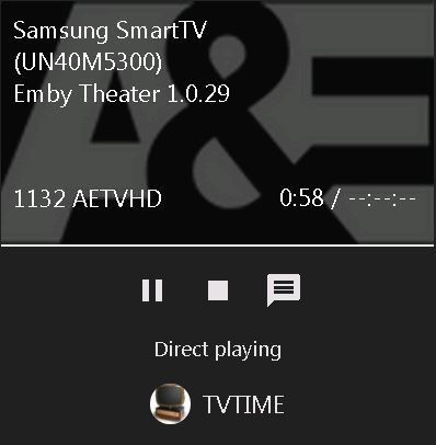

Sammy 791 Posted February 18, 2018 Posted February 18, 2018 Pushing the FFWD or RWD button just loads this at the bottom and selecting FFWD or RWD from here does nothing either. Sent from my SM-G930P using Tapatalk
Luke 42241 Posted February 18, 2018 Posted February 18, 2018 It looks like you have the pause button in focus?

Sammy 791 Posted February 18, 2018 Author Posted February 18, 2018 No matter what I do, FFWD or RWD on either the remote or selecting them in the bottom pop up, nothing happens. The Pause button was merely what was in focus when taking the picture. Using the arrow button on the remote to select FFWD or RWD doesn't work. Sent from my SM-G930P using Tapatalk
