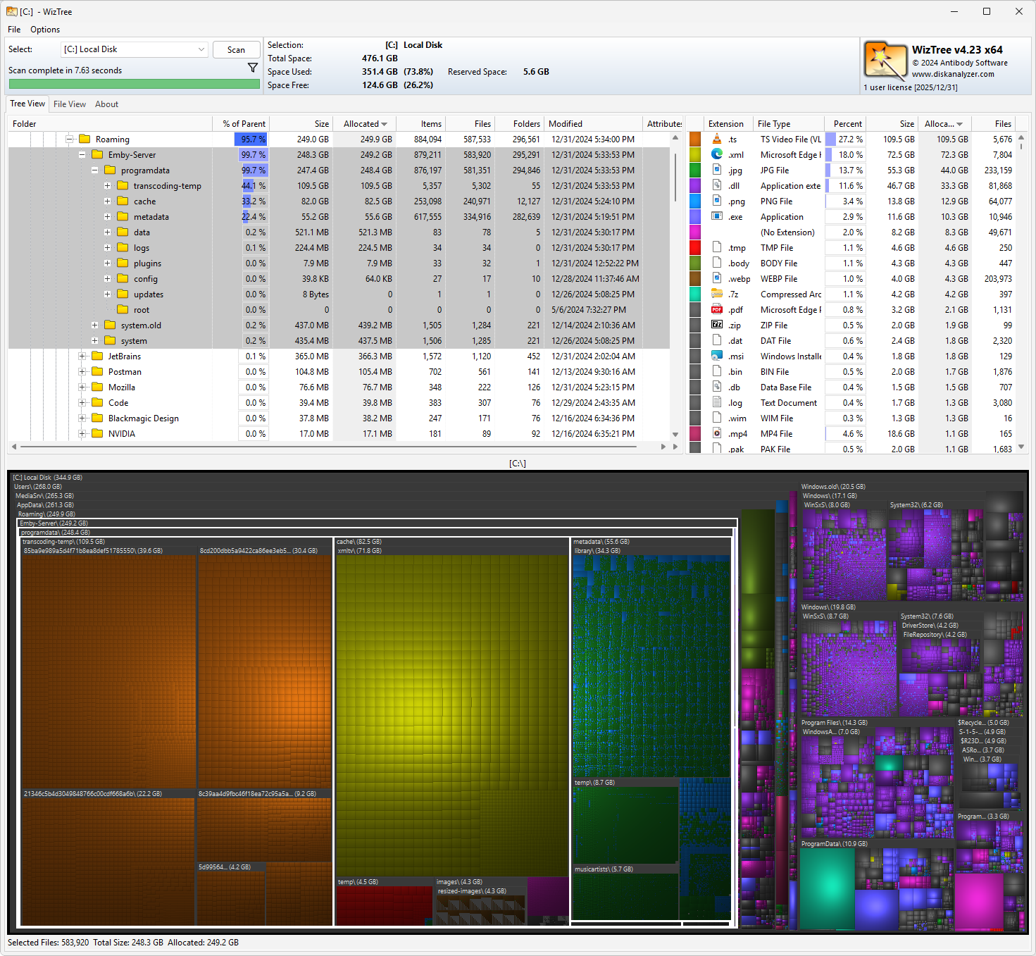

them8os235 47 Posted January 1, 2025 Posted January 1, 2025 (edited) On 2/16/2018 at 10:42 PM, Smaky said: I have read the wiki on backing up and migrating from one server to another. However, in the scenario I am pursing I want to migrate from the default Server install (via installer) to a portable one. The issue is that my SSD is running out of space and I would rather have all Server setup in a custom path where everything lives. I have already tried installing the portable server and transferring configuration (via backup plugin). That works, however I end up with a server with no media registered on it and having to rebuild the whole library and metadata would take a long time (thousands of movies, anime, and tv shows). So I was wondering if there might be some steps to transfer most of the data from the default server install into a custom path portable config without having to rebuild the whole thing. ... I tried by copying the backed up metadata folder into the new portable's metadata path. However, when Emby Server portable was started the cache, logs, and metadata folder that got created upon initial setup of the new server are now pointing the the userdata folder (as in the old installed server)... and I found no way to set these up to point tot he custom location the server resides in. On the positive, the library was retained with all info.. but it seems it is only because it is still accessing the "old" installed path. [There are numerous similar and newer threads and have read them. But rather than start yet another I chose to build on this quite old thread as it most closely aligns to me and my need.] It's really disappointing that there wasn't a follow-up by Emby staff or closely aligned providing a resolution to this. I find myself in this exact situation; so much so that I had to check the name on the OP of the thread as I thought that I could have written this. Big LOL. So as not to bury the lead: *** Anyone able to interject some more detail and guidance to what Smaky detailed about migrating or starting over on a D:\ or other drive and fully restoring the current library rather than rebuilding from scratch? Editing of config / XML files with the server off before initial startup and/or other actions are fine. *** Much thanks if so. TL;DR My Emby-Server is big ... really big: I was constantly fighting making space, uninstalling things I need, etc. Only to find the 30, 40, 60, whatever Gigs I got freed would be down to significantly less only a few hours later. I saw C:\ was down to 6Gigs and imagining a bluescreen was immanent when I got serious about figuring out where all the data was going. Enter WizTree! (Was so fast and helped so much I immediately purchased it) And was pretty shocked to discover two things: 1. Wow, Emby-Server completely dominates my C:\ drive ! 2. Space allocated to hiberfil.sys was the bigger, major culprit of where my space was disappearing to! (no longer shown above) [Quick aside: Since I upgraded my server to 128Gigs of DDR4, ran w/o a swap file, and server runs 24/7, there was absolutely no reason that the machine was configured to allow for Hibernation. And since the hibernation file is directly related to memory "in use", when I upgraded to 128Gigs I inadvertently sent the hiberfil.sys out of control. So now that I disabled Hibernation the critical emergency has passed and I see a varying 120 - 150Gigs of free space. If you are in the same boat issue this as an admin to disable hibernation: powercfg -h off ] But I need to reinstall many things I uninstalled as I fought the C:\ freespace battle, many of which can only be installed to C:\ [damn you NVIDIA, as one example]. So, I still need to get Emby-Server and all data, ESPECIALLY all data, OFF the C:\ drive; plus my system SSD isn't the most durable so I need to cut-down on the level of continued writes/rewrites/deletes to it. Edited January 1, 2025 by them8os235
Lessaj 477 Posted January 1, 2025 Posted January 1, 2025 You should configure a different location for your transcoding-temp folder, that's your biggest problem, and you probably need to clean up some old folders from it too - don't worry it's all temporary, you can delete anything under it that's older than a day safely. You can move the metadata folder and tell it the new location and run the task to scan the metadata folder just in case. You can also move the cache folder and tell it where it is, I don't think anything in this folder is critical since it's just a cache. Your library itself doesn't seem that big since your data directory is only 500 mb, not much bigger than mine. 1
them8os235 47 Posted January 1, 2025 Posted January 1, 2025 (edited) Awesome Thanks, @Lessaj I was wondering about how transient or likely to be reused some of those folders were that you named. Edited January 1, 2025 by them8os235
them8os235 47 Posted January 1, 2025 Posted January 1, 2025 (edited) 1 hour ago, Lessaj said: You can move the metadata folder and tell it the new location and run the task to scan the metadata folder just in case. You can also move the cache folder and tell it where it is, I don't think anything in this folder is critical since it's just a cache. Your library itself doesn't seem that big since your data directory is only 500 mb, not much bigger than mine. p.s. I had forgotten about all those paths that can be defined under various places and thus data moved under Server > "Library > Advanced" / Transcoding / Settings. I found btw a few reasons the cache path to be useful to keep around. So will be doing a move instead of a purge and re-creation. But don't think I have need to persist the current transcoding cache content. Eh, I may anyway. Time to do some more specific benchmarking between two M.2 NVMe drives to determine which is more suitable for the workloads. I was convinced I wanted to move the whole Emby-Server dir but thinking now what you suggest should be sufficient. Emby-Server dir of under 600 megs or even if a Gig or two is quite acceptable. Edited January 1, 2025 by them8os235 1
