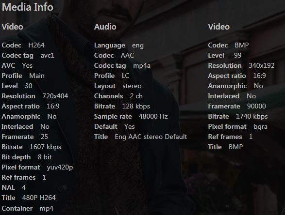

notla49285 48 Posted February 16, 2018 Posted February 16, 2018 I have an issue with streaming remotely. On certain devices (I've so far had it on my Galaxy S7 and Amazon Fire Stick), certain media attempts to play directly because there is sufficient bandwidth to handle it. However, there are often issues with this where playback is verrrrry slow and on the Fire Stick will crash Emby completely. However, when the video is being transcoded, regardless of bandwidth, the video plays no problem. Here is an example, this video file works no problem (direct streaming): This one will crash the Fire Stick when attempting to direct stream but does work when it's being transcoded: The main difference I can see between these files is that one's audio configuration is 5.1 and the other is stereo 2.0. I have had issues with sound when I used to run Plex, I'm presuming that as the file is being transcoded it is being converted to 2.0 to suit the Fire Stick and then plays no problem, however if it's direct streaming the Fire Stick is attempting to handle 5.1 and not doing a very good job? It's not my stick, I hate them personally, this being one reason. Does Emby not figure out a compatible format that the Fire Stick will play before attempting to direct stream? Does anyone have any suggestions?

mastrmind11 722 Posted February 16, 2018 Posted February 16, 2018 Thanks for this, I'll have a look at this next time I'm on it. It's not my stick, personally I hate them but that's another matter! How do I set limits per connection? Is this set on Emby Server? I couldn't find this anywhere . At the moment I have the global limit set under Playback > Streaming to 1Mbps, though my upload limit is actually around 8Mbps. dashboard > users > click a user > halfway down the page also, if you've set the global limit to 1Mbps then both of those files should be transcoding since their bitrates are both 1.6Mbps so I dunno what's up w/ that. @@Luke? 1
