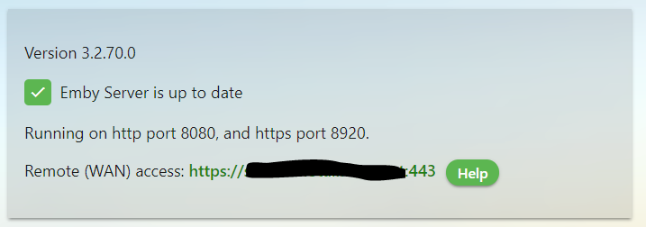

mastrmind11 722 Posted February 15, 2018 Posted February 15, 2018 As the title suggests. Had a user follow the Emby Connect instructions, and I added the new username as a Guest. User gets the email, follows instructions, finds server, but is unable to connect because the server is trying to connect via my LAN IP (this is an external user, if it's not obvious). The admin dashboard is showing the correct WAN IP. Running .70 in a container w/ host mode enabled, if that matters. The server is behind a reverse proxy, and external access to the server is working. I am able to connect via Emby Connect externally via browser and app. Thanks

mastrmind11 722 Posted February 15, 2018 Author Posted February 15, 2018 It gives them both. It is possible to use Connect on the local network too and it will use the local address in that case. But is the Guest signup process tied to Connect? If so, I don't understand how the external client would be getting the LAN IP when Connect externally works just fine. I just need a place to start digging. Since my nginx config is correct, could docker in host mode be jacking something up? As I said, the dashboard shows the correct WAN address.
