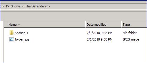

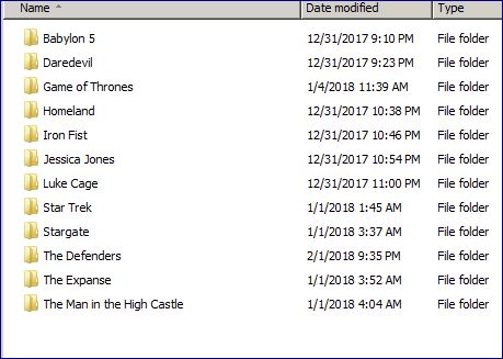

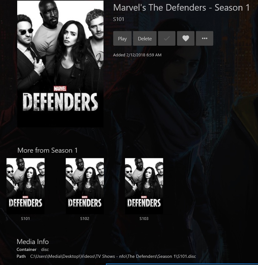

bflagg 2 Posted February 10, 2018 Author Posted February 10, 2018 (edited) Hi, have you tried running the regular library scan? Try that, and if the issue remains, then please show us screenshots of what you see in Emby as well as what the series folder on your drive looks like. Thanks. Tried scanning only the library, and whole library.... no update... Actual view from Emby... Actual view of Directory Structure Actual view of problem directory.... All files are .AVI with accompanying .jpg for folder preview.. Edited February 10, 2018 by bflagg
Luke 42205 Posted February 10, 2018 Posted February 10, 2018 can i see the contents of the season 1 folder? thanks.
PenkethBoy 2068 Posted February 11, 2018 Posted February 11, 2018 assuming there is nothing odd with the contents of the Season 1 folder on TVDB there are multiple results for "The Defenders" i suspect you mean "Marvel's The Defenders" based on the rest of the TV_Shows directory content so you could either use the identify option or rename the series folder to give emby a better idea which series you have

bflagg 2 Posted February 12, 2018 Author Posted February 12, 2018 Here is the folder info as you requested ....Nothing special, pretty standard...
Happy2Play 9802 Posted February 12, 2018 Posted February 12, 2018 That naming scheme is not support (S101) is one issue. But the Series still should appear in the library even if it is unidentified. https://github.com/MediaBrowser/Wiki/wiki/TV%20naming#episode-naming-conventions
PenkethBoy 2068 Posted February 12, 2018 Posted February 12, 2018 Thanks for the Tip, Penketh Boy. I can do, but that wouldn't stop it from reading the directory and it's entries. It would stop the metadata information following your tip. I have no qualms about doing it but don't think that the issue. i think you misunderstood - changing the directory name so emby can choose the correct series to search for - would improve the likelihood of a correct match this would have no effect on the metadata - other than give it a chance to download yes and rename your series as happy pointed out.
Happy2Play 9802 Posted February 12, 2018 Posted February 12, 2018 @@bflagg You will probably have to post a log after a library scan, as I added The Defenders using your naming and structure and the series was identified and the episodes weren't as expected.
Luke 42205 Posted February 12, 2018 Posted February 12, 2018 @@bflagg You will probably have to post a log after a library scan, as I added The Defenders using your naming and structure and the series was identified and the episodes weren't as expected. The episodes were or weren't displaying as expected?
Happy2Play 9802 Posted February 12, 2018 Posted February 12, 2018 The episodes were or weren't displaying as expected? They displayed but were unidentified.
Luke 42205 Posted February 13, 2018 Posted February 13, 2018 Ok yes that naming convention is not supported.
bflagg 2 Posted February 13, 2018 Author Posted February 13, 2018 I renamed the directory as suggested, but the scan still wouldn't pick up the folder... I'm going to force another scan and review the logs... So why does emby care about the filename? I've used it in other directories with no problem ( except for nested directories...) How would I save the filenames and be able to keep them in proper order?
Luke 42205 Posted February 13, 2018 Posted February 13, 2018 @@bflagg we care about the file name because that's how we determine the episode number of the video. If we can't determine that then you won't get any internet metadata.

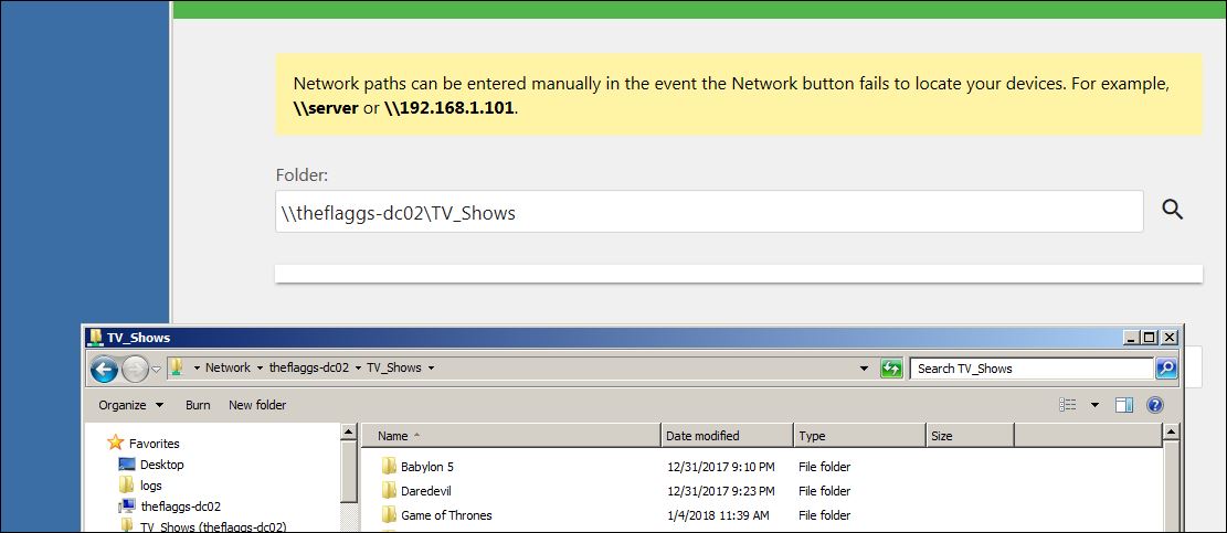

bflagg 2 Posted February 13, 2018 Author Posted February 13, 2018 Ok... so I look through the logs, and there is "Access Denied" Everywhere, to all Libraries.I can access these shares using simple windows explorer with no problem. I can read/write no problem.Emby will not access. So I delete the built libraries(all, movies, music, pictures etc...) in Emby. I try add them back and they can not see the \\server\share using the emby UI to add to library. I can still access using windows (7 x64 ) just fine.I can access using IP\share and NetBIOS\Share and FQDN\Share (all internal of course). But with Emby...nope. So this is sudden. Ideas?
bflagg 2 Posted February 13, 2018 Author Posted February 13, 2018 (edited) Example: Windows can see... Emby cannot. (it used to, hence the original library build. Nothing changed but Emby) I am at a total loss what to do next. If I click on OK in emby.. "Path cannot be found" error. (same error if using IP or FDQN) Edited February 13, 2018 by bflagg

bflagg 2 Posted February 15, 2018 Author Posted February 15, 2018 Now..for some reason, I can see the other computers on my network with EMBY browse, but as soon as I select a shared folder, the field goes blank and will not retain on what I selectie...\\Server-dc02 DVD and can not drill down to Movies in the DVD Folder. (\\server\share\folder) Nor will is save when I select just use DVD. Or TV_Shows, Music, Pictures, Videos . Nothing.Even if I type the paths.. I get "path not found" error. Can I download earlier version of media browser server? To be honest, as you can tell from my original screen shots, this use to work, and nothing changed on my home network.But it's one of those, you set and forget about it, and wasn't aware of the library not updating for some time. The last I actually looked at this and set the libraries was back in December. I installed firefox incase it was a browser issue, but that made no difference.
Luke 42205 Posted February 15, 2018 Posted February 15, 2018 Now..for some reason, I can see the other computers on my network with EMBY browse, but as soon as I select a shared folder, the field goes blank and will not retain on what I select ie... \\Server-dc02 DVD and can not drill down to Movies in the DVD Folder. (\\server\share\folder) Nor will is save when I select just use DVD. Or TV_Shows, Music, Pictures, Videos . Nothing. Even if I type the paths.. I get "path not found" error. Can I download earlier version of media browser server? To be honest, as you can tell from my original screen shots, this use to work, and nothing changed on my home network. But it's one of those, you set and forget about it, and wasn't aware of the library not updating for some time. The last I actually looked at this and set the libraries was back in December. I installed firefox incase it was a browser issue, but that made no difference. Probably because although it can see the share, it doesn't have access to it, so it's being denied when you try to browse into it. Please let us know if this helps. @@bflagg if you attach the emby server log from the time you attempted this then i can verify that for you.
