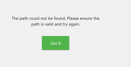

TeleFragger 3 Posted February 8, 2018 Posted February 8, 2018 Ok new user here and testing this out in my testlab environment. It is ESXI 6 and on win10. all is good except when I go to load the library. It asks for where.. but if I choose \\name also tried \\ipaddress it doesn't find it, if I choose Z: (which I mapped) it doesn't find it. I know you most likely want logs.. where are they? like said I'm NEEEEEWWW!!! hah.. appreciate the help..

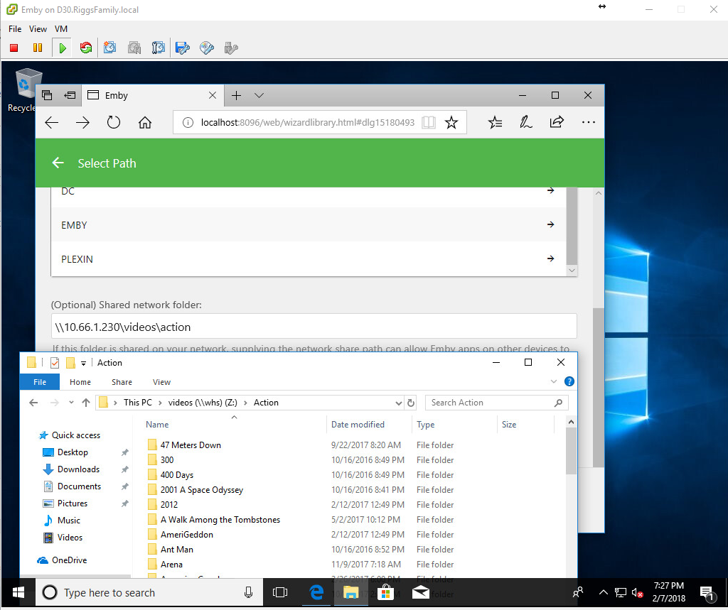

TeleFragger 3 Posted February 8, 2018 Author Posted February 8, 2018 So I am sorry I'm not following.. I placed Z:\Action into folder .. didn't gave an error that it cant find that location so I tried network and same..

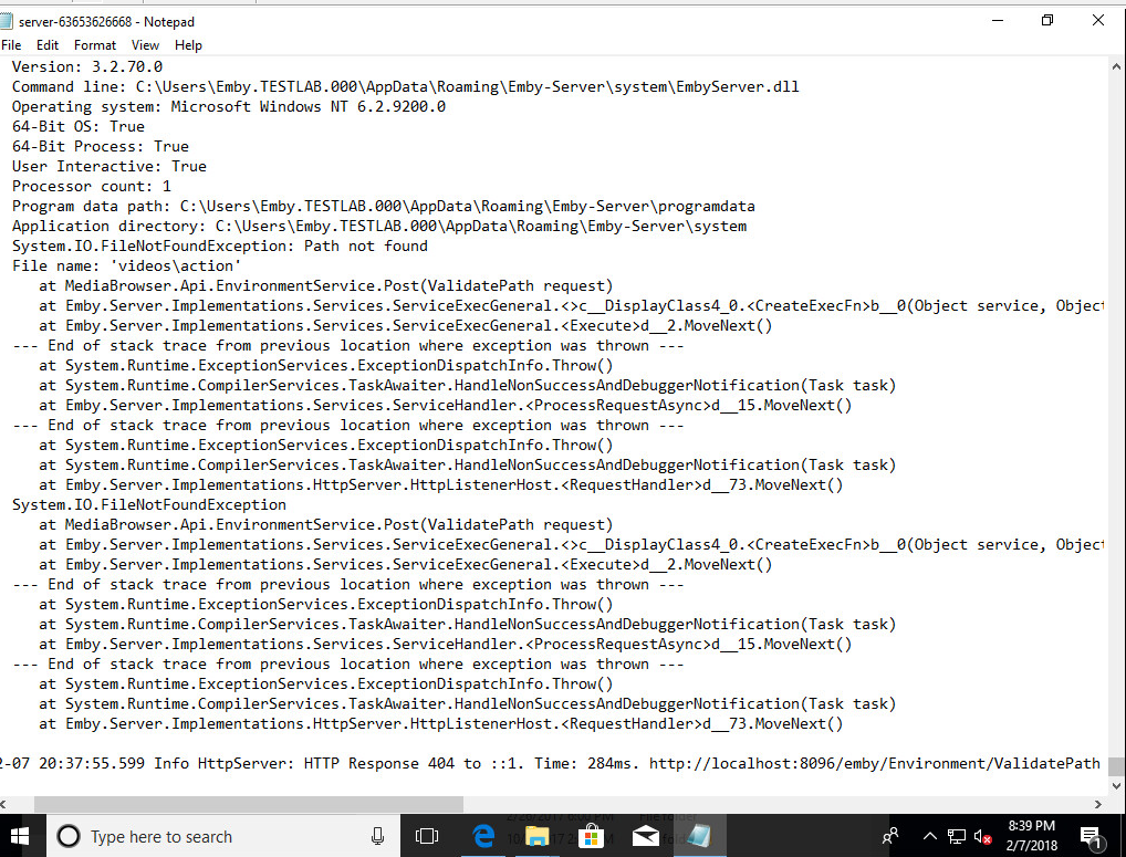

kanipek 230 Posted February 8, 2018 Posted February 8, 2018 (edited) Where is the Emby server located in relation to the library you are trying to access? Same machine? Things I would check are folder sharing, share permissions. SMB installed on the WHS? Verify the paths. Also Emby will sometimes have an issue finding the folders unless you do a paste as @@dansblackcat mentioned above. Other than that yeah logs --> C:\Users\xxxx\AppData\Roaming\Emby-Server\programdata\logs Also best to use the folder path for "folder;" and use the IP path in the "optional shared folder:" Edited February 8, 2018 by kanipek

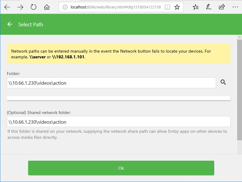

TeleFragger 3 Posted February 8, 2018 Author Posted February 8, 2018 Where is the Emby server located in relation to the library you are trying to access? Same machine? Things I would check are folder sharing, share permissions. SMB installed on the WHS? Verify the paths. Also Emby will sometimes have an issue finding the folders unless you do a paste as @@dansblackcat mentioned above. Other than that yeah logs --> C:\Users\xxxx\AppData\Roaming\Emby-Server\programdata\logs Also best to use the folder path for "folder;" and use the IP path in the "optional shared folder:" so Emby is on a VM in a test lab environment that is fully working ... and share is on other network. so basically 10.66.10.0 (255.255.0.0) is where WHS is and emby is on 10.10.0.0 (255.255.0.0) ill check logs... I also run a plex server and just set it up right now in the test lab as well... and it had no issues finding the folders .. not comparing at all.. just not sure how different emby is as I have hd homerun prime and hd homerun connect quatro I want to connec to emby to test.. cant stand the plex tv layout. so use folder path in folder.. so my share is \\whs\videos\Action ... so with that put... \videos\action and ip in optional? trying now
kanipek 230 Posted February 8, 2018 Posted February 8, 2018 (edited) so Emby is on a VM in a test lab environment that is fully working ... and share is on other network. so basically 10.66.10.0 (255.255.0.0) is where WHS is and emby is on 10.10.0.0 (255.255.0.0) ill check logs... I also run a plex server and just set it up right now in the test lab as well... and it had no issues finding the folders .. not comparing at all.. just not sure how different emby is as I have hd homerun prime and hd homerun connect quatro I want to connec to emby to test.. cant stand the plex tv layout. so use folder path in folder.. so my share is \\whs\videos\Action ... so with that put... \videos\action and ip in optional? trying now In your case I would use the IP path in both folder and optional folder Also check the user permissions on the shared folder(s) you will need modify level access I believe. So win 10 VM and WHS ? Edited February 8, 2018 by kanipek

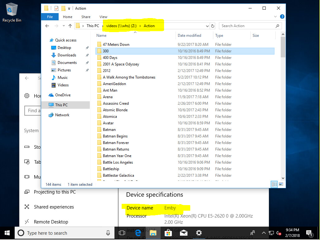

kanipek 230 Posted February 8, 2018 Posted February 8, 2018 (edited) still no go... Can these two machines see each other? Like a shared folder through windows explorer? (both directions win 10<-->WHS) Edited February 8, 2018 by kanipek
TeleFragger 3 Posted February 8, 2018 Author Posted February 8, 2018 very first screenshot shows explorer window up with Z: so yes... that is what is confusing...

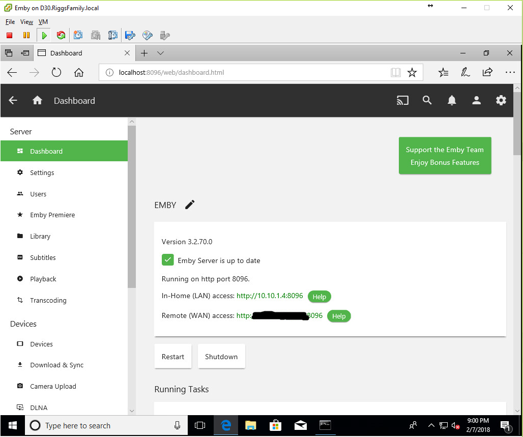

kanipek 230 Posted February 8, 2018 Posted February 8, 2018 show me the dashboard : http://localhost:8096/web/dashboard.html
TeleFragger 3 Posted February 8, 2018 Author Posted February 8, 2018 (edited) show me the dashboard : http://localhost:8096/web/dashboard.html Edited February 8, 2018 by TeleFragger

Happy2Play 9802 Posted February 8, 2018 Posted February 8, 2018 @@TeleFragger you may want to edit the image you posted as it containers your WAN Address. 1
kanipek 230 Posted February 8, 2018 Posted February 8, 2018 So you can see shares from Win 10 on the WHS? I see it from win 10 to WHS in the SS. Windows 10 IP is 10.1.1.4 WHS? 10.66.1.230 or 10.66.10.230? 1
TeleFragger 3 Posted February 8, 2018 Author Posted February 8, 2018 @@TeleFragger you may want to edit the image you posted as it containers your WAN Address. done... thx didn't think of that.. not that I care too much.. but a hacker will hack I guess LOL
TeleFragger 3 Posted February 8, 2018 Author Posted February 8, 2018 So you can see shares from Win 10 on the WHS? I see it from win 10 to WHS in the SS. Windows 10 IP is 10.1.1.4 WHS? 10.66.1.230 or 10.66.10.230? no... I cant.. I can see it 1 way.. not the other... possibly my issue?
kanipek 230 Posted February 8, 2018 Posted February 8, 2018 no... I cant.. I can see it 1 way.. not the other... possibly my issue? Probably related. But I see you adding 10.66.1.230 is that correct ? Also see you saying WHS is 10.66.10.xxx ?
TeleFragger 3 Posted February 8, 2018 Author Posted February 8, 2018 Probably related. But I see you adding 10.66.1.230 is that correct ? Also see you saying WHS is 10.66.10.xxx ? so Windows 10 machine - hostname Emby - IP 10.10.1.4 Windows Server 2016 file share - Hostname WHS - IP 10.66.1.230 in above pics.. I do have a drive mapped.. from "Emby" to \\whs\videos Tried adding Z:\action, tried adding \\10.66.1.230\videos\action and neither come back as seen... but on Emby I can map drives and in explorer see that "whs (or 10.66.1.230)" shares...
