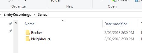

vaise 340 Posted February 2, 2018 Author Posted February 2, 2018 (edited) Update - so I waited for those two shows to complete (becker and neibours). Neighbours recording cant play (in anything, inc VLC media player) and becker seems almost corrupted - but that may be the channel it was no. These are test recordings, nothing I actually want to watch. Final thing to report - it does not seem to have 'let go' of the tuners - its a long time since the shows ended. Emby console shows they as still recording, the LiveTV tab shows the two tuners are 'Watching', but there is nothing recording at all. A restart of emby server did not free up these tuners ? I actually had to power off and on the HDHR devices - something I have never done before. Edited February 2, 2018 by vaise

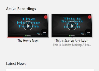

vaise 340 Posted February 3, 2018 Author Posted February 3, 2018 Im going back to basics here - there was a new emby beta overnight, installed that. Removed all bar one HDHR device. Scheduled two shows from the same channel set to start at 11:30 - they should use just one tuner (as the same stream) - as per nextPVR. Waited for 11:30. Noticed the two recordings fire, can see them in emby console. Unfortunately, it is using two tuners on the HDHR, not one like nextPVR would - as they are the same stream (photo below) This on its own is enough for me to not progress with this as sometimes we have a load of recordings at once happening, with follow on's on different channels and due to overuns, we need lots of available tuners. For example, on nextPVR, if I am recording channel 10 8pm till 9pm, then I have another recording on channel 10 from 9PM till 10PM, it will still record the extra 15 mins padding on the first show, and start a new one for the second show, but no new tuners would be required. If that second is Channe 11 (on the same stream) then it will still use the single tuner. Another example, we have ABC1, ABC2 and ABC3 channles, all on the same stream. NextPVR will use just 1 tuners to record all three at the same time. It seems like emby will not - and would in this case (as shown below) use 2 tuners, and not be able to record the third (I will be doing this test next now i have throttles emby to the one HDHR with 2 tuners in it). : log attached if this helps. server-63653253250.txt

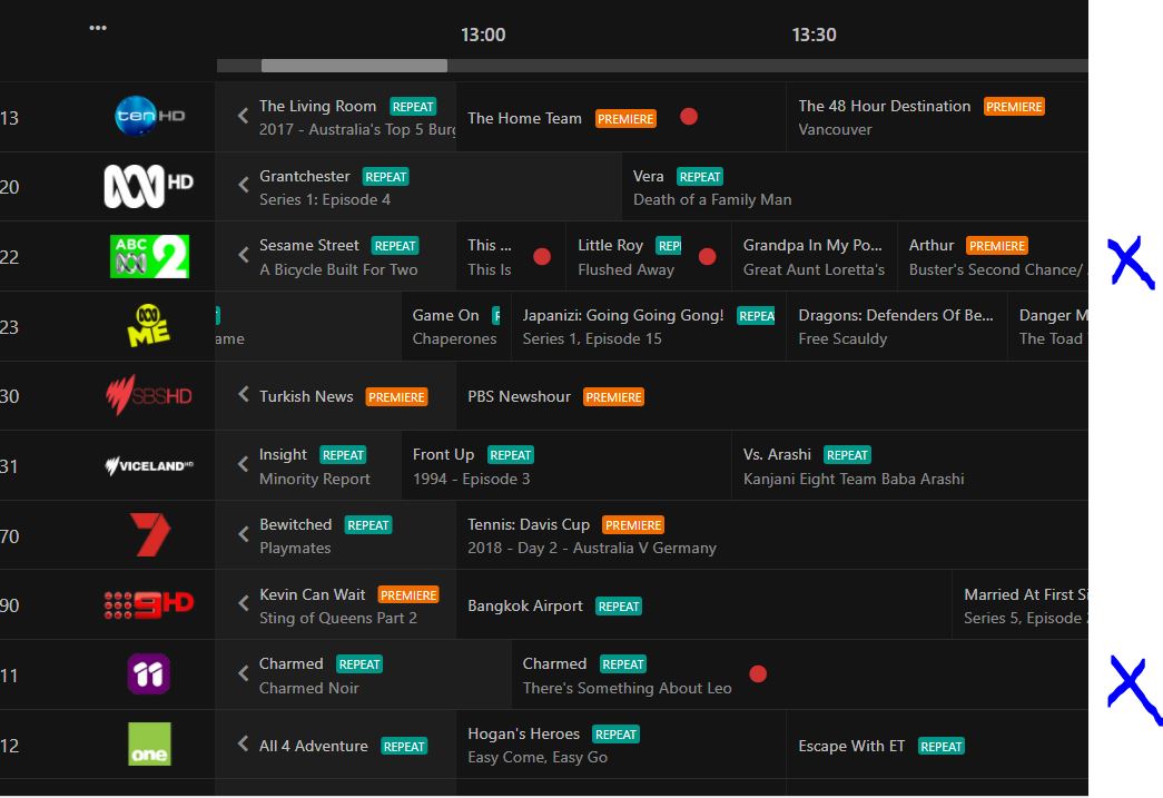

vaise 340 Posted February 3, 2018 Author Posted February 3, 2018 So, for my next test, I have the following guide recordings set (note - restarted Emby at 12:48 for clean logs) - you can see the screenshot below at the end of this post : Channel 10 - 13:00 Channel 11 - 13:05 Note - Both 10 and 11 are from the same TV network stream - so should use the same single tuner (like nextPVR does) Channel 2 - 13:00, then channel 2 at 13:10 Note - with the 15min padding, the show ending at 13:10 should continue, and the one staring at 13:10 on the same channle should not use a new tuner (same stream) In the above situation, NextPVR would use just 2 tuners and have 4 recordings to watch. Two starting at 13:00, 2 starting at 13:10, and even tough there is an overlap due to padding, a new file will fire keeping the previous padding from the one before). With the two tuners I have throttled Emby to use, we get these unacceptable results however : At 13:00, channel 10 and ABC2 fire off on both tuners - Correct At 13:05, channel 11 should have fired, and as it uses same stream as channel 10, should have used the same tuner that was in use for Channel 10 - it did not fire. At 13:10, On same ABC2 channel, should start the next recording on the same tuner, while post padding the 15 minutes on the one before it. Nothing happened. Added screenshot below of the same two first shows at 13:00 recording only taken at 13:13. I think this concludes my testing of the Emby LiveTV native recording with my HDHR Dual devices. Unless anyone has anything I can do to fix these issues ? I will leave this one HDHR attached to Emby, and leave the nextPVR plugin off for now, and just use the recorded TV folder view over the nextPVR stuff - in the hope that someone can fault find this issue. Not much point adding the other tuners in until this same stream recording can be resolved. Logs of this testing scenario attached. Thanks. server-63653258921.txt
